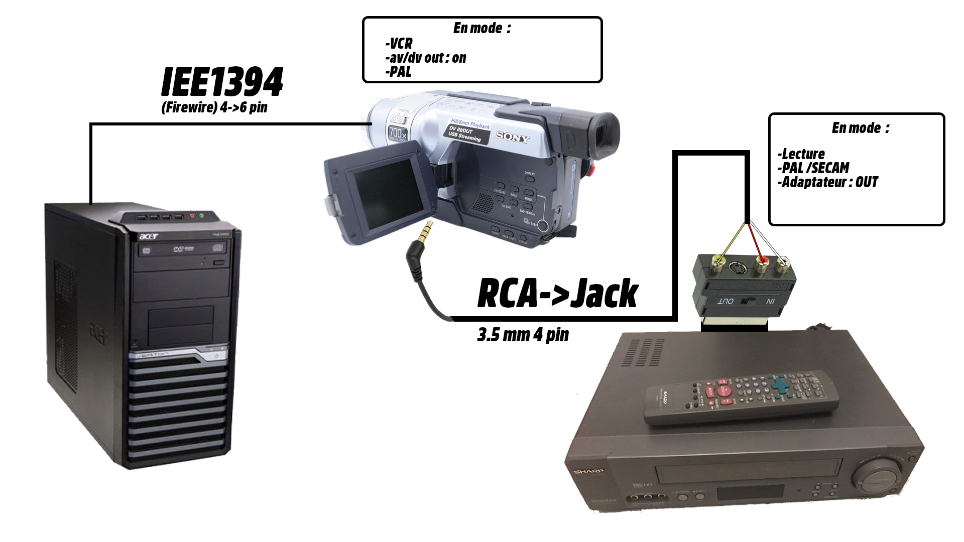

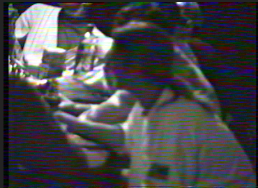

    I want to digitize VHS tapes with a camcorder. Everything works sound and image, but the image is deteriorated compared to the simple reading on the tape. There are artifacts and the image is in black and white noise.
    Material:
    Sony DCR-TRV345E
    Sharp VC-MH68FPM
    Here is the quality of the image captured on Premiere pro (same material used):
    [Attachment 68359 - Click to enlarge]
    [Attachment 68360 - Click to enlarge]
    [Attachment 68361 - Click to enlarge]

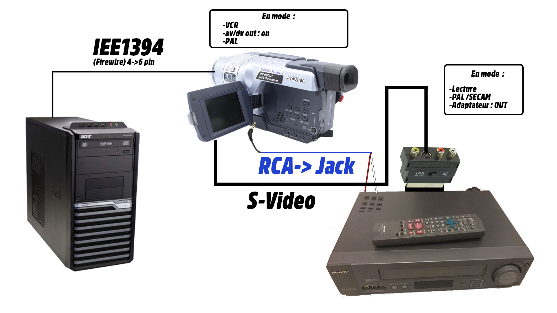

    In both cases the image is buggy, even if for the capture via S-Video the image is slightly better.
    However, when playing another tape with connection number 1. Everything works, why?

  2. By retrying the acquisition on the non-functional VHS
    I changed the CLR format in the VCR menu. Switching from AUTO to SECAM to PAL.
    Indeed, in SECAM it affects the quality, the image is less blurred but still in black and white.
    It seems that my camcorder can not decode the SECAM format correctly.
  3. Are there any VCRs that can read SECAM and PAL VHS and convert this output signal to PAL?

    If the VCR is PAL and the OP has SECAM tapes that explains the weird colored noise, But usually when a member posts little to no information it is going to be all speculations.
  13. Thank you all for your answers!
    My VCR is able to read PAL and SECAM except that I can't force the output signal be in the format I want.
    That's why my camcorder can't decode the signal and the video is so bad. I also just learned that most camcorders can only read in PAL format.
    I just need to add a SECAM to PAL converter to my setup. I know some VCRs can do this, but it's too expensive for me.
    Apparently the cheapest solution would be to use a DVD player with RCA input able to convert SECAM to PAL at the RCA output.
  14. Capturing Memories dellsam34's Avatar
    Jan 2016
    You don't need to convert, you need a SECAM capture device, Most if not all USB/PCIe capture devices capture native SECAM video to computer, Then use Vdub to capture the video not Premiere.
  15. I use the camcorder as a "pass through" so we have to impose a PAL for the digitalization. My card is PCI firewire.
  16. Capturing Memories dellsam34's Avatar
    Jan 2016
    You don't have to pass through, Converting SECAM to PAL is a complicated process and incur a huge loss of chroma quality which is weak to begin with, not to mention that the resulting DV files have to be then encoded to another lossy format for playback. Just capture SECAM using USB or PCIe capture card to lossless AVI then de-interlace and encode if you need smaller size files.
    If you insist to go with your messy process keep the tapes when you decide later to do them the right way.
