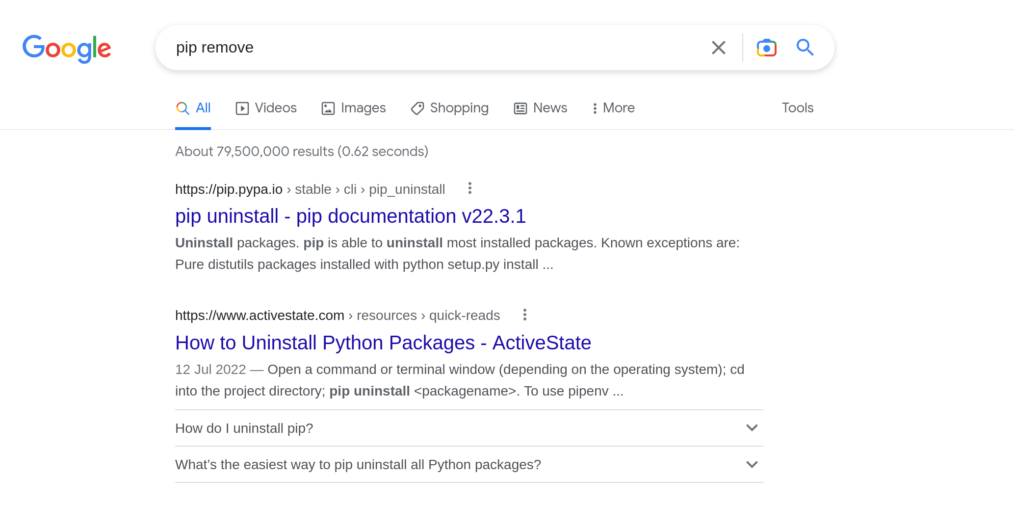

    Originally Posted by staszek1503 View Post
    ..snip... pip remove ...snip
    ERROR: unknown command "remove"
    You are. I have no doubt, a grown-up person of at least average intelligence, for you to even be here. But you appear unable to use Google and needed to wait to be given an answer to an easily surmountable problem..
    Explain why, if you would be so kind. I just don't understand the process that reduces thinking adults to incompetance. I'm not getting at you in particular, I'm just trying to understand why it is happening so much in this forum.
    [Attachment 68659 - Click to enlarge]

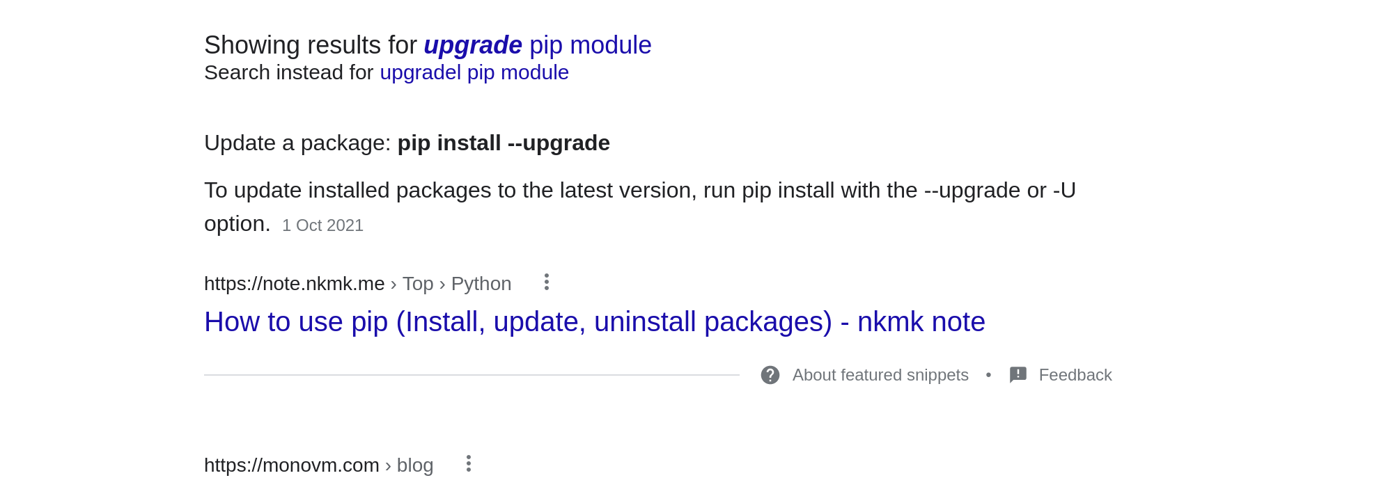

    And now you are asking about upgrade - no thought of self-help. Really sad.
    [Attachment 68660 - Click to enlarge]
    And
    [Attachment 68661 - Click to enlarge]
    from the OP.

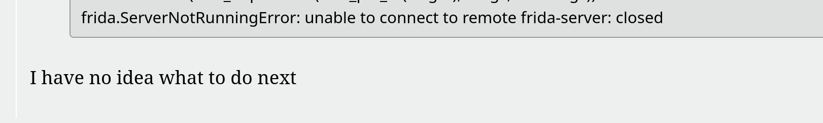

    frida.ServerNotRunningError: unable to connect to remote frida-server: closed
    I have no idea what to do next

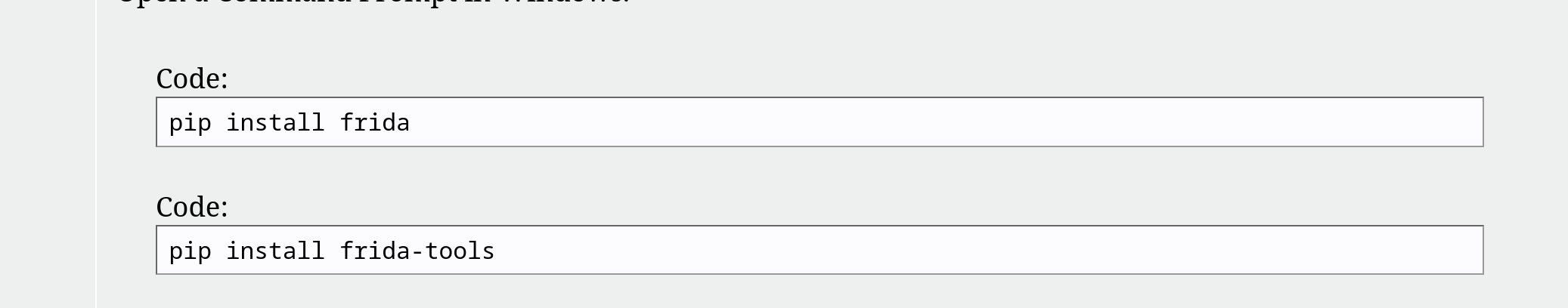

  6. So you don't have read the tutorial....
    You have upload Frida-server 16.0.8 in your virtual device and, as I can see, you have Frida 15.2.2 on your computer.
    I have tell you that you must have THE SAME VERSION on your device and your computer...
    And Moreover, you don't have Frida-tools on your computer.
    "pip install frida-tool" doesn't work....mmmhhh why?... because it's "pip install frida-tools" and don't try to upgrade something that is not installed!!
    So I tell you like I ask for my son :
    Learn carefully your lesson and after you could do your exercise...

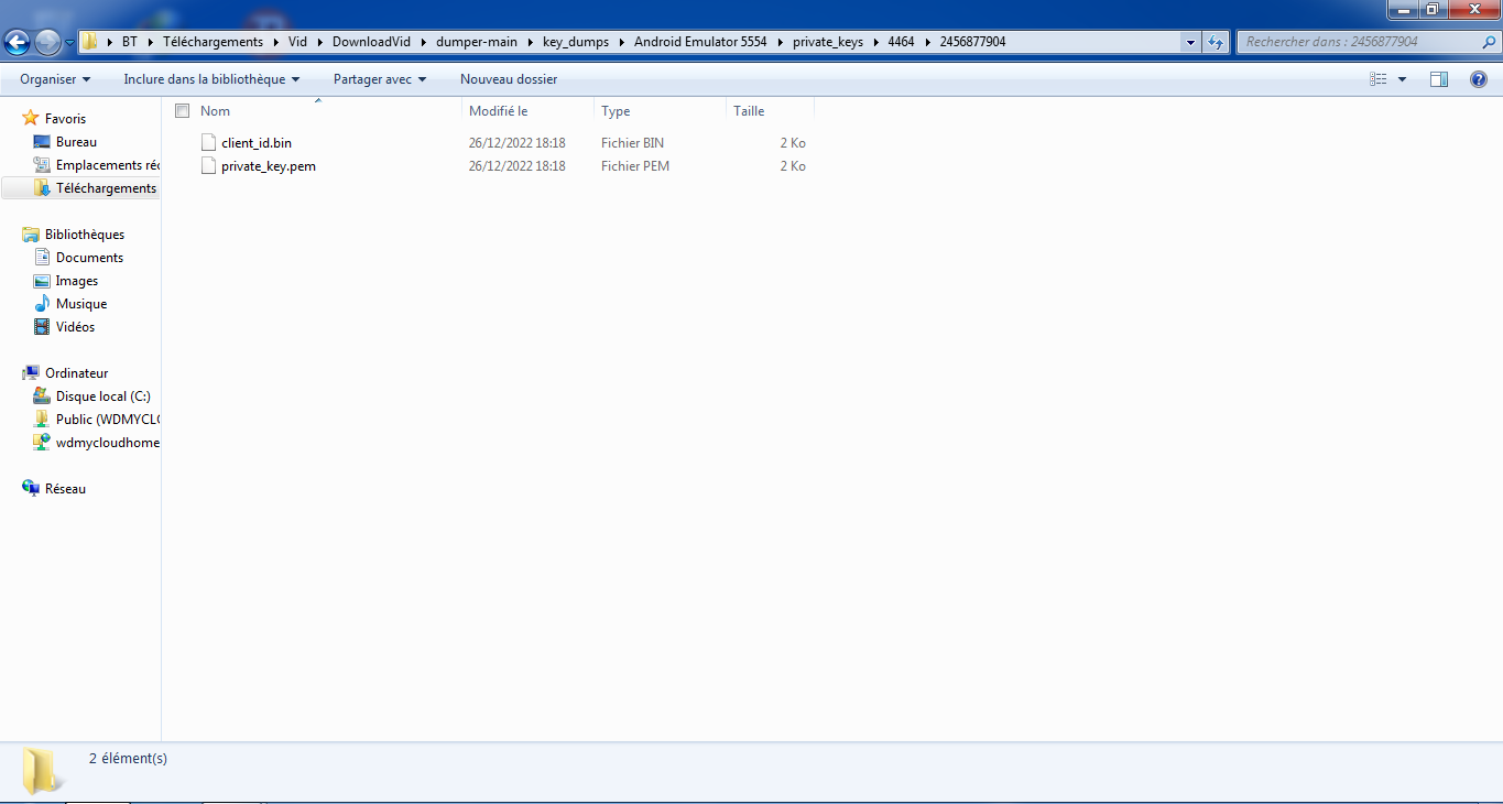

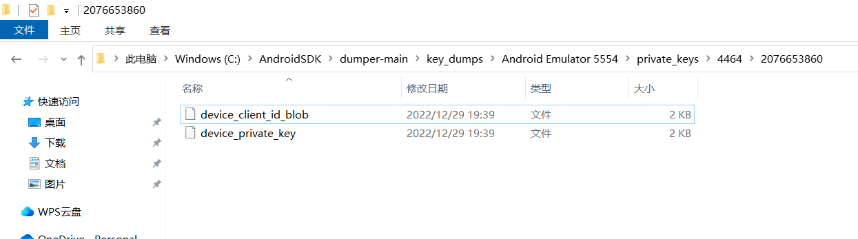

  8. Originally Posted by cedric8528 View Post
    Let's have a look in dumper-main directory.
    You will find a directory (private-keys) containing the 2 files
    [Attachment 68358 - Click to enlarge]
    you just have to rename the 2 files respectively in :
    device_client_id_blob
    device_private_key

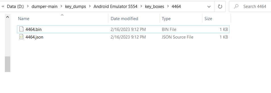

    after i follow the steps i only get 2 json and bin files
    [Attachment 69252 - Click to enlarge]
  21. So you don't dump anything....
    Check that your version of Frida on your virtual phone and on your computer are the same.
    Try again
