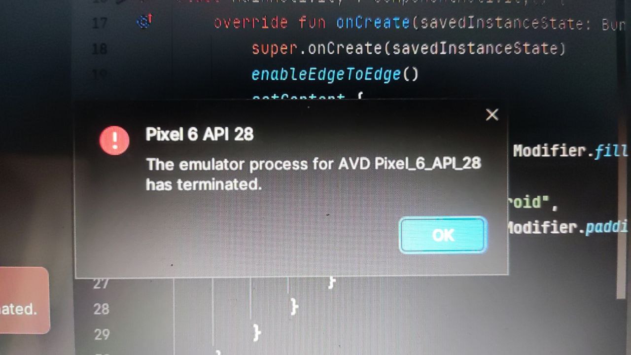

  3. Android studio gives an error when I start a virtual deviice (the emulator process for AVD pixel 6 has terminated). Anyone willing to grab a cdm from a avd for me?
  4. Originally Posted by crippled View Post
    https://forum.videohelp.com/threads/413719-Ready-to-use-CDMs-available-here%21
  5. Originally Posted by imr_saleh View Post
    thanks, I wrongly assumed they were revoked, some are, hellyes did the job for me.

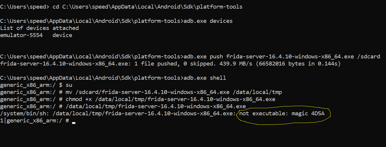

  6. Can someone help me? I don't know what I'm doing wrong... what does this "magic 4D5A" error mean?

    @sentinel i don't know, but i think you didn't take the right frida-server file...Try the android version ?

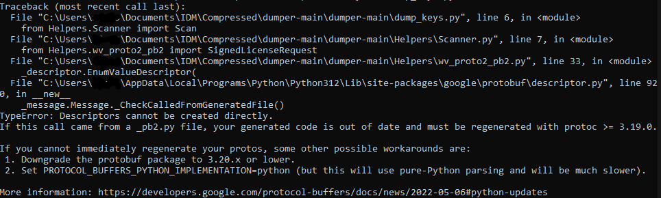

  8. The problem im having, after getting everything setup and working is apparently some out of date code.Image
    [Attachment 82528 - Click to enlarge]
    anyone can help?

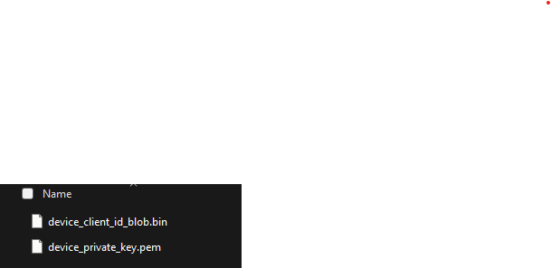

  9. Hi
    thanks for this post.
    i need help...
    i try do like this guide and i get this files
    [Attachment 82793 - Click to enlarge]
    but now, what i need to do?
    thanks again and sorry if its the wrong place ..
  10. Originally Posted by hesses View Post
    anyone can help?
    You can do:
    pip install --force-reinstall -v "protobuf==3.20.0"
    This is just a quick workaround but works great for me
  11. Search, Learn, Download! Karoolus's Avatar
    Oct 2022
    Belgium
    Originally Posted by ziv View Post
    Hi
    i need help...
    That's it, you dumped a CDM. Now read the other stickies to figure out how to use those files to obtain keys to videos you want to download.

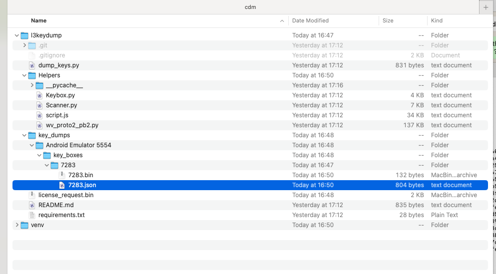

  21. Ok i have solved the prior post by going back to alot earlier version of android - Android 9 (Google APIs) but will leave post here to help other people !
    Though the dump looks sucessful from the logs there is no .pem file, i got a bin ( or two if you count that request file ) and a json any ideas
    [Attachment 84104 - Click to enlarge]
    EDIT: Doing my own debug today this solves this issue for users os Mac Sonoma, simple one line to replace in the dumper script.
    https://github.com/wvdumper/dumper/issues/31

    Put the Frida-server file we have downloaded In our virtual phone
    adb.exe push frida-server-16.0.2-android-x86 /sdcard
    [Attachment 68352 - Click to enlarge]
    So let's communicate with our Virtual device
    Put the Frida server in the good directory of our device
    Give permission to execute the file
    Execute frida-server!
    adb.exe shell
    su
    mv /sdcard/frida-server_yourversion /data/local/tmp
    chmod  +x /data/local/tmp/frida-server-yourversion
    /data/local/tmp/frida-server-16.0.2-android-x86

    You will find a directory (private-keys) containing the 2 files
    [Attachment 68358 - Click to enlarge]
    you just have to rename the 2 files respectively in :
    device_client_id_blob
    device_private_key

  30. Image
    [Attachment 84781 - Click to enlarge]
    I'm wondering if anyone can help me with this. Getting this error early in the steps.
