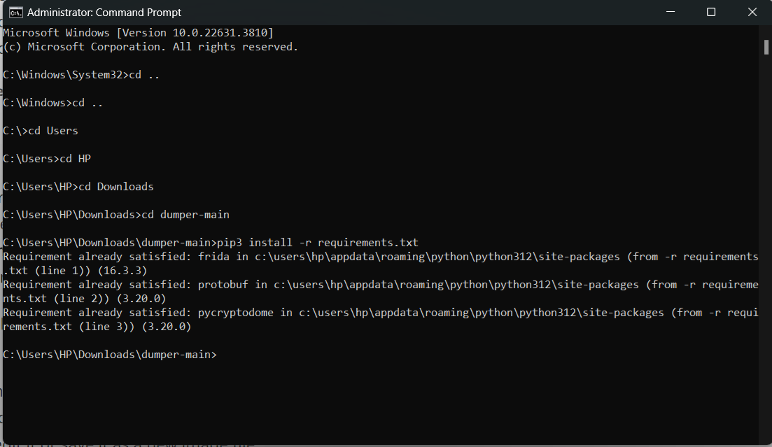

    Thanks for the Reply:
    My frida version is 16.3.3 Image
    [Attachment 80194 - Click to enlarge]
    [Attachment 80195 - Click to enlarge]

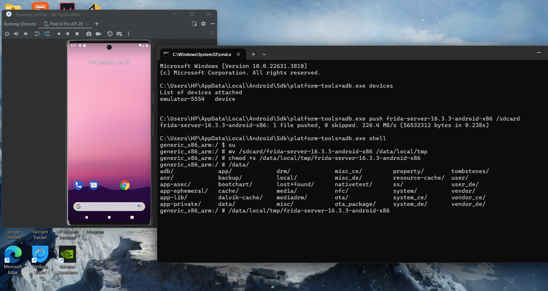

    As far as i know its x86 version of Frida server that i need to download right ?? Image
    [Attachment 80196 - Click to enlarge]
    this is the one i downloaded
    Still the case remains the same ... on playing the drm video my dumper terminal has no response !!
    So do i nee to implement the x86_64 arch ??
    Also i dont have a clue about keydive can u suggest a sticky thread / forum thread using keydive for CDM

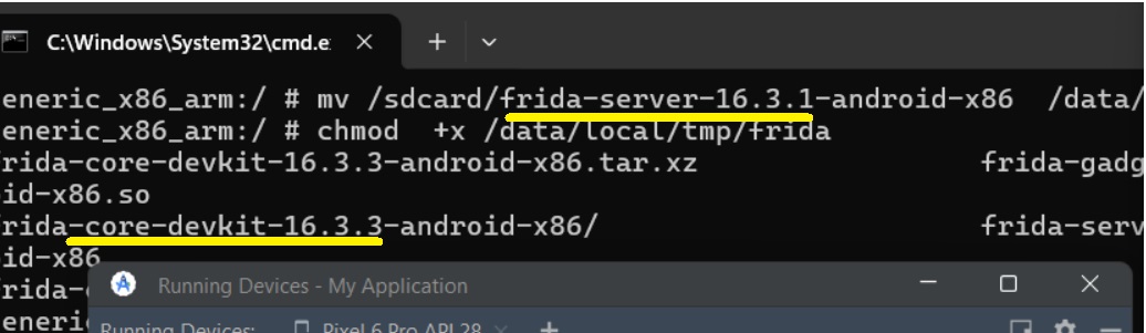

    You installed v16.3.3 but you pushed frida 16.3.1
    [Attachment 80212 - Click to enlarge]
    uninstall that and run pip install frida~=16.3.3

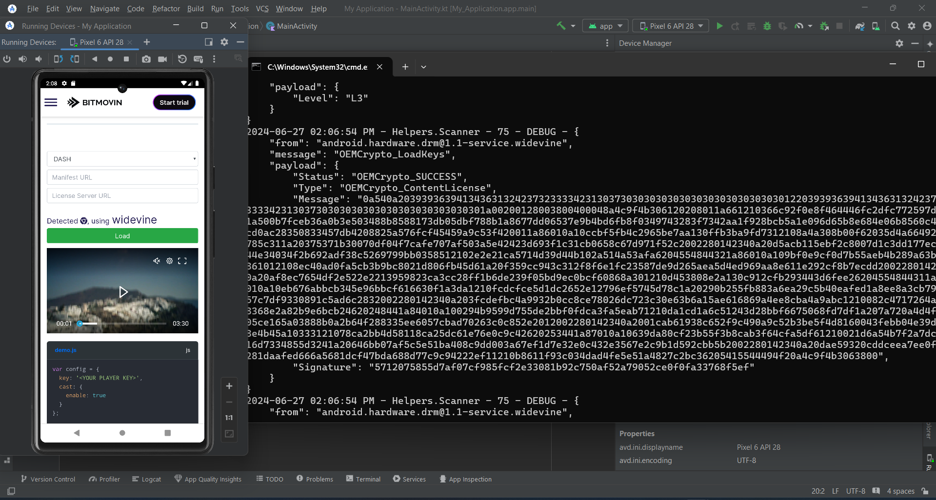

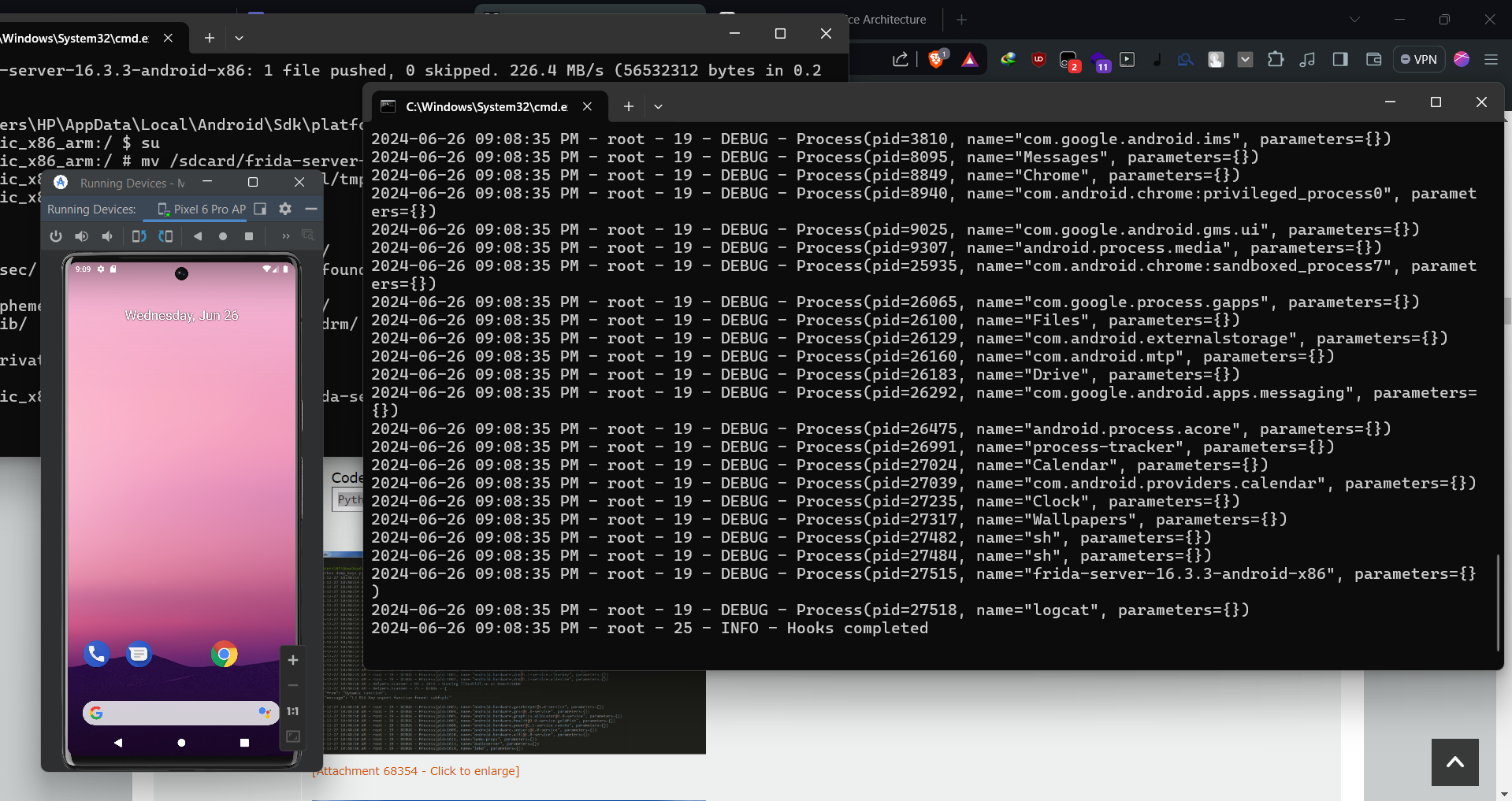

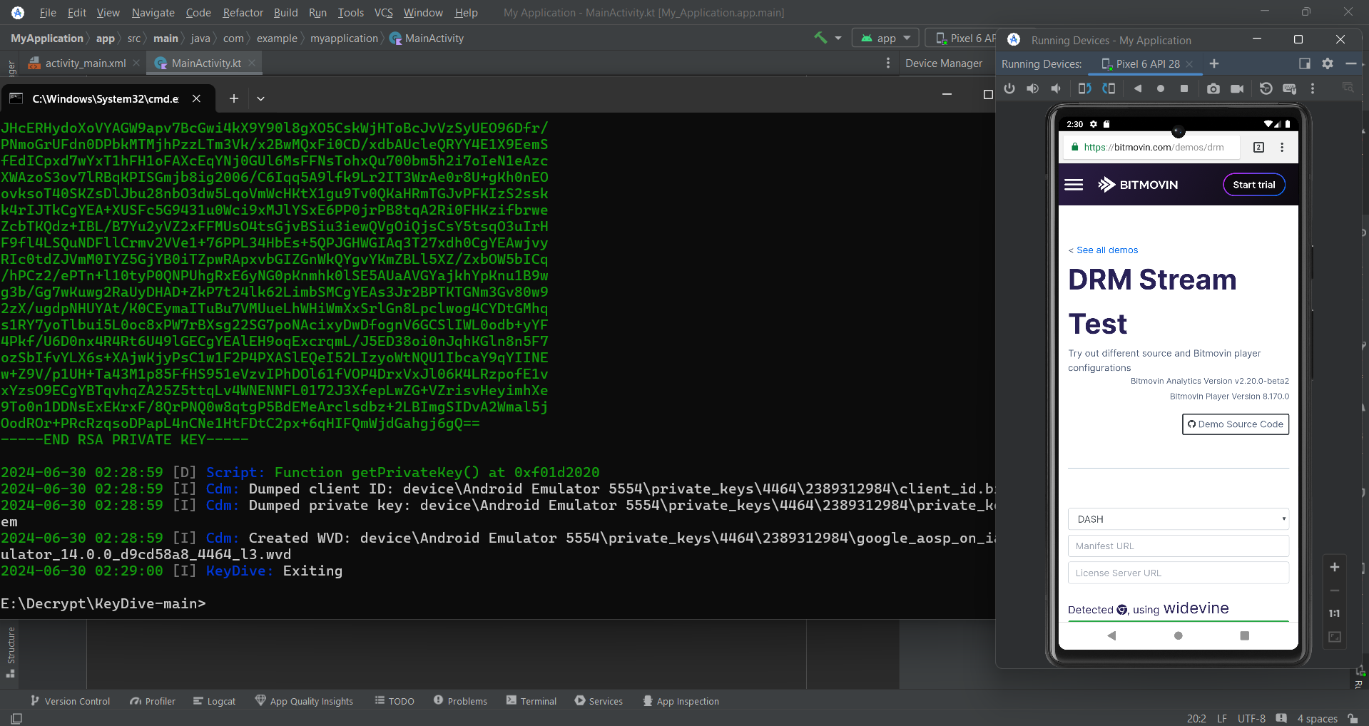

    Thanks for the Explanation with the keydive but currently i am trying to work with the as described in the guide ...
    I corrected the Frida Version 16.3.3 and then ran the virtual android ... all work good but when i open a drm site given to test in explanation ... the dumper dosent work the same way the issue remains the same ! lemme show u... Image
    [Attachment 80215 - Click to enlarge]
    [Attachment 80216 - Click to enlarge]
    [Attachment 80217 - Click to enlarge]
    Niether can i find a private_key folder in Dumper...Image
    [Attachment 80219 - Click to enlarge]
    Any one with fixes on waht the issue is and how to make it to the other side ??

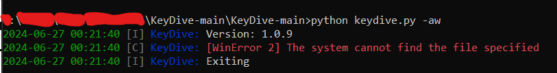

    Originally Posted by white_snake View Post
    Originally Posted by polkzhyzia View Post
    I can see that, but that's an error from dump_keys.py, not from KeyDive. I'll say it for the third and last time: try to dump the CDM with KeyDive and see what happens.
    i have this error.
    [Attachment 80220 - Click to enlarge]
  4. Originally Posted by polkzhyzia View Post
    Try without the -aw switch.
    same error .
    [Attachment 80232 - Click to enlarge]

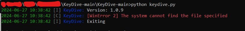

  6. Make sure you have adb.exe in the same folder as the KeyDive script you are running or put the platform-tools folder into your PATH.

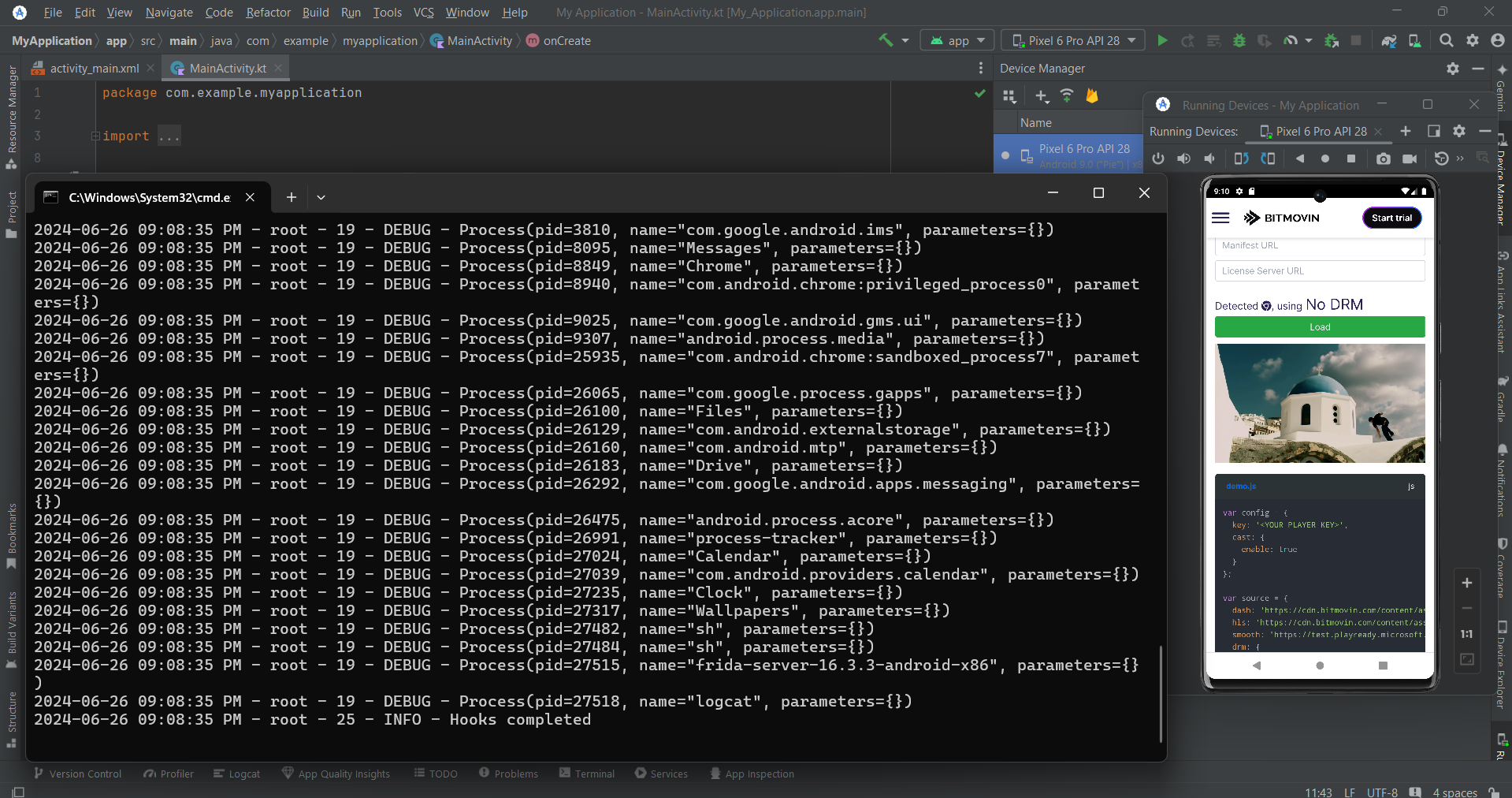

    Anyone with some help ... on what's wrong here on using frida ?? OR i have to use keydive only ?? please if anyone can help
  8. Anyone with some help ... on what's wrong here on using frida ?? OR i have to use keydive only ?? please if anyone can help
    As you can see on the bitmovin page, it says "Detected Chrome using NO DRM", that should say Widevine.. try deleting this AVD and creating old one from scratch.
    Also, as stated before, make sure to triple check that you are using the correct version, use KeyDive for the dumping process with -aw switch, that way the bitmovin page will open by itself and you will end up with WVD file that you can use later.
  9. Originally Posted by Blacksiren View Post
    So i should create a new Virtual Android ?? maybe Pixel 6 the rooted one !! right ??
    ya i am using the current version its just that i am not using keydive ... wanna make sure the tutorial thing works fine first then i can try other things
  10. So i should create a new Virtual Android ?? maybe Pixel 6 the rooted one !! right ??
    Yeah, I'm more than sure that there is a proper fix to make the bitmovin page show the correct thing but creating new AVD will be far easier.
    Just follow the sticky thread post #1 and follow the same steps in those screenshots, same version everything, check if you have correct API and so on.
    I recommend using KeyDive, so definitely use that one.

    It worked how dumb can i be to not give chrome permissions and then cry about it not working !! LOl
    Thanks for the help to everyone that replied ...

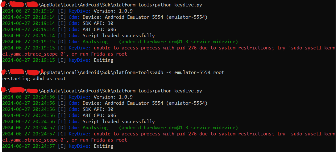

    i already run it in root, but i have this error
    [Attachment 80241 - Click to enlarge]
  14. Originally Posted by polkzhyzia View Post
    Are you sure that you run Frida as root? Also, try what it says "sudo sysctl kernel.yama.ptrace_scope=0" -- you have to run it in adb shell ofcourse.. Alternatively try rebooting the AVD first and run Frida and Keydive again.

    Thanks for the Tutorial ... passed it in the first go !!!! Image
    [Attachment 80304 - Click to enlarge]
  16. Originally Posted by Shadee View Post
    Glad you were able to get it working. Keydive is way simpler and lot easier. Thats why everyone suggests it on priority. You could dump a couple more if youd like to get used to it. Just create new avds on SDK33 & below.

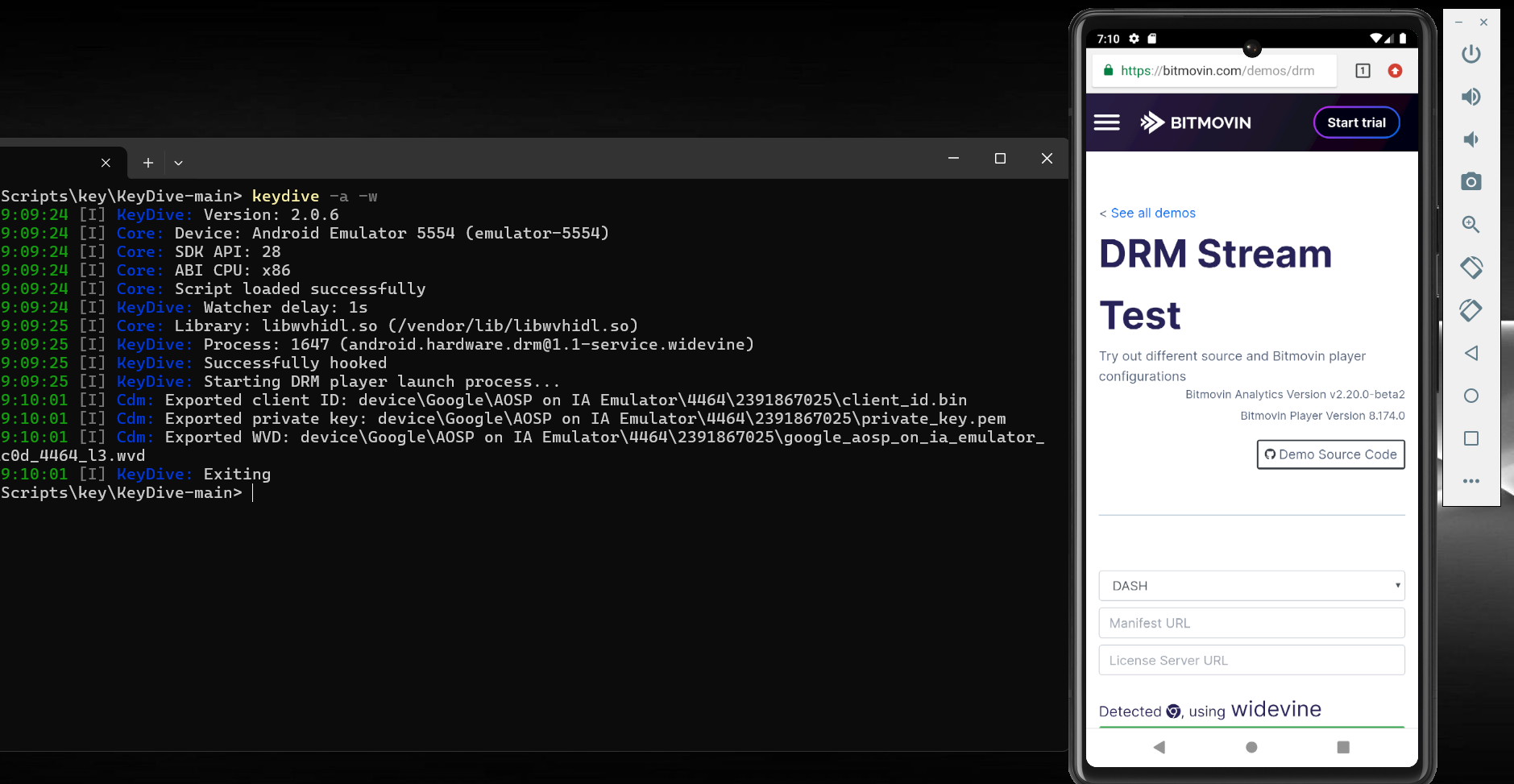

  23. Originally Posted by colebri View Post
    hello
    I'm trying to use keydive but when downloading and extracting, I don't find any keydive.py in in the KeyDive-main folder, there is just a keydive.js in the KeyDive-main/keydive folder. So how is it possible to call to use it?
    thank you for answer, I'm not use to work with these type of script
    create a venv python -m venv env
    activate it
    C:\Scripts\key\Scripts\activate or whever you have it
    Then pip install keydive installs the latest version
    pip install keydive --upgrade will update it when you want
    When your in the environment (key) PS C:\Scripts\key\KeyDive-main>
    you just type keydive -a -w
    When you have frida-server loaded -a is auto so it launches bitmovin and -w creates the .wvd as well as the other 2 files
    client_id.bin
    private_key.pem
    samsung_sm-g398fn_16.0.0_ac95c382_22589_l3.wvd
    The last was from a real device but yours will be the same layout
    [Attachment 80904 - Click to enlarge]
    Then reset the device and you can do it all again
    https://files.videohelp.com/u/33133/4464.zip there's the file it creates for you wvd etc

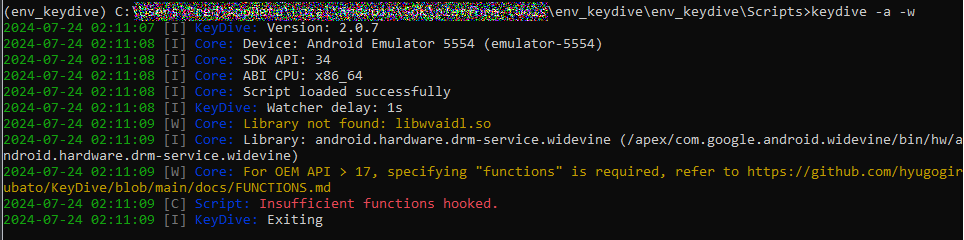

  25. Originally Posted by colebri View Post
    thank you so much for your quick and detailled answer, I really appreciate!
    did some tries tonight and here is the return I have when I type the "keydive -a -w" command:
    [Attachment 80909 - Click to enlarge]
    have really no idea on how solve this issue with libwvaidl.so
    thanks for your help!
    Which android version are you trying to hook easiest to use version 9 or you need a ghidra xml creating to get the correct hook

  28. Originally Posted by colebri View Post
    unfortunately the videos on the site I try to reach seem not to be displayable with this type of device (this is why I tried on a android 14 for which it works). The site is https://eurovisionsport.com
    Getting the cdm from Android 14+ requires an additional step. The ELF Binary needs to be imported from avd and functions.xml needs to be created from it using Ghidra. The process is detailed on Keydive page.
