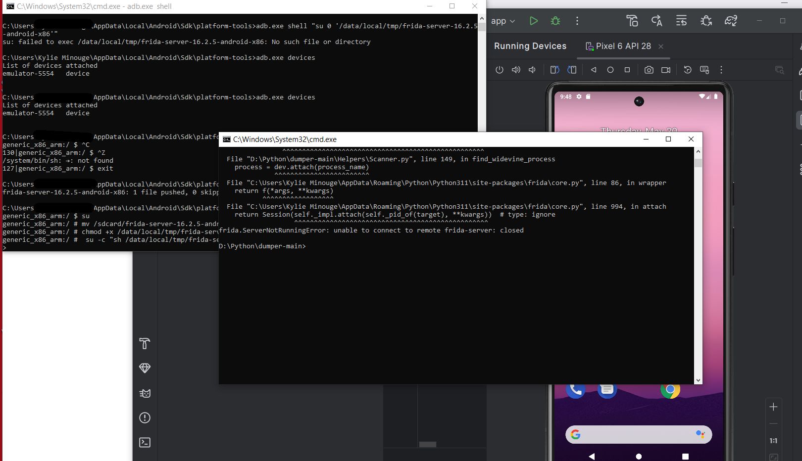

  6. That got the server running now having issues with running the dump_keys.py BTW: I had to install an earlier version of pycryptodome
    Successfully installed pycryptodome-3.14.1
    D:\Python\dumper-main>python dump_keys.py
    2024-05-30 09:35:27 PM - root - 16 - INFO - Connected to Android Emulator 5554
    2024-05-30 09:35:27 PM - root - 17 - INFO - scanning all processes for the following libraries
    2024-05-30 09:35:28 PM - root - 19 - DEBUG - Process(pid=1, name="init", parameters={})
    2024-05-30 09:35:28 PM - root - 19 - DEBUG - Process(pid=1200, name="init", parameters={})
    2024-05-30 09:35:28 PM - root - 19 - DEBUG - Process(pid=1201, name="init", parameters={})
    2024-05-30 09:35:28 PM - root - 19 - DEBUG - Process(pid=1202, name="ueventd", parameters={})
    2024-05-30 09:35:28 PM - root - 19 - DEBUG - Process(pid=1583, name="logd", parameters={})
    2024-05-30 09:35:28 PM - root - 19 - DEBUG - Process(pid=1584, name="servicemanager", parameters={})
    2024-05-30 09:35:28 PM - root - 19 - DEBUG - Process(pid=1585, name="hwservicemanager", parameters={})
    2024-05-30 09:35:28 PM - root - 19 - DEBUG - Process(pid=1586, name="vndbinder", parameters={})
    2024-05-30 09:35:28 PM - root - 19 - DEBUG - Process(pid=1592, name="android.hardware.keymaster@3.0-service", parameters={})
    2024-05-30 09:35:28 PM - root - 19 - DEBUG - Process(pid=1593, name="vold", parameters={})
    2024-05-30 09:35:28 PM - root - 19 - DEBUG - Process(pid=1636, name="android.hidl.allocator@1.0-service", parameters={})
    2024-05-30 09:35:28 PM - root - 19 - DEBUG - Process(pid=1637, name="healthd", parameters={})
    2024-05-30 09:35:28 PM - root - 19 - DEBUG - Process(pid=1638, name="vr_hwc", parameters={})
    2024-05-30 09:35:28 PM - root - 19 - DEBUG - Process(pid=1639, name="android.hardware.audio@2.0-service", parameters={})
    2024-05-30 09:35:28 PM - root - 19 - DEBUG - Process(pid=1640, name="android.hardware.broadcastradio@1.1-service", parameters={})
    2024-05-30 09:35:28 PM - root - 19 - DEBUG - Process(pid=1641, name="android.hardware.camera.provider@2.4-service", parameters={})
    2024-05-30 09:35:28 PM - root - 19 - DEBUG - Process(pid=1642, name="android.hardware.cas@1.0-service", parameters={})
    2024-05-30 09:35:28 PM - root - 19 - DEBUG - Process(pid=1643, name="android.hardware.configstore@1.1-service", parameters={})
    2024-05-30 09:35:28 PM - root - 19 - DEBUG - Process(pid=1644, name="android.hardware.drm@1.0-service", parameters={})
      File "D:\Python\dumper-main\dump_keys.py", line 21, in <module>
        libraries = scanner.find_widevine_process(device, process.name)
      File "D:\Python\dumper-main\Helpers\Scanner.py", line 149, in find_widevine_process
        process = dev.attach(process_name)
      File "C:\Users\XXX\AppData\Roaming\Python\Python311\site-packages\frida\core.py", line 86, in wrapper
        return f(*args, **kwargs)
      File "C:\Users\XXXXX\AppData\Roaming\Python\Python311\site-packages\frida\core.py", line 994, in attach
        return Session(self._impl.attach(self._pid_of(target), **kwargs))  # type: ignore
    frida.ServerNotRunningError: unable to connect to remote frida-server: closed
    Both cmd windows and the Android sim are running
    [Attachment 79479 - Click to enlarge]

  7. picabuuu juan's Avatar
    May 2024
    Mars
    @imvin
    so you created new AVD right ?
    adb.exe shell
    su...not working
    Root Your Android Phone
    - git clone https://gitlab.com/newbit/rootAVD.git
    - cd rootAVD
    - rootAVD.bat
    - rootAVD.bat ListAllAVDs .. you will see something like this
    - rootAVD.bat systems-images\amdroid-33\google_apis_playstore\x86_64\ramdisk.img
    "android-33 = your AVD API"
    "x86_64 or x86 or x64''
    -retype or copy paste : rootAVD.bat systems-images\amdroid-32\google_apis_playstore\x86\ramdisk.img [ if your API 32 and system image is x86 ]
    your avd now will close and just reopen it .

    Thank you juan , it work now .

  19. Good morning everyone, I am stuck here, how can I continue, thank you
    [Attachment 79752 - Click to enlarge]

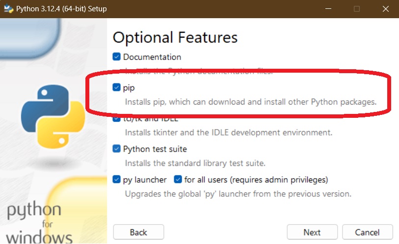

    sorry i am noob a spoon feeder. a small knowledge person but willing to learn. i am just doing in what on the post says. already created a device in Android Studio and when you said go to command prompt, now i am stuck in, command prompt says,
    C:\Windows\System32>pip install frida
    'pip' is not recognized as an internal or external command,
    operable program or batch file.
  22. Have you installed Python? it sounds like you haven't.
    Download it from here - https://www.python.org/downloads/
    When you install it check the box that says add it to the path and run as administrator. After it installs you'll be able to run PIP.
  23. Originally Posted by polkzhyzia View Post
    When you install python, it downloads and installs all the necessary components required to go along with it. Pip being one of them.
    [Attachment 79786 - Click to enlarge]
