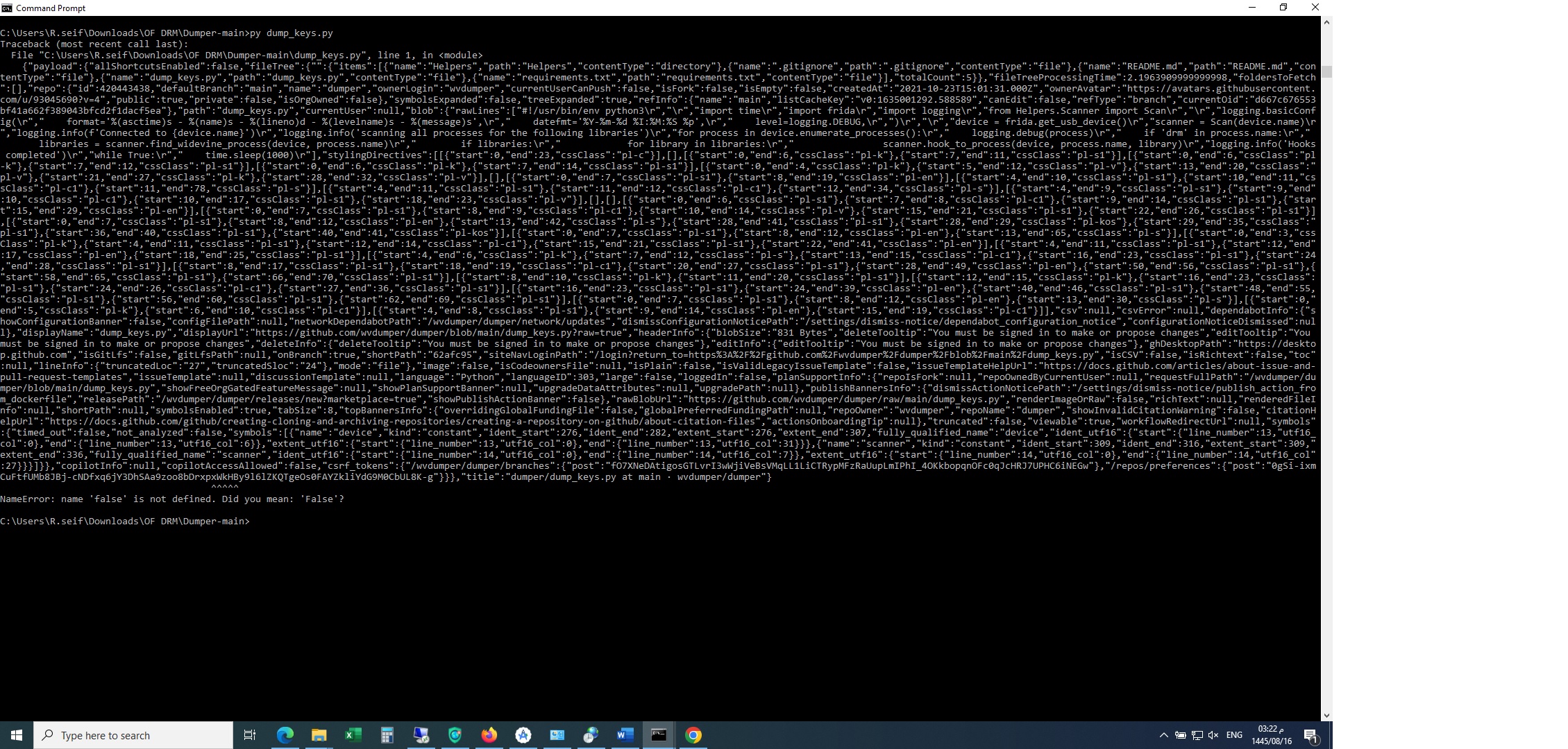

  7. i do all step's till
    Place yourself in the Directory (cd /....) of dumper main and launch dump_keys
    i face this message :
    [Attachment 77269 - Click to enlarge]
    what i have to do ?

    I got this. There is no key_dumps folder in dumper folder. I tried for Android 12.
    What dumper did you use? Try this: https://github.com/Diazole/dumper
    I used this script for Android 12 in Android Studio, but it does not create the key_dumps folder in the script. How can I fix this?
    Check your CDM version with the DRM Info app and then use it in the dumper command:
    --cdm-version "16.1.0"
    or whatever it might be (if it's any less than that, it won't make a difference though).
    I tried this command also, not working.
    Edited: It worked for Android 11.
