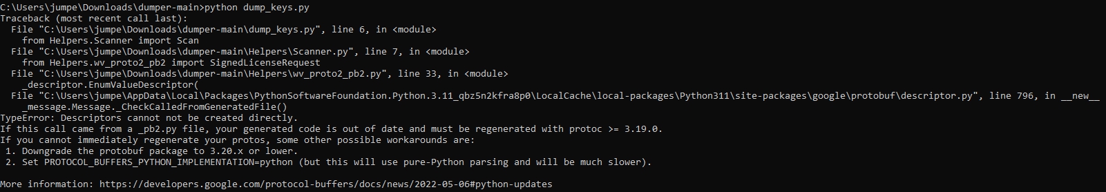

  1. Hello, I was wondering if anyone is able to help with the error i'm getting?
    [Attachment 72845 - Click to enlarge]
    I think I'm at the stage of using the dumper-main to get the keys but I'm getting stuck with the error above.
    EDIT:
    after downgrading protobuf it worked, thanks for the tutorial!

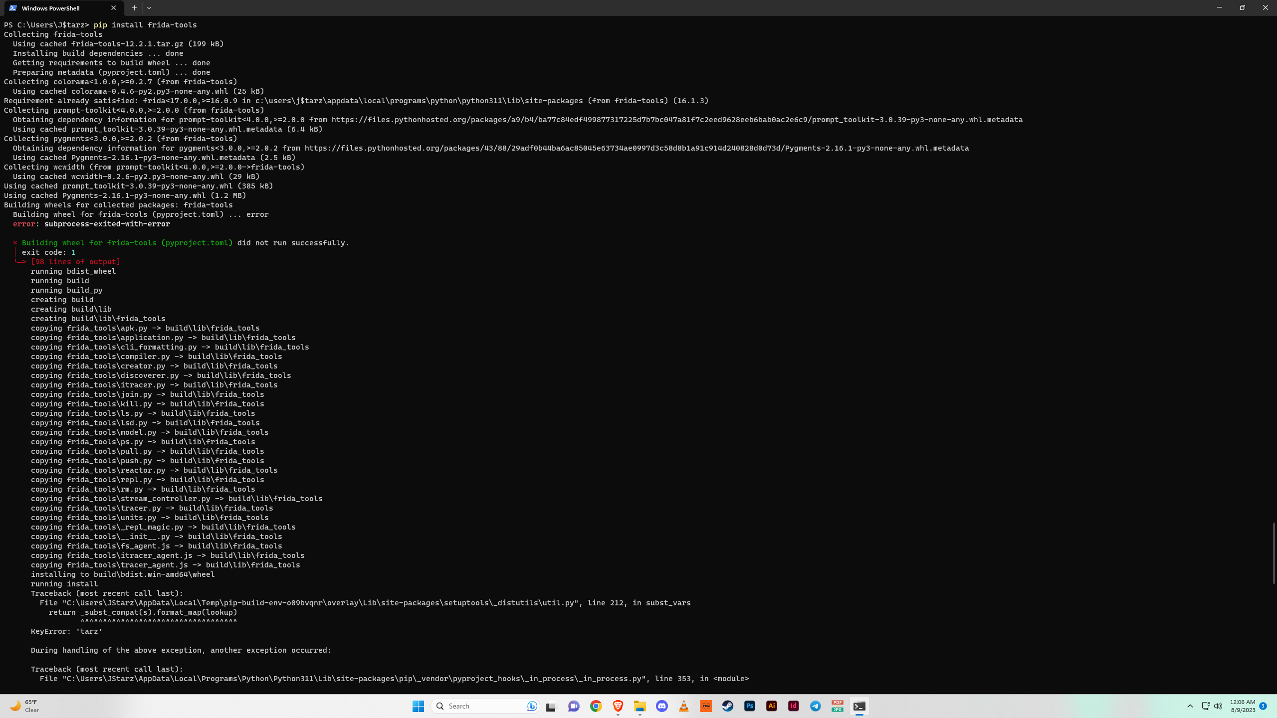

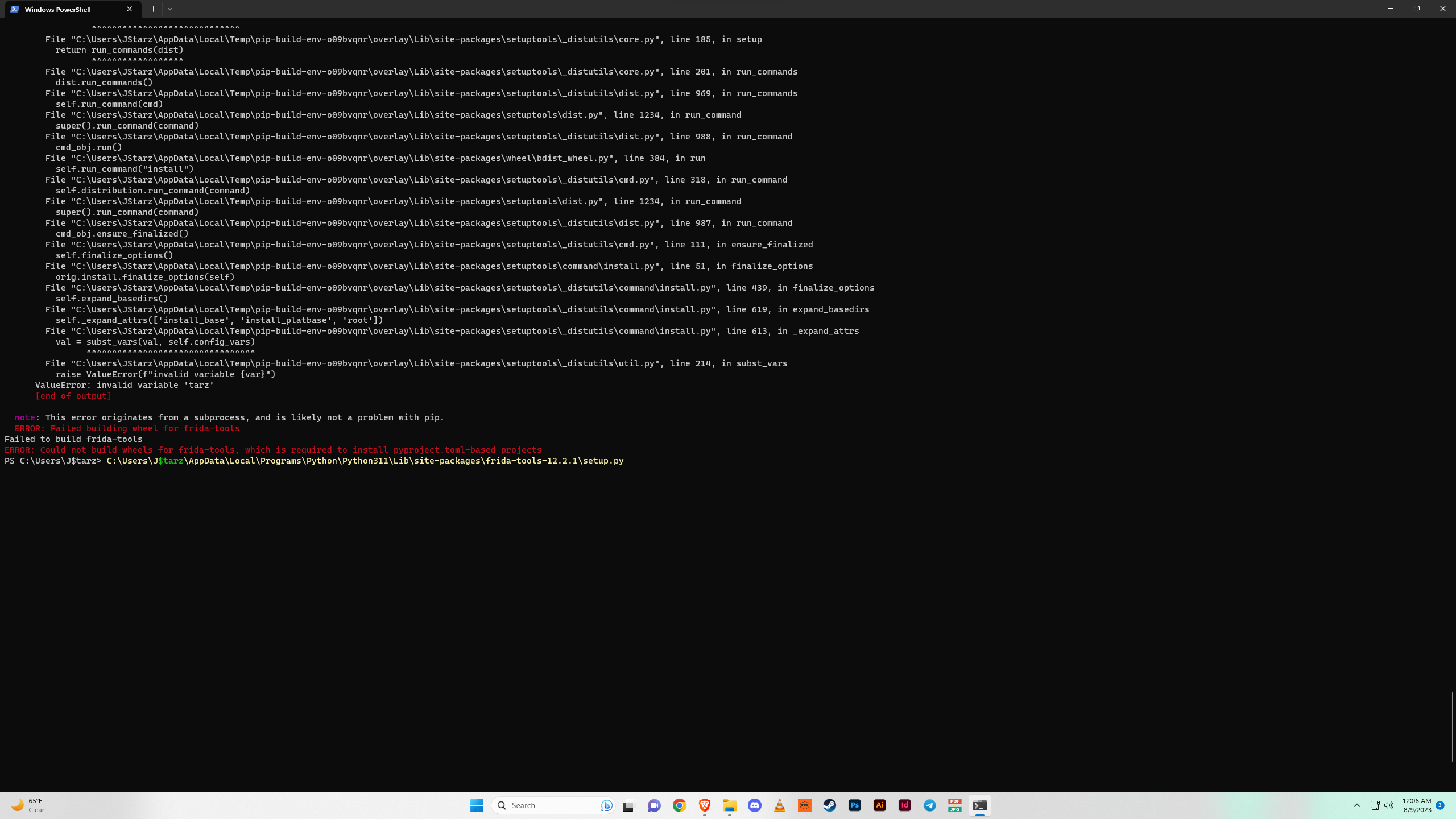

  4. Hey, new to the site. Im running the latest version of python and pip and frida. however, when I go to install frida, I get the same error message. any help would be appreciated.Image
    [Attachment 73053 - Click to enlarge]
    [Attachment 73054 - Click to enlarge]

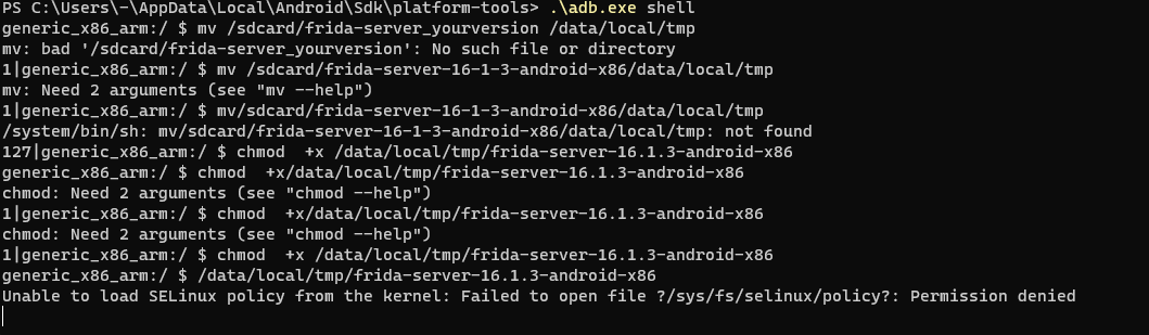

  9. Hey this is what happens when I try to start the frida server.
    [Attachment 73182 - Click to enlarge]
  10. Search, Learn, Download! Karoolus's Avatar
    Oct 2022
    Belgium
    Read the error messages.
    The file you're copying to your phone/emulator does not exist (wrong name) so all subsequent commands also do nothing
    You also need to be root to do all this, so first of all type
    su
    mv /sdcard/frida-server-16-1-3-android-x86 / data/local/tmp
    chmod +x /data/local/tmp/frida-server-16-1-3-android-x86

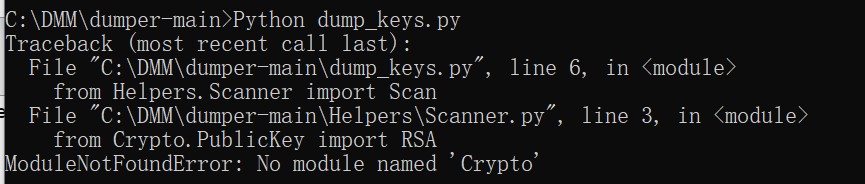

  17. Greetings, videofriends. I was following the guide, and initially I got the infamous line errors with the dumper script. Using protobuf 3.20.3 and
    pycryptodome 3.16.0 seemed to fix that problem. I am able to push the frida sever file, or so it seems. I don't know if I'm supposed to push the dll or the xr, but once I go the SU step of moving and running it, it doesn't work. With either the compressed or uncompressed file.

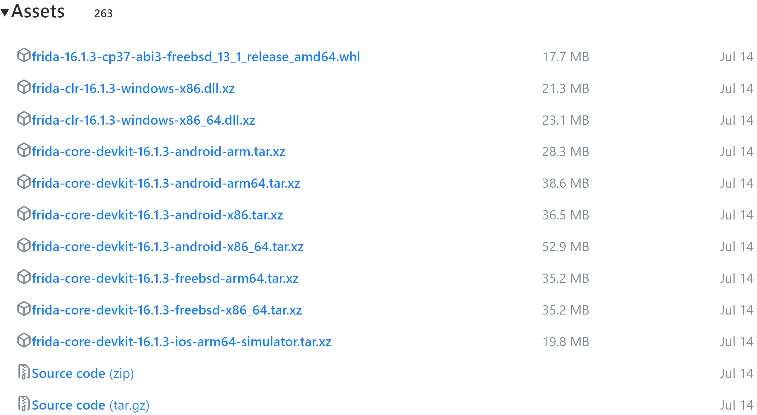

    The Frida releases from the guide's link are archived dlls. The adb.exe push command doesn't work, at least on my end, without specifying the extension as well. Although both are successfully pushed, archived or not, they give the same type of error:
    error: PS C:\Users\**redacted**\AppData\Local\Android\Sdk\platform-tools> ./adb shell
    generic_x86_arm:/ $ mv /sdcard/frida-server_yourversionfrida-clr-16.1.3-windows-x86.dll.xr/data/local/tmp
    /data/local/tmp/frida-clr-16.1.3-windows-x86.dll.xr
    /data/local/tmp/frida-clr-16.1.3-windows-x86.dll.xrmv: Need 2 arguments (see "mv --help")
    1|generic_x86_arm:/ $ chmod  +x /data/local/tmp/frida-clr-16.1.3-windows-x86.dll.xr
    chmod: /data/local/tmp/frida-clr-16.1.3-windows-x86.dll.xr: No such file or directory
    1|generic_x86_arm:/ $ /data/local/tmp/frida-clr-16.1.3-windows-x86.dll.xr
    /system/bin/sh: /data/local/tmp/frida-clr-16.1.3-windows-x86.dll.xr: not found
    127|generic_x86_arm:/ $ su
    rida-clr-16.1.3-windows-x86.dll.xr /data/local/tmp
    chmod  +x /data/local/tmp/frgeneric_x86_arm:/ # mv /sdcard/frida-clr-16.1.3-windows-x86.dll.xr /data/local/tmp
    /data/local/tmp/frida-clr-16.1.3mv: bad '/sdcard/frida-clr-16.1.3-windows-x86.dll.xr': No such file or directory
    -1|generic_x86_arm:/ # chmod  +x /data/local/tmp/frida-clr-16.1.3-windows-x86.dll.xr
    windows-x86.dll.xrchmod: /data/local/tmp/frida-clr-16.1.3-windows-x86.dll.xr: No such file or directory
    1|generic_x86_arm:/ # /data/local/tmp/frida-clr-16.1.3-windows-x86.dll.xr
    127|generic_x86_arm:/ #
Name:	frida releases.jpg

    Originally Posted by HJPM View Post
    Originally Posted by Karoolus View Post
    dll or xr file? I'm confused.
    Post your commands (and if you can, screenshots as well)
    You are downloading the wrong version.
    You need frida-server-android-x86
    Not the Windows version

    Frida-server-android-x86 appears to only be source files. Regardless, the sample command "adb.exe push frida-server-16.0.2-android-x86 /sdcard" continues to not run unless I also specify the file extension. Once I get to the final, mv command, I get this error:
    /system/bin/sh: /data/local/tmp/frida-core-devkit-16.1.3-android-x86.tar.xz: not executable: magic FD37
    you're not reading what I said.. You need the SERVER files, not the core devkit.
    This is the one you're after:
    https://github.com/frida/frida/releases/download/16.1.3/frida-server-16.1.3-android-x86.xz
    Unpack it first, you need to end up with a file "without an extension"
    Then run the adb commands and the shell commands

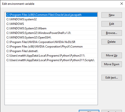

  25. ok got a little problem, when I try to use the "dump_keys.py" it just opens and it automatically closes. When I open up cmd in the dump keys directory and type in python3 dump_keys.py in the cmd, it says "Python was not found; run without arguments to install from the Microsoft Store, or disable this shortcut from Settings > Manage App Execution Aliases." Is there a way to fix this please?
  26. Search, Learn, Download! Karoolus's Avatar
    Oct 2022
    Belgium
    Install Python and make sure it's added to the environment PATH variable.
    Google it to get more information, it'll make more sense that way
  27. Originally Posted by Karoolus View Post
    I have the latest python version installed 3.11.4.. Its in the location "AppData\Local\Programs\Python\Python311"
  28. Search, Learn, Download! Karoolus's Avatar
    Oct 2022
    Belgium
    Google how to add it to the PATH, it's not that hard but it'll be easier if you see screenshots or a video
  29. sorry ignore that last message hopefully I did it right
  30. Image
    [Attachment 73242 - Click to enlarge]
    ok Its still saying the same thing. This is what I did as following the video.
