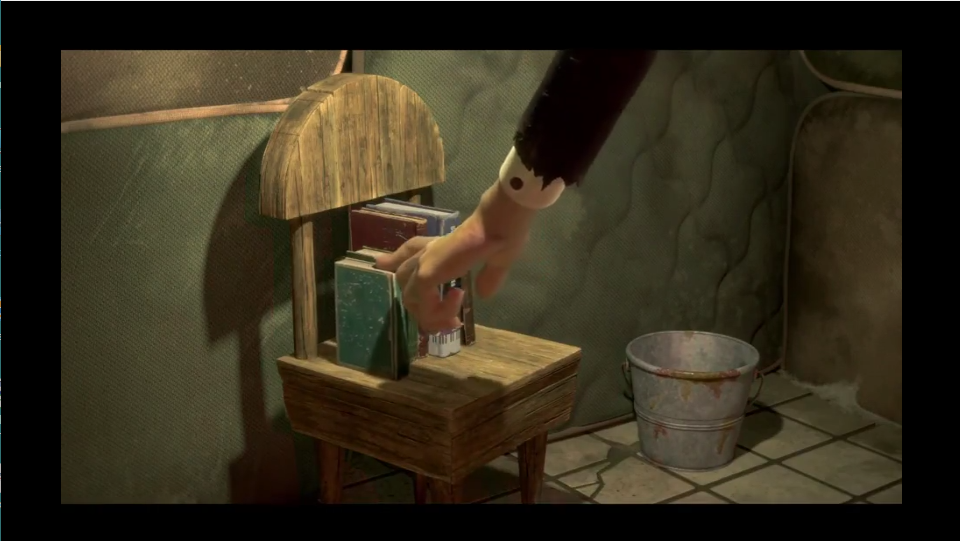

    With this scaling of 960:456 you actually convert your square pixel 1920x1040 source to an anamorphic picture with a Pixel Aspect Ratio of 0.877 which is pretty close to a standard 4:3 NTSC DVD (which has a Pixel Aspect Ratio of 0.889). Then you pad it to 960:540 pixels (=1.78=16:9). It looks like your playback scenario plays it back accordingly, means according to the anamorphic Pixel Aspect Ratio of 0.877 which returns a full frame (i.e. including the borders) of 842:540 pixels with a correct active movie picture of 842:456 pixels = 1.85:1.
    Edit:
    Out of curiosity using your commandline, this is how my 16:9 TV plays it boxed, with top+bottom bars from your padding, and left and right pillars padded by the TV.
    The movie is displayed correctly at 1.85:1 aspect ratio. Your TV's 2.5% overscan will definitley not hide anything of the movie.
