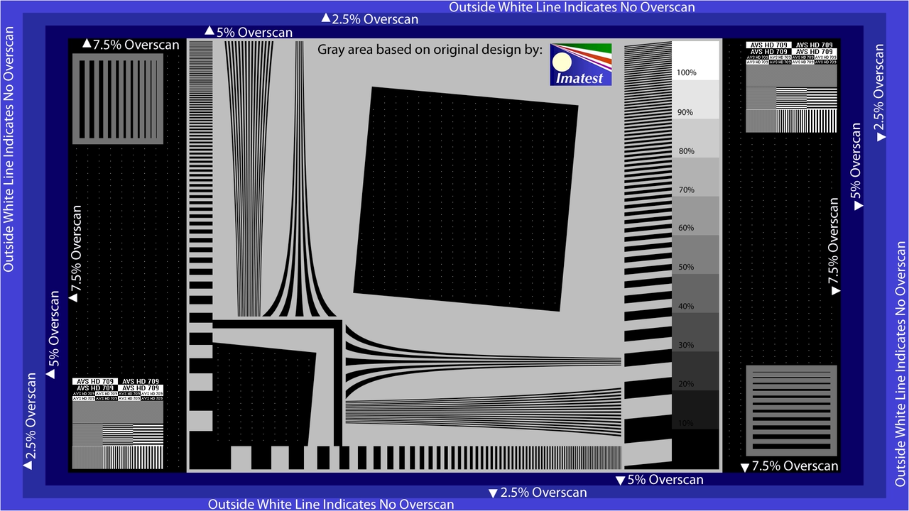

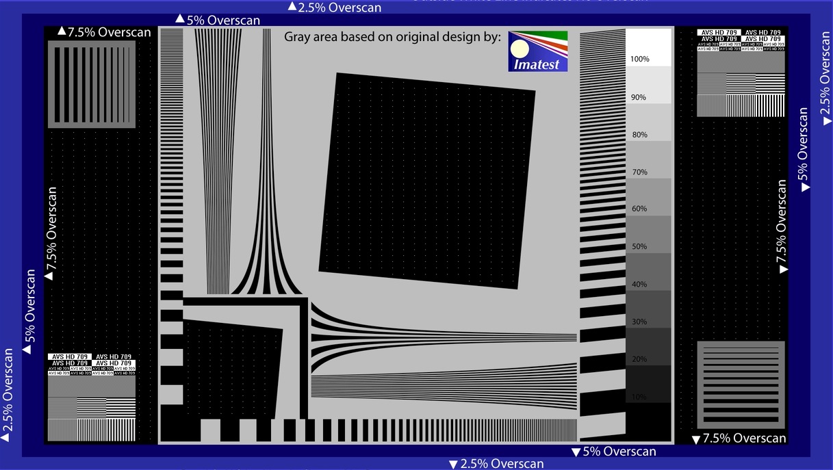

  21. @whs912km:
    Play the file Overscan-test.mp4 on your TV and compare with the attached screenshot.
    Does your TV show the complete picture, or is a part of it hidden by overscan?

  22. @ProWo
    my TV is very old ... anyway
    brand: Tele System
    model: PALCO19 LED01 B01
    @Sharc
    on my TV i see that. on 16/9 output and same on automatic output
    [Attachment 68384 - Click to enlarge]
    Max resolution 1366 x 768, but the rest seems normal.
    You have 2,5% overscan. You connect via USB or HDMI?

    OK. Your TV has 2.5% overscan. Thats why you will not see the small top/bottom borders of 1.85:1 movies. They are simply hidden by the overscan of your TV. Nothing really wrong with it. It's not unusual for old TVs to apply some overscan.

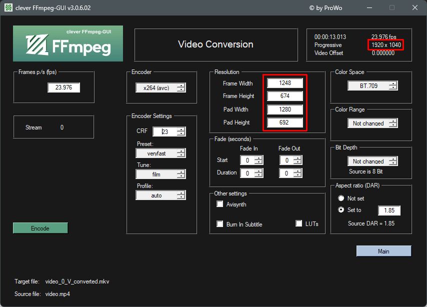

  27. another news: today i've check errors with clever (GUI developper by ProWo, thanks mate for this GUI) and i have this error from my video talking above:
    [null @ 00000000023fca00] Application provided invalid, non monotonically increasing dts to muxer in stream 0: 64734 >= 64733
    [null @ 00000000023fca00] Application provided invalid, non monotonically increasing dts to muxer in stream 0: 64734 >= 64734
    maybe my issue to watch on my TV is due to this error?? or useless error?
    and another question @ProWo: from clever on Video Conversion section i see on encoder, also wmp.
    but wmp is actually good format ? better than mpeg2 ?
    from all clever encoders which is the fastest for a conversion and good quality? from xvid, divx, wmp, mpeg2
    example libx264 is excellent quality but speed conversion is only 2x; with mpeg2 speed conversion is about 5x (big final file, near quality, but faster speed)

  29. Recode your original 1920x1040 video with this settings:
    [Attachment 68397 - Click to enlarge]
    This should compensate the 2.5% overscan and let you see the whole videoframe on your TV.
    Change the TV display setting from 16:9 to auto.
