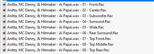

Thank you fore the help of everyone!! All of this started because I wanted to extract the channels of a song to get some backing vocals and stuff. I usually do it by myself on audacity and get the 6 channels, although they have mixed vocals on every track. I met this guy on discord, that was able to get more channels than the 6 ones with clear backing vocals on some tracks. These are the files he got:
[Attachment 68367 - Click to enlarge]

I got up to the D*m, gave it a sweet kick then started playing the EAC3-JOC files because i didnt want to go through setting up a spatial player again, here is one such file, these are
Code:<SupplementalProperty schemeIdUri="amz-music:trackType" value="3D" codecs="ac-4.02.02.00" audioSamplingRate="48000" bandwidth="260480" mimeType="audio/mp4"> <AudioChannelConfiguration schemeIdUri="urn:mpeg:mpegB:cicp:ChannelConfiguration" value="2"/> <SupplementalProperty schemeIdUri="tag:dolby.com,2016:dash:virtualized_content:2016" value="1"/>
According to MediaInfo, the file you linked to contains Dolby AC-4 audio. https://professional.dolby.com/siteassets/technologies/dolbt_atmos_ac-4_whitepaper.pdf
I'm not familiar with the format and wouldn't know if there are pc players that support it. -
yeah no normal players will play directly, have to first get all the 360 objects to play in a spatial player
