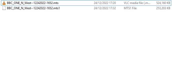

  6. I have now discovered that the August recorder did record the whole show, but for some strange reason it created a separate file which was unrecognisable on my laptop. It created a MTS1 file (no idea what that it).
    [Attachment 68343 - Click to enlarge]
    I discovered this when I imported the file into Handbrake. So I then encoded both files to an MP4 file. I then used Lossless Cut to merge the two files together, but when I played the file back through my TV the audio was fine at first but then went out of sync, but towards the end the audio was in sync again, no idea how but maybe when the second part was played it may've brought the audio back into sync again. I then discovered the merged file was 24fps, yet I had made sure that both files in Handbrake were set to 25fps, which they were. And also, when I tried to copy the file over to an external HDD (file was about 4gb using the lossless setting in Handbrake) it said the file was too large to fit onto the HDD, yet there's over 100GB of space on it. I could copy over the two separate files though which were same size anyway.
    No idea why the recorder created two different files, but my guess is that the recording stopped mid way through the broadcast and resumed straight away but created an unreadable file, or maybe it couldn't finalise the recording for some reason. I'm sure more knowledgeable people on here will have an answer to this.
