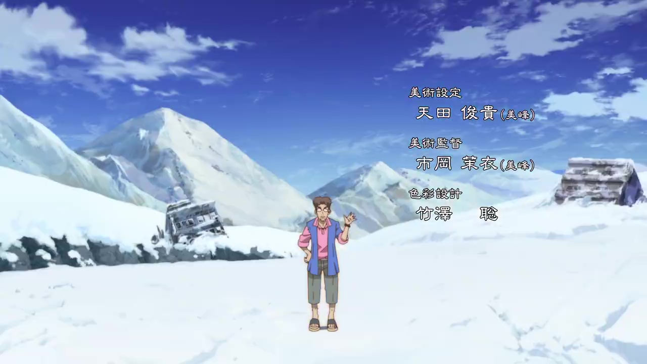

    My encode result:
    [Attachment 68304 - Click to enlarge]
    [Attachment 68305 - Click to enlarge]

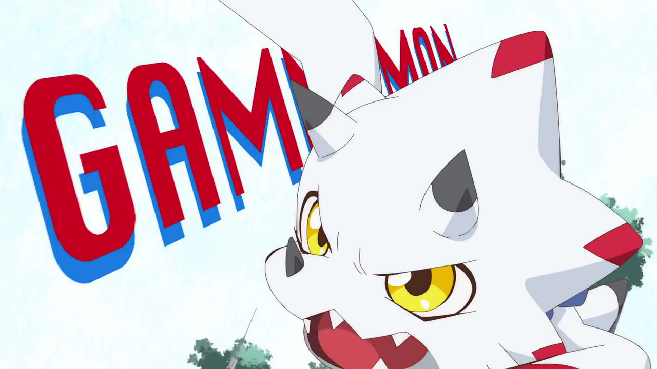

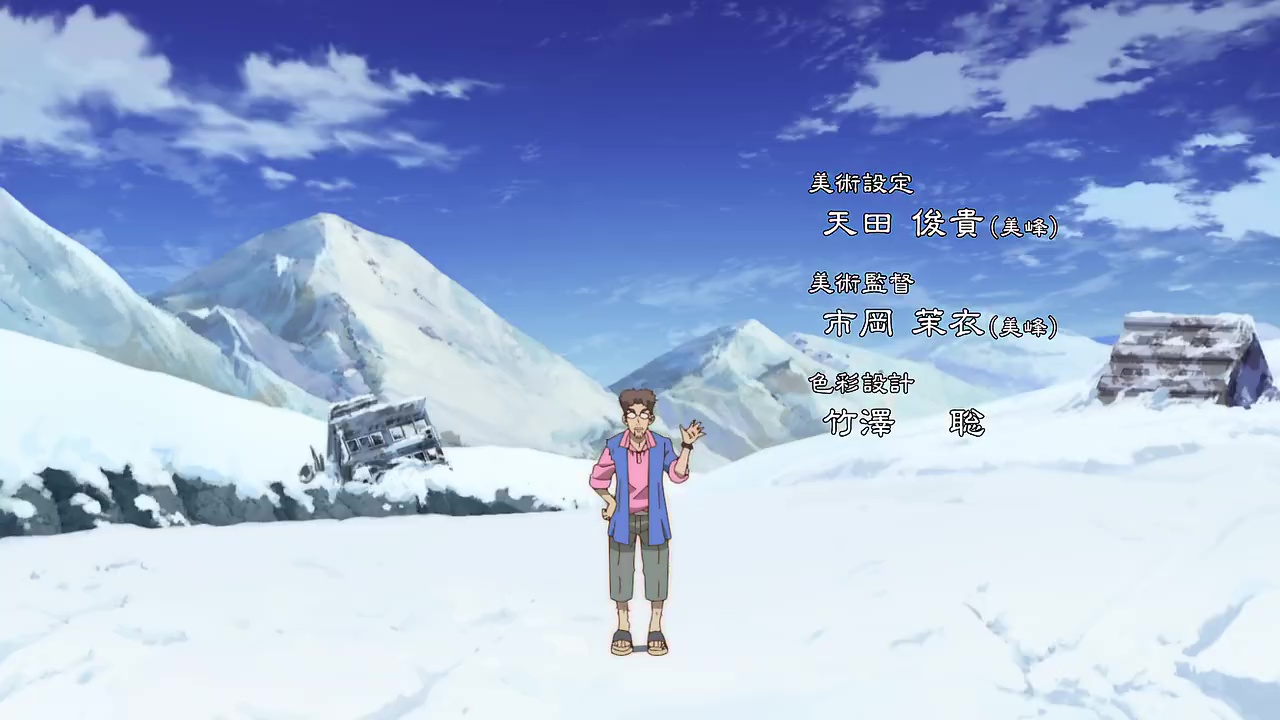

    Their encode result:
    [Attachment 68306 - Click to enlarge]
    [Attachment 68307 - Click to enlarge]

  2. Probably filtered and sharpened (and/or a sharper downscaling algorithm), you can see ringing artifacts around the text.
    Maybe the encoding settings were different too, you can check with mediainfo (view=>text)

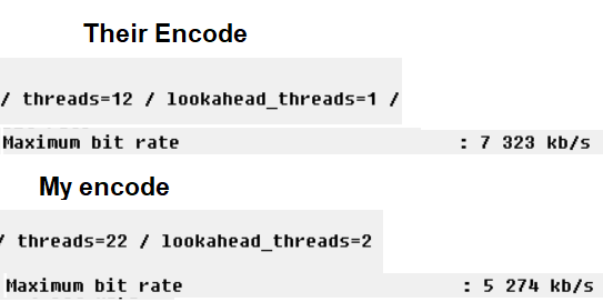

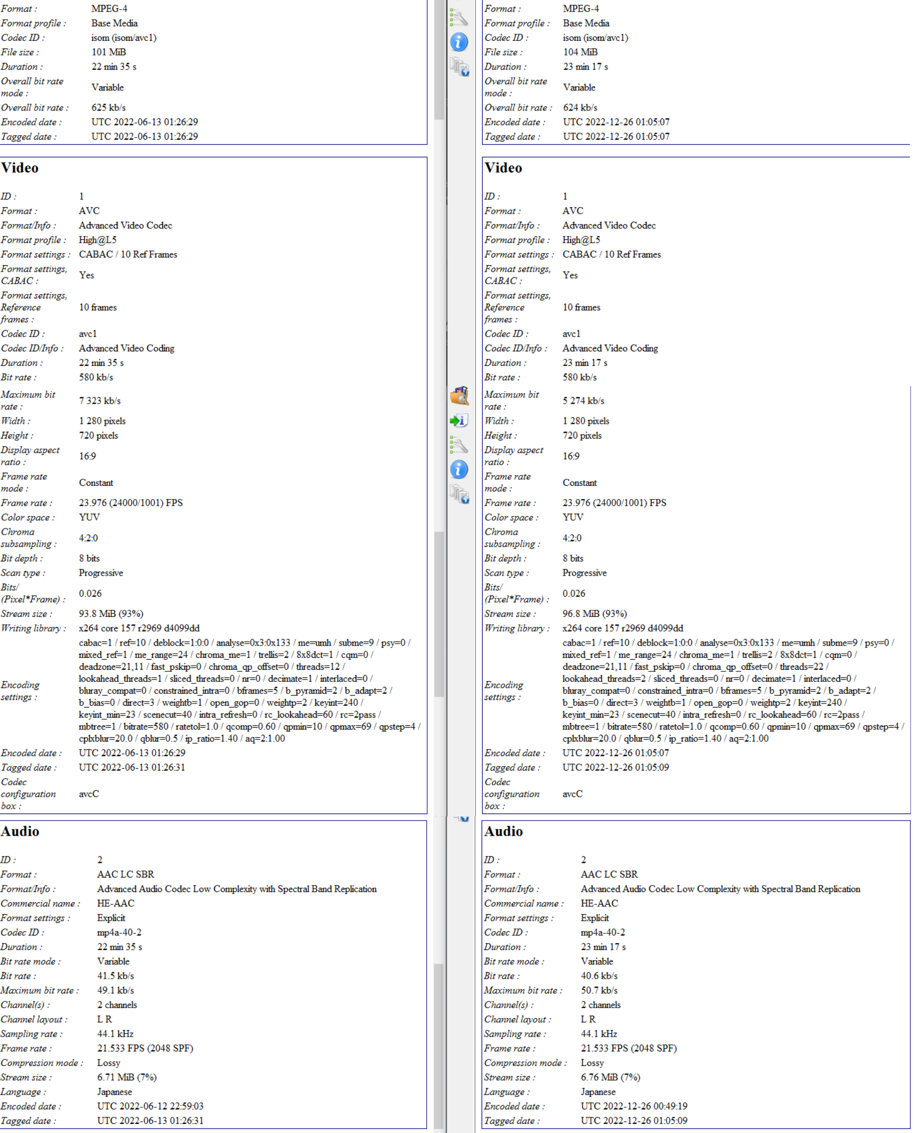

    Edit: I ran the thing on MediaInfo and this is the only major difference i found.
    [Attachment 68318 - Click to enlarge]
    Here is the data for the full thing. Left side is their encode, right side is my encode using their profile for megui.
    [Attachment 68319 - Click to enlarge]
