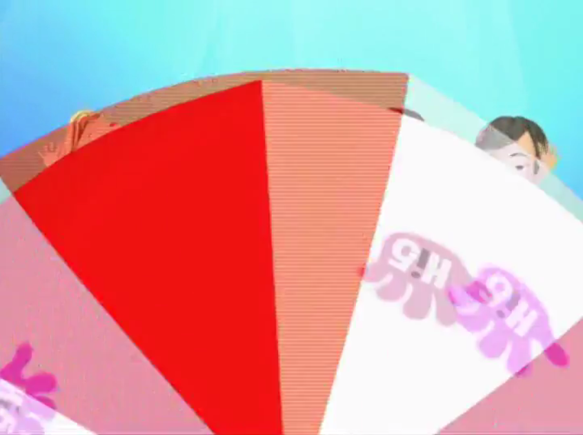

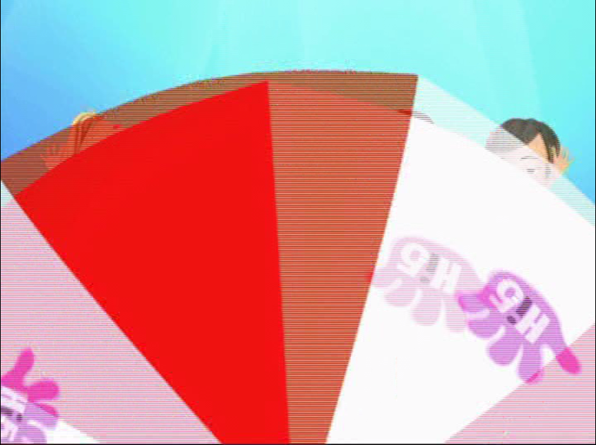

    After IVTC this DVD with Handbrake, there is some very noticeable color ghosting. You can see the ghosting even without IVTC
    IVTC
    [Attachment 68295 - Click to enlarge]
    Original interlaced
    [Attachment 68296 - Click to enlarge]
    How can i fix this color ghosting?

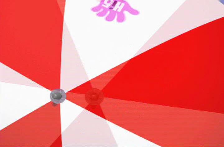

    Well i tried inverce telecining with manono's code but i still get the color ghosting. My best bet is that chroma has been telecined some other way. Or maybe interlaced some other way.
    [Attachment 68299 - Click to enlarge]
  11. The source looks borked to me. Blended fields all over, probably due to some earlier bad framerate conversion.
    Perhaps some improvement is possible with something like:
    QTGMC() #or yadif(mode=1)
    sRestore(frate=23.976)

    And yes, your source is messed up. It's a PAL to NTSC conversion with field blending but has even more blending than normal. QTGMC.SRestore() will help a lot (and give smooth motion) but there will still be some blending.

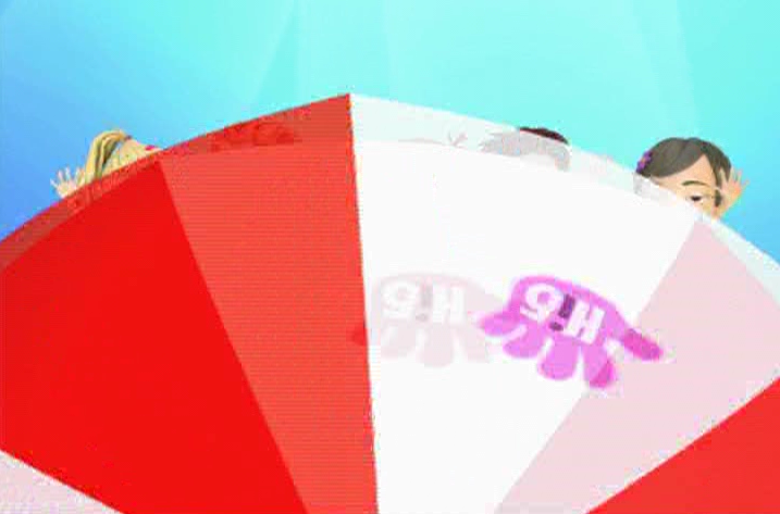

    I tried you script but to no avail. It still has the same ghosting

    It's probably as good as it can get. If you step through the frames sequentially you will see that most of the ghosts are fixed but some ghosts still remain. As has been explained before this source has been screwed up (double blended fields) and can't be fully fixed.
    For a smooth playback set sRestore(frate=25.0) as the original frame rate was most probably 25fps (PAL).
