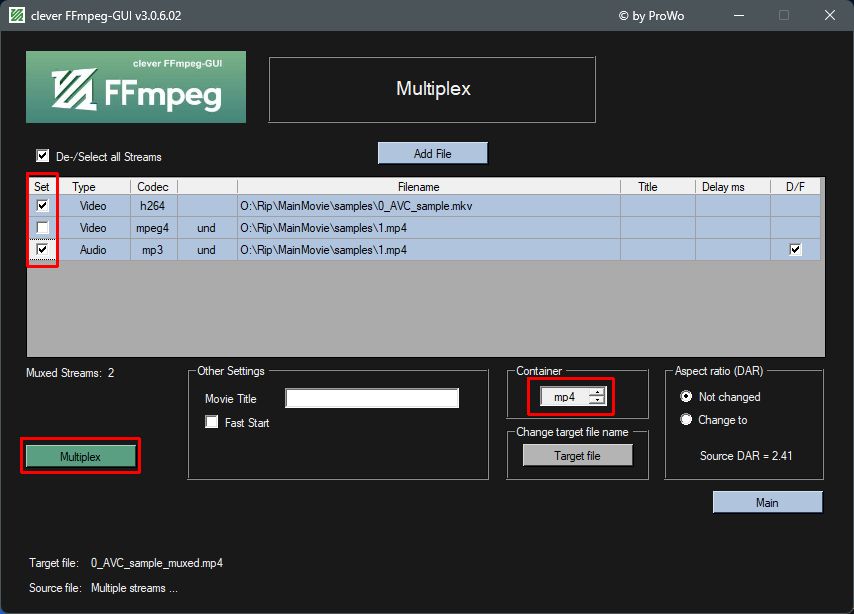

No clue with DaVinci resolve, but you can use clever FFmpeg-GUI, small, portable, no installation, for this:
Because both have the same length and FPS, this is quite simple.
Load your new video without sound, click main, click multiplex, drag and drop the video with sound, the first video and the audio should be checked automatically, set the desired container (mp4/mkv) and click multiplex. Done.
[Attachment 68251 - Click to enlarge]
You'll find your new video with sound in the target folder. -
