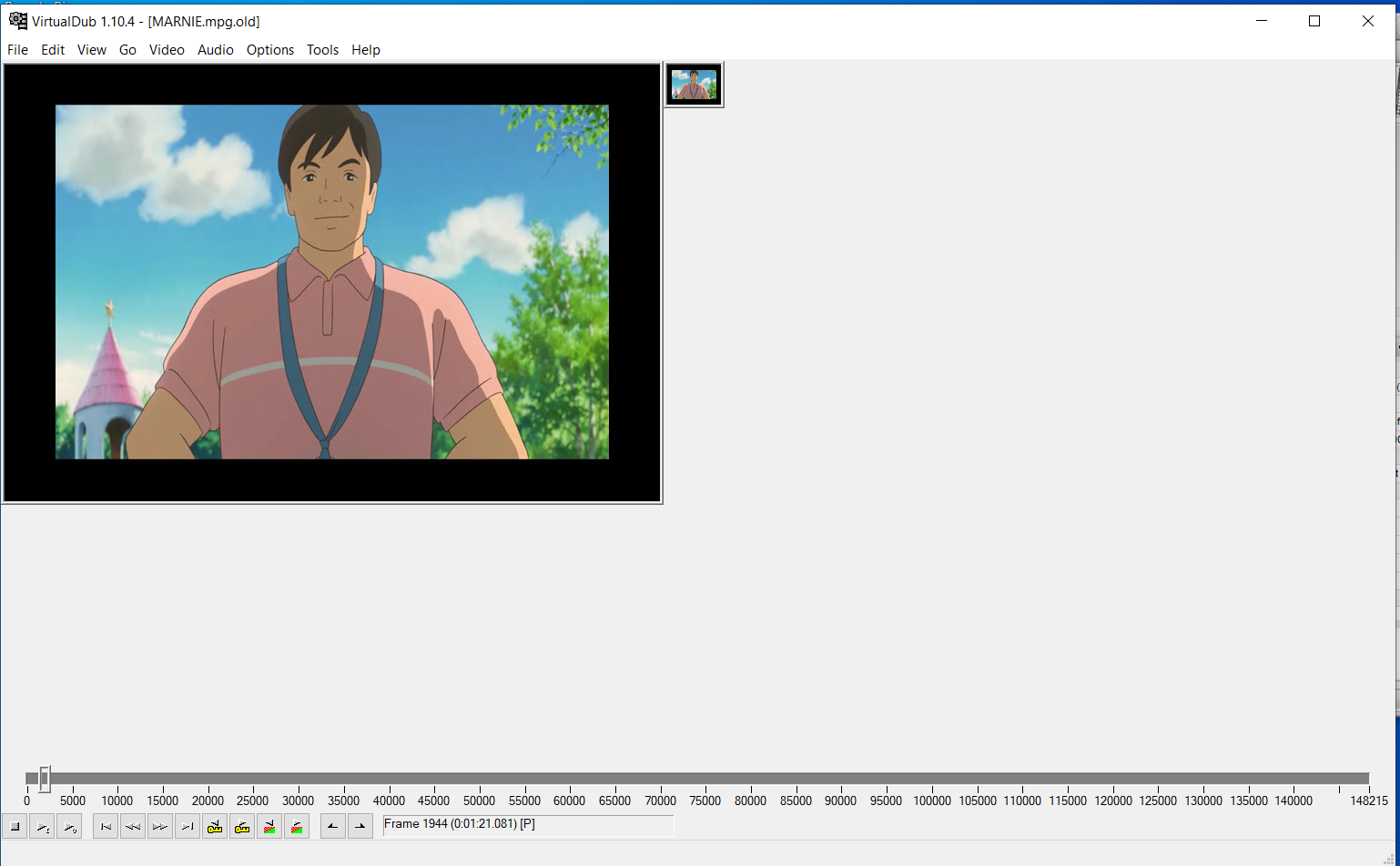

  1. Trying to figure how to make a correct picture size for a video to a DVD.
    The file was converted to 720x480 size, 16:9 aspect ratio, 23,9 fps.
    As seen on the screenshot, there appears a black frame around the picture and I want to remove it, or at least part of the frame somehow without it looking dorky.
    Not sure if this is common due to the aspect ratio or image size. What do you suggest?
    [Attachment 68222 - Click to enlarge]

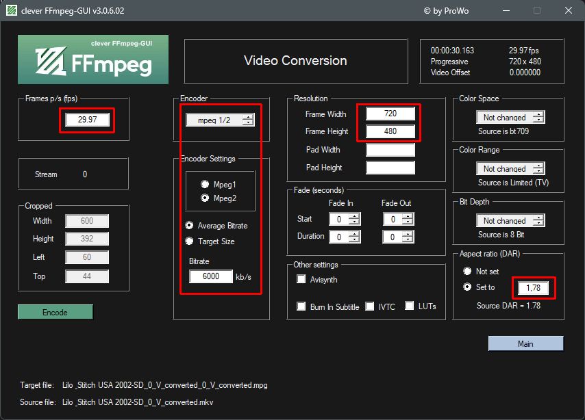

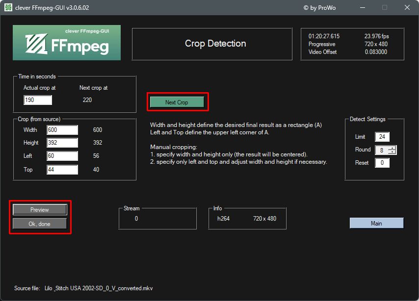

  6. Use clever FFmpeg-GUI.
    Load your video, click main, click encode video stream, click crop detect.
    [Attachment 68233 - Click to enlarge]
    click 2 or 3 times next crop, the crop values should remain the same, check the result with preview.
    If you see the full frame without black borders, click OK, done.
    In the next window set all like in the picture, signed in red. Leave all other settings as they are and click encode.
    [Attachment 68257 - Click to enlarge]
    If done, you find your new video without black bars in the target folder.

    If you want a 1:85 output use this values:
    [Attachment 68239 - Click to enlarge]
