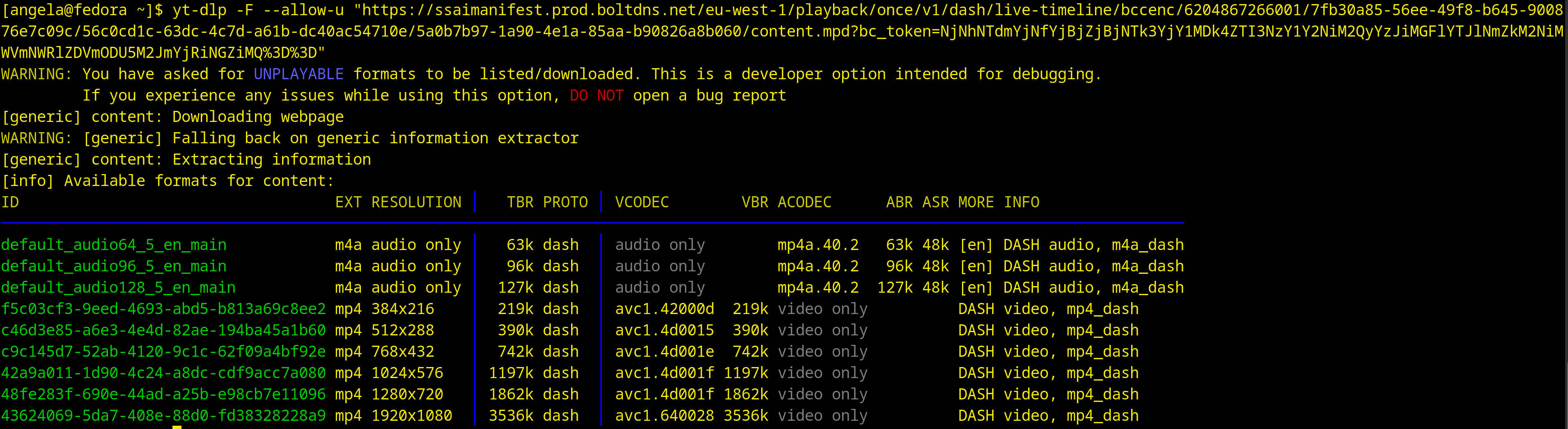

    here's what I get when I list formats:
    [Attachment 68221 - Click to enlarge]
    I have tried:
    -f "[format_id^=default_audio128]"
    -f "[format^=default_audio128]"
    -f "[id^=default_audio128]"
    with and without quotes, doesn't work. also with quotes around the "default_audio128" part, no luck. always the same "Requested format is not available" message.

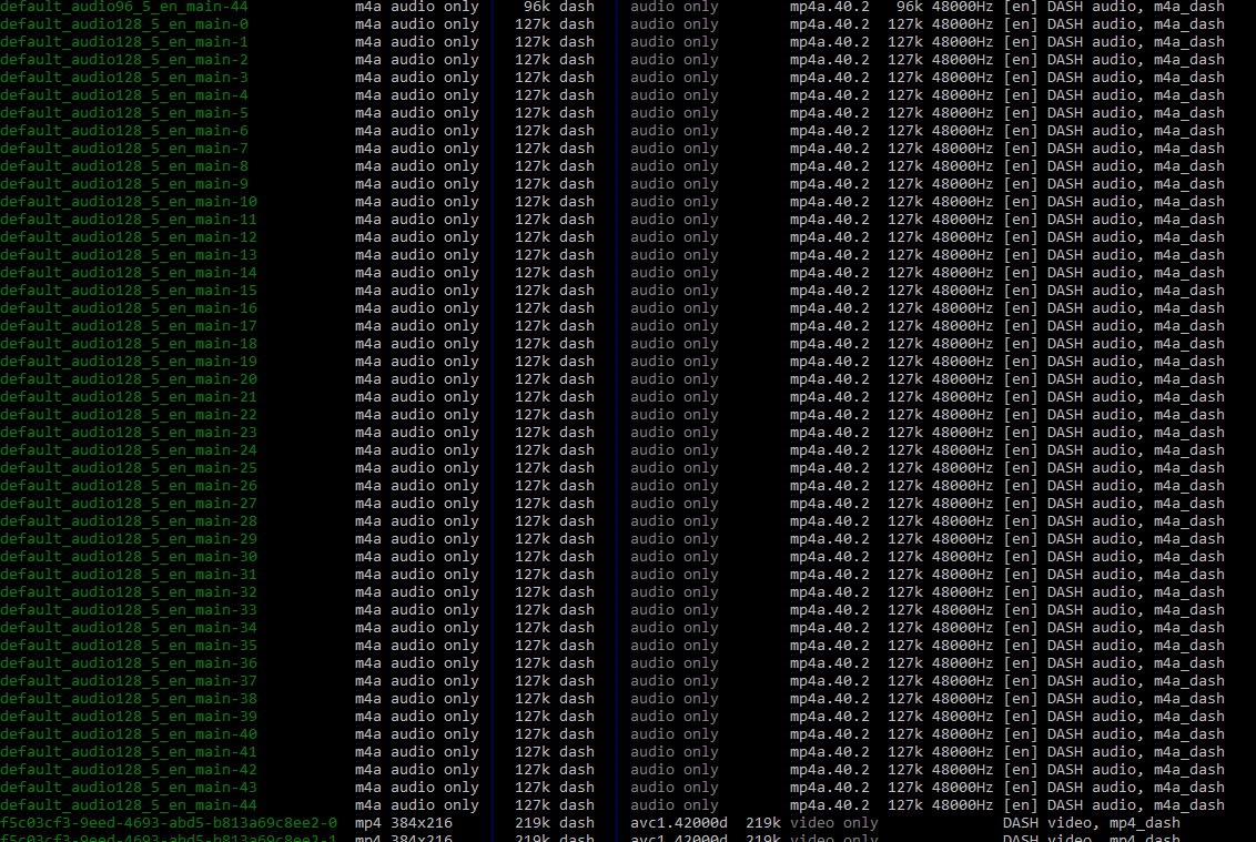

  2. Code:
    yt-dlp -f "all[vcodec=none]"
    Dec 2020
    Croatia
    but won't that download the other audio formats as well, when I'm aiming to get only the default_audio128_5_en_main-XX ones?
  4. I dunno ? You have shown an edited screengrab and not given the url of the video..............so I cant look properly or test ideas.
    It looks like a multi-period type mpd so you need all parts of the selected audio and all parts of your selected video, decrypted, then merged and finally muxed.
    While your being vague no one can definitely assist. Show the complete formats screen grab or give the url/login
    Another guess, as cant test due to lack of info but try:
    yt-dlp -f "all[abr=127]"
    And for video:
    yt-dlp -f "all[vbr=xxxx]"
    Or alternatively load the mpd in to N_M3U8DL.exe. This can cope with multiperiod format mpds and will do all the binary merging, decrypting and muxing for you.

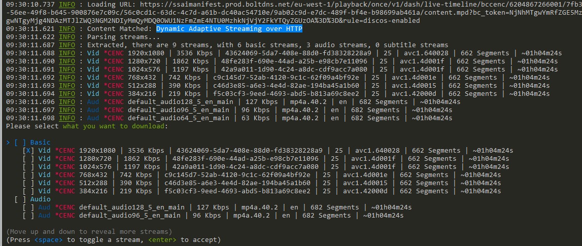

    about your question run:
    re -M format=mkv --key bb61081e2c7e46128907e440dc0708da:2d902a60abb49d8775c528c1a57b2e25 "https://ssaimanifest.prod.boltdns.net/eu-west-1/playback/once/v1/dash/live-timeline/bccenc/6204867266001/7fb30a85-56ee-49f8-b645-900876e7c09c/56c0cd1c-63dc-4c7d-a61b-dc40ac54710e/9ab02c9d-e7dc-489f-bf4e-b98699ab461a/content.mpd?bc_token=NjNhMTgwYmRfZGE5MzY4MjgwNTgyMjg4NDAzMTJlZWQ3NGM2NDIyMmQyMDQ0OWU1NzFmZmE4NTU0MzhkNjVjY2FkYTQyZGUzOA%3D%3D&rule=discos-enabled" --save-name insouponnable_ep01
    (where re is abbreviation of N_m3u8DL-RE)
    and you have full list of video and audio. i don't know/understand your issue

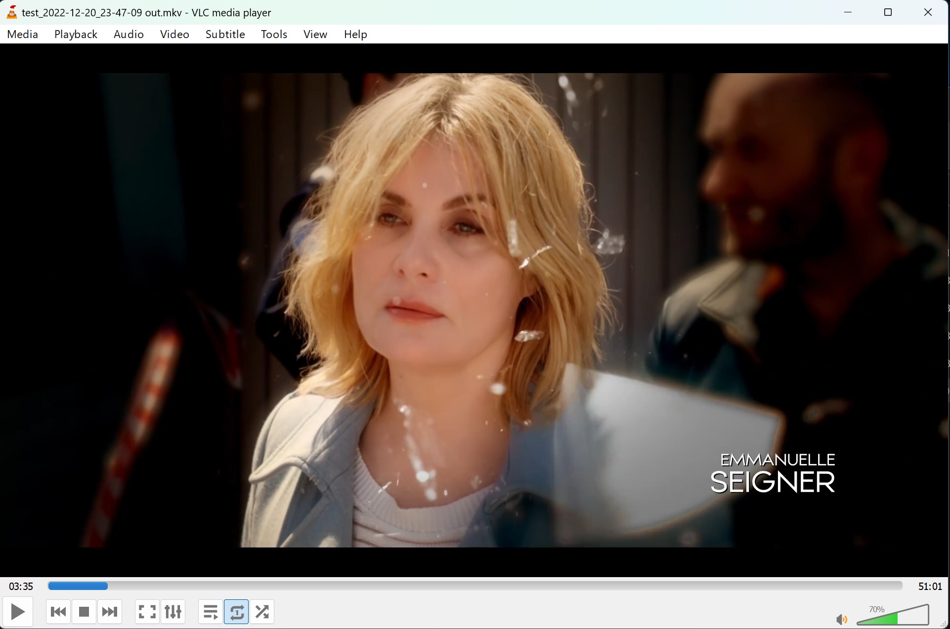

    the issue is: "I'd have an episode with ads in it"
    look at the length of the video: 1h04m24s for a 51 minute episode

  17. N_m3u8DL-RE work with mpd from local path. no need to upload to some server. simply run:
    N_m3u8DL-RE "C:\file.mpd"

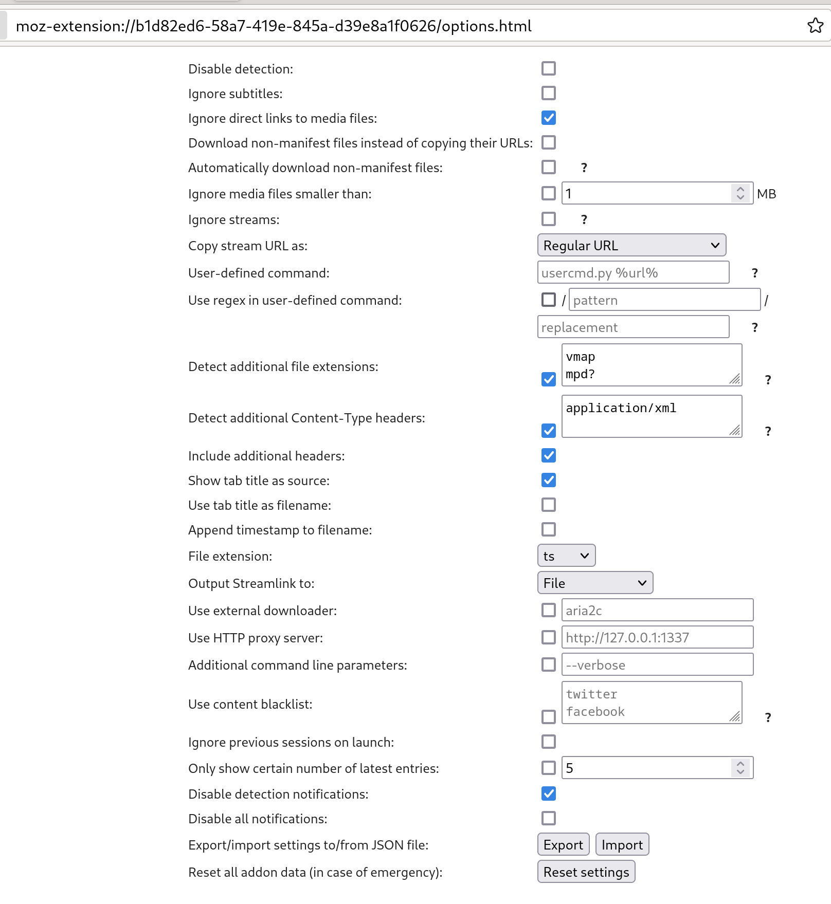

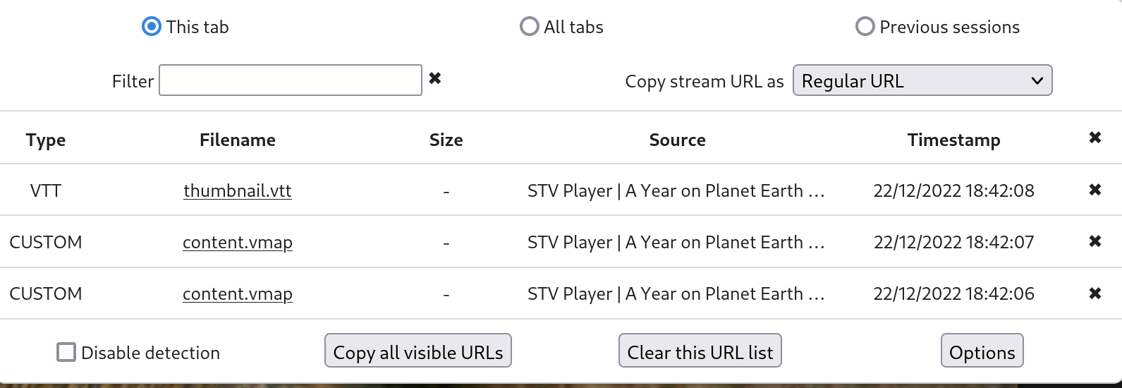

    A final vmapper wrinkle, for me anyway, is the adapting of The Stream Detector to actually search and find vmap links.
    In the Stream Detector plugin options I have set this:-
    [Attachment 68271 - Click to enlarge]
    which results in this:-
    [Attachment 68272 - Click to enlarge]
    And that really is all I know!

    [Attachment 68275 - Click to enlarge]
    Well would you believe it?
    The above manifest for https://player.stv.tv/episode/4aa8/banijay1-insouponnable is obtained from a short-form vmap - which I had thought was a kind of go-away message from stv. It isn't
    The vmap url when sent via python with headers gives a long form vmap which contains advert timings plus a content URI; in this case the URI is an MPD. If you use that with yt-dlp you get back what the OP was complaining about; many parts and some of them adverts
    BUT if you curl <vmap url> from a command prompt
    curl "https://ssaimanifest.prod.boltdns.net/playback/once/v1/vmap/dash/live-timeline/bccenc/6204867266001/7fb30a85-56ee-49f8-b645-900876e7c09c/56c0cd1c-63dc-4c7d-a61b-dc40ac54710e/content.vmap?bc_token=NjNhNWQ2ZWNfMDk5Y2E5ODgwNTk1NjlmYmNlYjZmNWRiMjU4YjkyNjdlODNjZmI5ODNlNTdiZTY0MGQzYjU4ZTk3NjY5YTE0ZQ%3D%3D&behavior_id=edbc4bd0-6a34-46f2-8055-45d823d66886&bp=615%2C1485%2C2221&cf=long_form&ci=Insoup%25C3%25A7onnable&pid=b402d70d471c3fdf7fd030da921342994c940c1747640230fece83a0d321c562&rnd=9252110242199054&s=player-programmes-lf-banijay1-insouponnable%2Cbanijay1-insouponnable&t=vp-banijay1-insoupconnable%2CEPID_BANIJAY1-FALL-FRANCE-101_stv-region%2Cstv-region%2Clong_form%2Cbrightcove&vht=1080&vwt=1920&_fw_player_width=1920&_fw_player_height=1080&vcid=10030753171810665055940761421550319354&vcid2=b402d70d471c3fdf7fd030da921342994c940c1747640230fece83a0d321c562&prof=stv_web&caid=banijay1-insouponnable-series-1-episode-1&csid=STV_PlayerWeb_VOD_stv-region&pvrn=1474624583004815&vprn=3141579870035678&rule=discos-enabled"
    you get back a short response that looks like this:
    <?xml version="1.0" encoding="UTF-8"?>
    <vmap:VMAP xmlns:bc="bc" xmlns:vmap="http://www.iab.net/vmap-1.0" xmlnssi="http://www.w3.org/2001/XMLSchema-instance" version="1.0">
    <vmap:Extensions>
    <bc:Brightcove ttl="3600" contenturi="https://ssaimanifest.prod.boltdns.net/eu-west-1/playback/once/v1/dash/live-timeline/bccenc/6204867266001/7fb30a85-56ee-49f8-b645-900876e7c09c/56c0cd1c-63dc-4c7d-a61b-dc40ac54710e/5a0b7b97-1a90-4e1a-85aa-b90826a8b060/content.mpd?bc_token=NjNhNTdmYjNfYjBjZjBjNTk3YjY1M Dk4ZTI3NzY1Y2NiM2QyYzJiMGFlYTJlNmZkM2NiMWVmNWRlZDV mODU5M2JmYjRiNGZiMQ%3D%3D" contentlength="3061.6400" payloadlength="3061.6400" contenttype="application/dash+xml"></bc:Brightcove>
    <bc:BrightcoveDebug sessionID="5a0b7b97-1a90-4e1a-85aa-b90826a8b060"></bc:BrightcoveDebug>
    <bc:thumbnailURL type="thumbnail" width="480" height="270" bandwidth="0">https://ssai.playback.eu-west-1.prod.deploys.brightcove.com/v1/thumbnail/6204867266001/56c0cd1c-63dc-4c7d-a61b-dc40ac54710e/low-res/5a0b7b97-1a90-4e1a-85aa-b90826a8b060/thumbnail.vtt?bc_token=NjNhNTdmYjNfZWQyN2VkYWYzYzY yNjg2MWQwNjc1MzQwODc1NTRiZDM4YTg2ZTk1OTRmMzExMTU0Y jJiZjQ3M2FhN2MxOTk2ZA%3D%3D</bc:thumbnailURL>
    </vmap:Extensions>
    </vmap:VMAP>
    AND if you take the contenturi (MPD) therein and give that to yt-dlp you get a download with single audio + video and no-adverts
    Who'd have thought it?

    Once installed configure with an additional filter set for 'vmap'.
    Under Options:
    'Detect additional file extensions:' 	set checkbox ticked and enter 'vmap' in box
    'Detect additional Content-Type headers:' tick checkbox and add 'application/xml' in box
    Now just visit any number of video pages at STV and the vmap urls will be listed by
    The Stream Detector. Copy the urls to the clipboard from 'The Stream Detector' window when finished selecting videos.
    This program ignores all the thumbnail (VTT) links - just leave them be.
