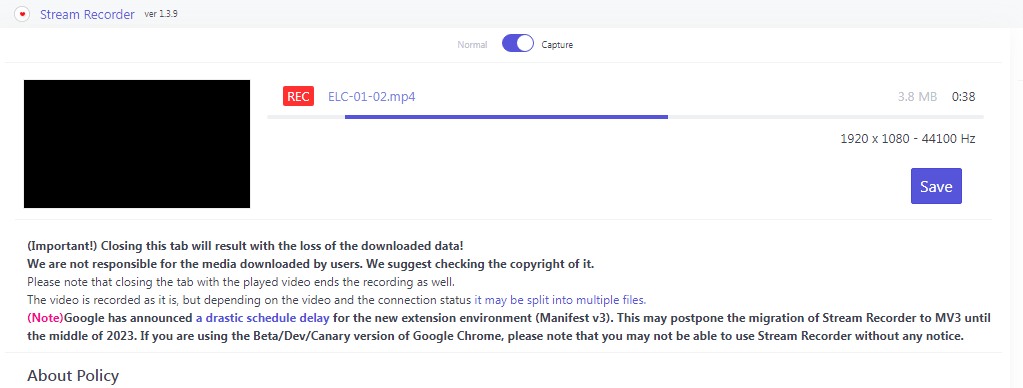

    obviously i've tested before write my post. and it work for me
    [Attachment 68213 - Click to enlarge]
