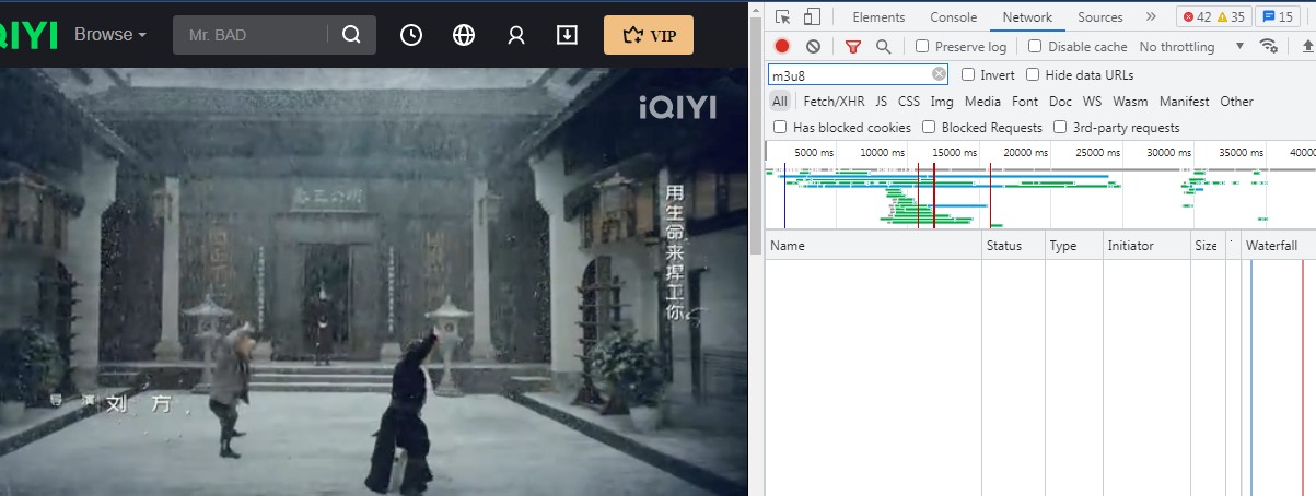

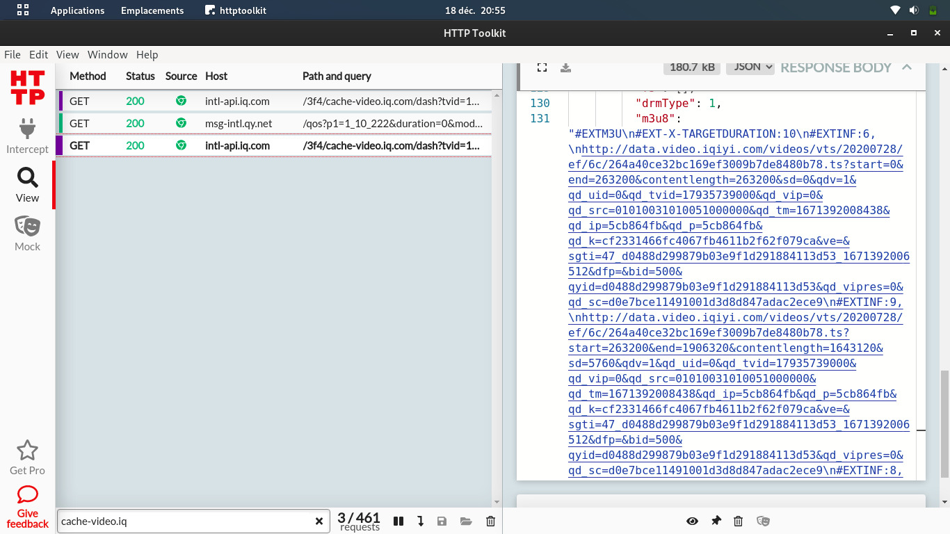

You can also find the m3u8 with Http Toolkit
[Attachment 68201 - Click to enlarge] -
weird. from dev tool no m3u8 but seem Http Toolkit can find m3u8 link ....

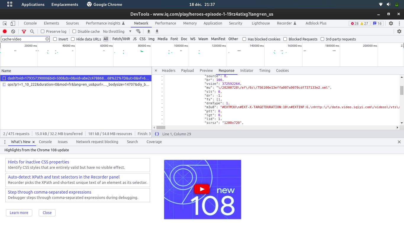

oh yes, you're right
with search "dash" on dev tool find on Response tab the m3u8
but this is impossible to use
[Attachment 68204 - Click to enlarge]

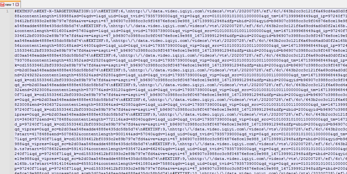

must be manually edited ...
more easy to do the zack trick (see my post#6)
anyway cedric thanks for your hint -
only way is make a good regex string for notepad++
but it would be a futile job, since zack has already done a great job -
Or use an unescaper:
https://appdevtools.com/javascript-escape-unescape
For notepad++ here are some good examples:
https://community.notepad-plus-plus.org/topic/12464/how-to-unescape/12
Best seems to be:
Code:SEARCH (?-i)\\(?:(a)|(x08)|(f)|(n)|(r)|(t)|(")|(')|(\\)) REPLACE (?1\a)(?2\x08)(?3\f)(?4\n)(?5\r)(?6\t)(?7")(?8')(?9\\)
