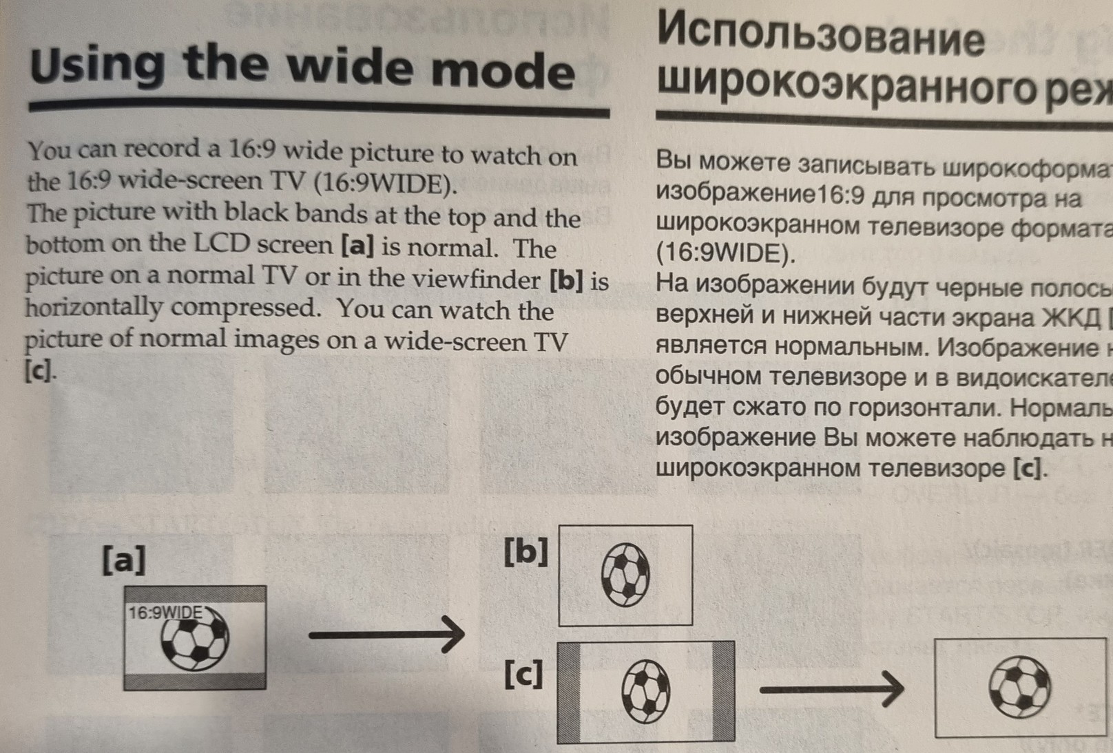

    I have Sony Digital8 SD camcorders that shoot in 16:9 and 4:3
    I think it was a con. Without firing up my Sony D8, I think you will find that the actual video width ie angle of coverage is exactly the same for 4:3 and 16:9. The only difference is that 16:9 would look better on widescreen TVs because there would be no black bars top and bottom. The page from the manual explains:
    [Attachment 68176 - Click to enlarge]
    Depends on a model. "Movie" mode on analog camcorders usually did what you say, a matted frame. Some DV camcorders did it too. But starting from early 2000s widescreen became a real thing with increased field of view. BTW, your example shows that at least the video was recorded as true widescreen, although the sensor may acquire image in matted form, losing resolution. This is what the DVX100 did, for example. But if instead of 4:3 interlaced you shot 16:9 progressive, it would still look better
