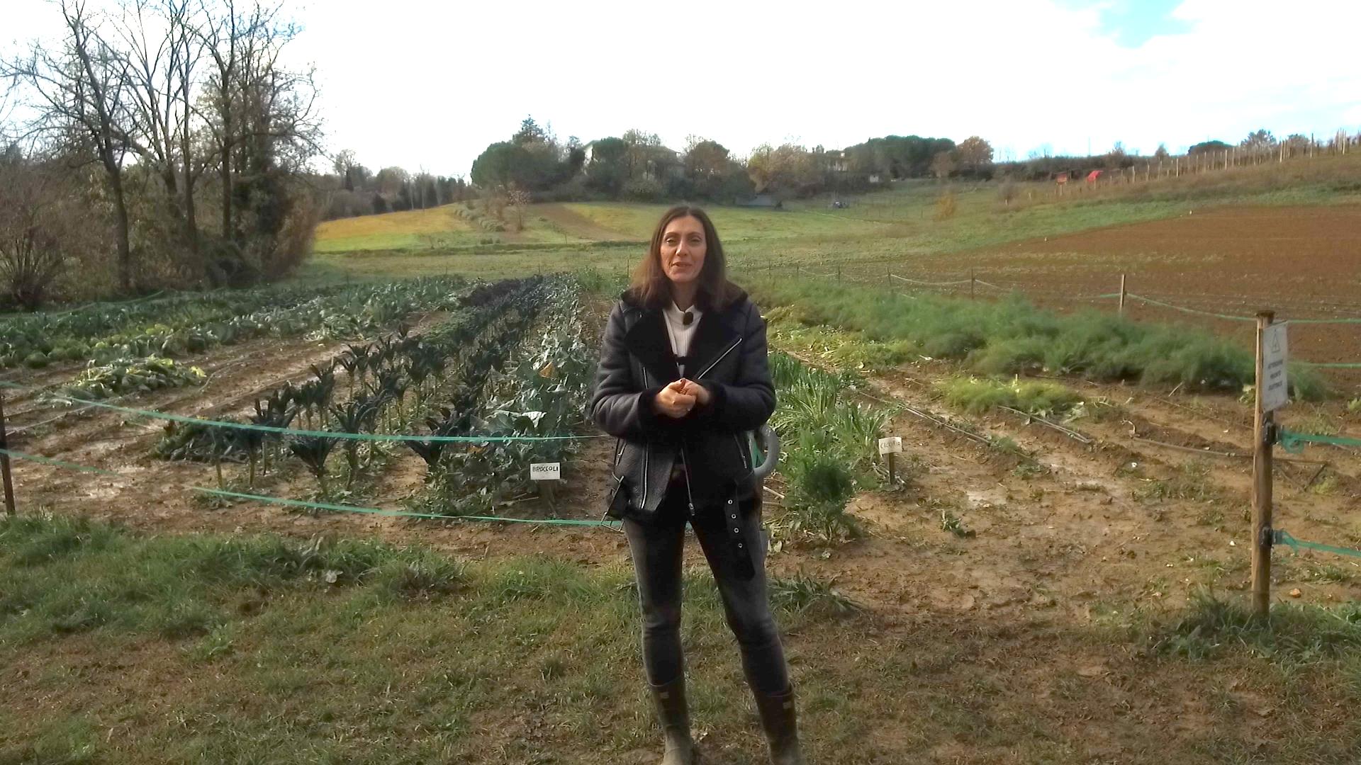

    however I have this DJI_0002.MP4 footage, underexposed, wrong shot, wrong color, all wrong.
    https://www.swisstransfer.com/d/3af0f130-1d7b-4919-85c6-a107758dc975
    I wonder if is there a way to "adjust" exposure/color/levels of the entire clip with a dynamic adjustment if as possible and in the limits of a postprocessing, keep as reference considering levels/color of another camera in the same interview, this:
    https://www.swisstransfer.com/d/93ab278e-765c-4682-ad98-7aed55133981
    thanks

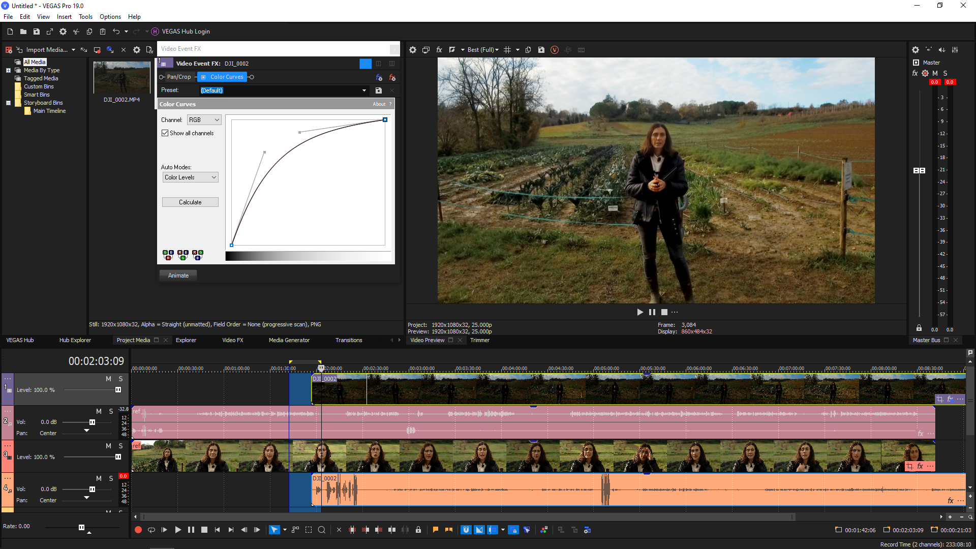

  2. I think you have a solid videoeditor now, not sure which one. You can do a fast fix using curves.

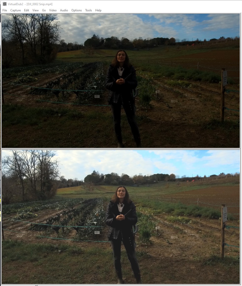

    Virtual Dub 2 with the Colormill filter. Mid levels boosted to 100, low up 25, high up 10, with a slight increase in saturation (up 13).
    [Attachment 68159 - Click to enlarge]

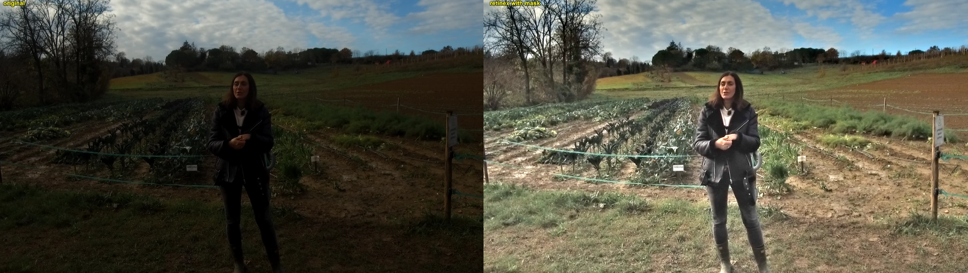

  6. Try Retinex or autoadjust (less flicker) for dynamic adjustments (just a quickshot, not optimzed)
    [Attachment 68161 - Click to enlarge]

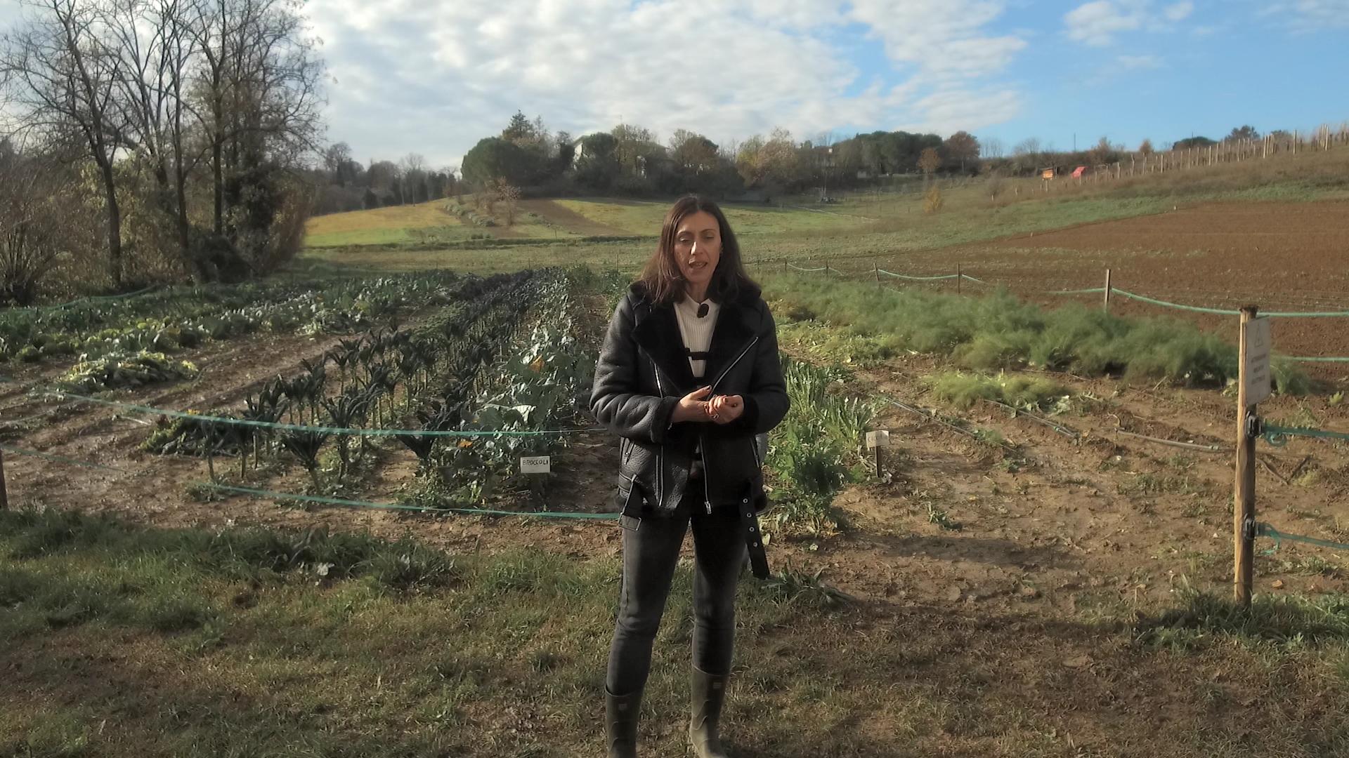

  17. Here's mt_lut() with a quarter wave sinusoidal adjustment, plus a little gamma and saturation with ColorYUV(). Frame 9000:
    [Attachment 68179 - Click to enlarge]
    A little like _Al_'s curve in post #2.

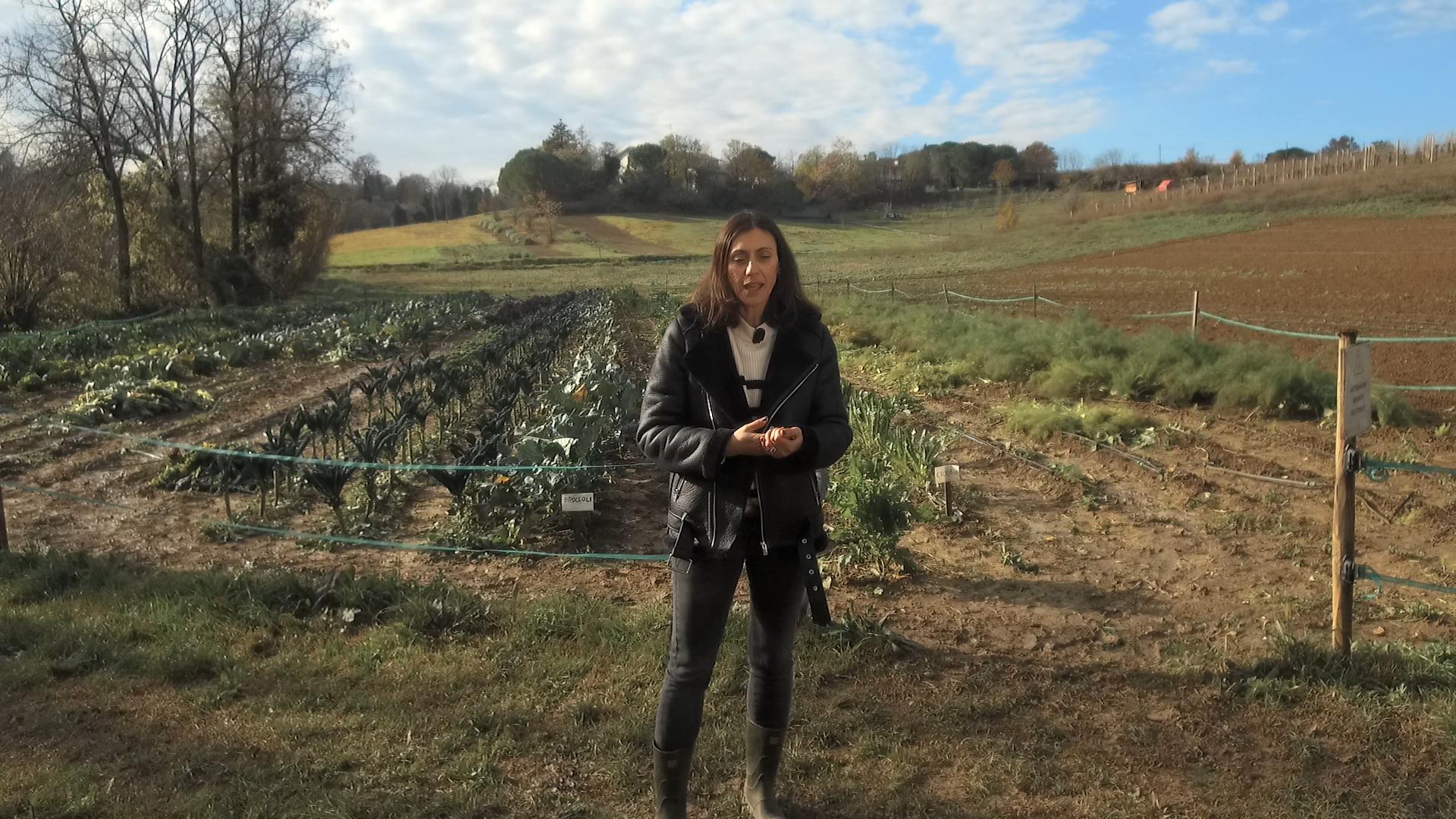

  20. Here's something very simple that doesn't require any third party filters:
    Overlay(last, last.ColorYUV(gamma_y=500), opacity=0.7)
    ColorYUV(gain_y=110, off_y=-80)
    [Attachment 68192 - Click to enlarge]
    The first line blends the original video with a gamma adjusted version. You can change the opacity to get more or less of the gamma adjusted values. ColorYUV on the second line is used to adjust the black and white levels.
