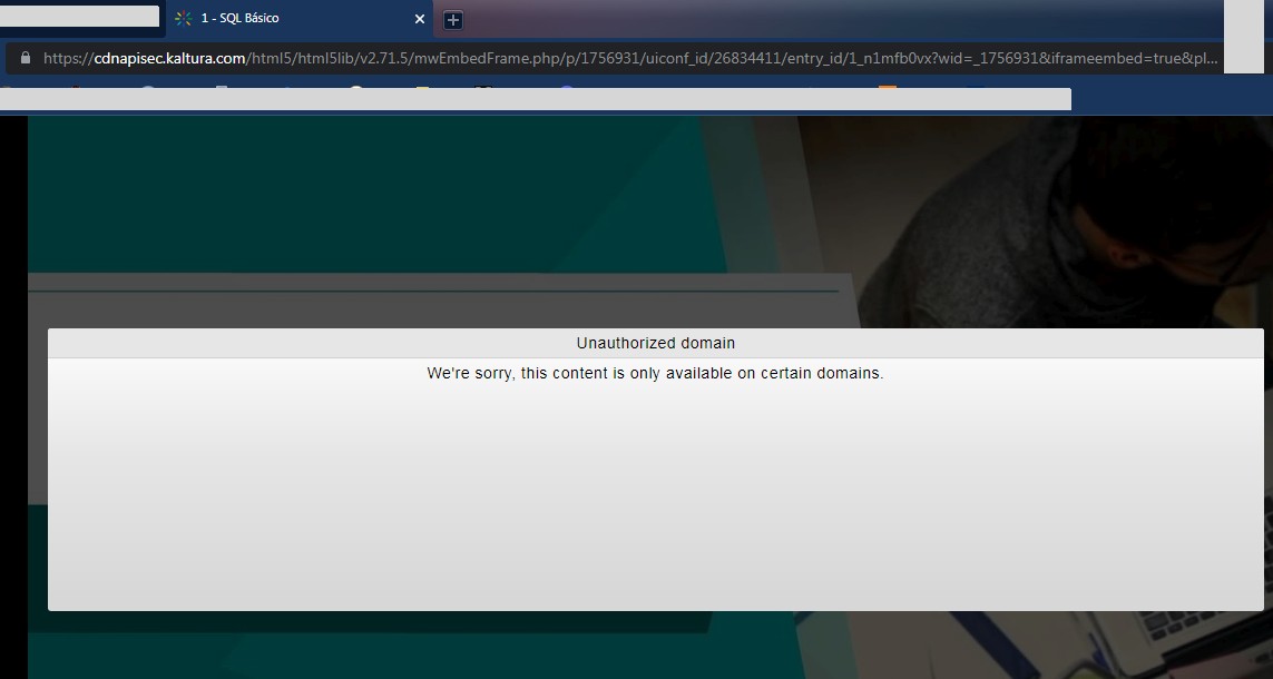

  2. need original video link. your link above is forbidden or expired. or need VPN ?
    [Attachment 68140 - Click to enlarge]
    This first Link sometimes keeps giving this message I believe VPN is necessary
    This second link is from another video and it's working.
    https://cdnapisec.kaltura.com/html5/html5lib/v2.71.5/mwEmbedFrame.php/p/1756931/uiconf_id/26834411/entry_id/1_xiyvdmze?wid=_1756931&iframeembed=true&playerId= kaltura_player_1530732653&entry_id=1_xiyvdmze&flas hvars[streamerType]=auto
  4. Originally Posted by HmWtmfv View Post
    need to use France VPN

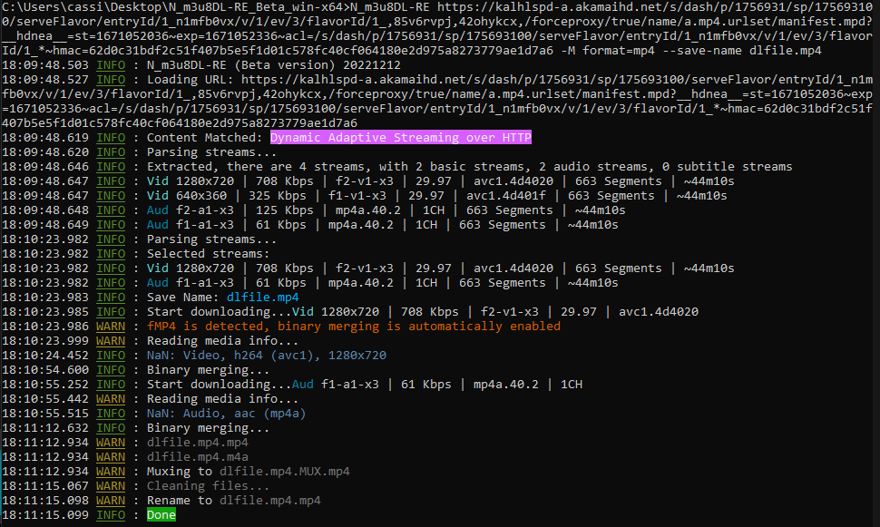

    N_m3u8DL-RE https://kalhlspd-a.akamaihd.net/s/dash/p/1756931/sp/175693100/serveFlavor/entryId/1_n1mfb0vx/v/1/ev/3/flavorId/1_,85v6rvpj,42ohykcx,/forceproxy/true/name/a.mp4.urlset/manifest.mpd?__hdnea__=st=1671029374~exp=1671029674~acl=/s/dash/p/1756931/sp/175693100/serveFlavor/entryId/1_n1mfb0vx/v/1/ev/3/flavorId/1_*~hmac=11baf8c2f8d4a670b2879ad5c6887e0a4ef3f3df4077896d0f239c2d7030df0b -M format=mp4 --save-name dlfile.mp4

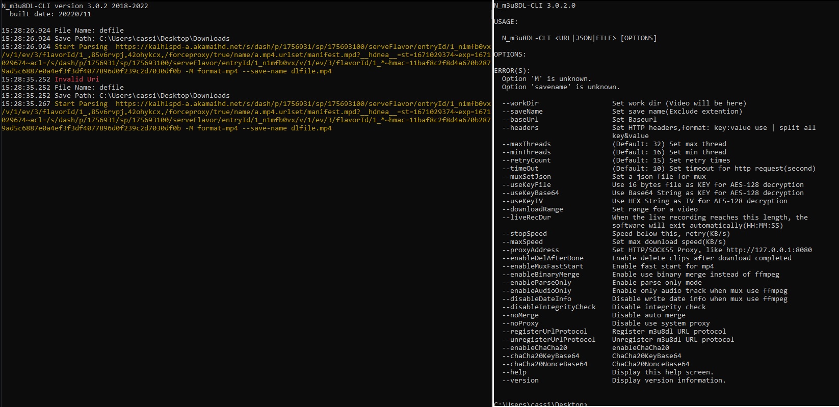

    the first is using the N_m3u8DL-CLI_v3.0.2.exe and the second in the prompt both have an error and do not download the video
  6. Use N-m3u8DL-RE
    https://github.com/nilaoda/N_m3u8DL-RE
    and you have to get a fresh link
    Use stream-detector Addon For Firefox to get a new link.

    Tks You All Guys for Help
