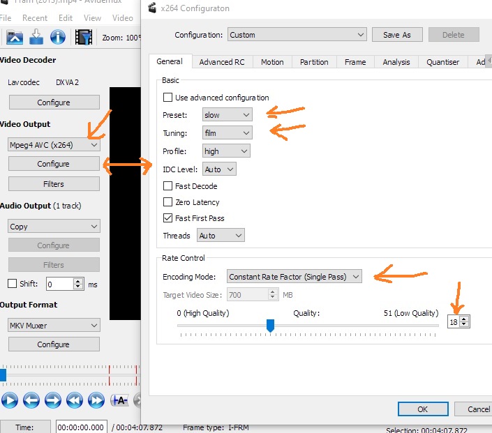

    If you're doing a lot of this kind of frame accurate trimming perhaps consider something like Tmpgenc Smart Renderer. ($$ but with free trial)
    It encodes only the GOP you disturb
    Since you already occurred a quality loss by using Youtube, may as well set up Avidemux to encode the whole file,
    first make all your trims on the frames you want then set it up like this and encode the file
