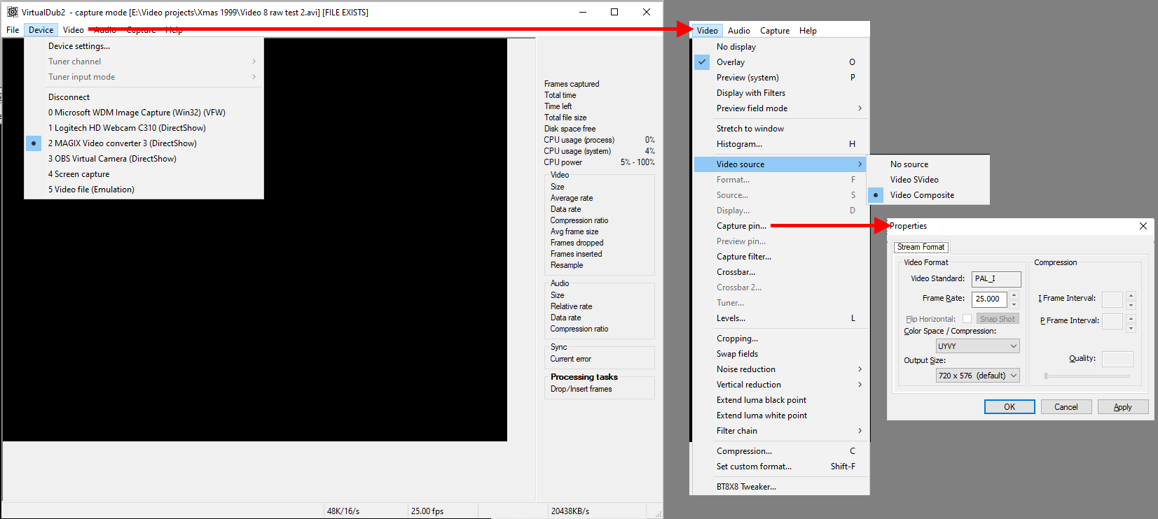

  1. After a long discussion in the Newbie forum I decided (admittedly against advice) to try capturing my Video8 tapes with a MAGIX USB device and Vdub on Windows 10. I downloaded the latest drivers from the MAGIX site, connected the camcorder and started Vdub, working through the device and video setup menus as documented. No video preview appeared, just a black window in Vdub. At this point the tape was stationary and I had expected to see the idle blue screen on the video feed. So I started the tape and still no video preview. Quitting out of capture, I opened the target file to find it was not zero length. Hitting play, there was no video throughout the file but there was audio from the moment I had pressed play on the tape.
    Here's a screen capture montage of my Vdub config:
    [Attachment 68082 - Click to enlarge]
    After that, I tried selecting Microsoft WDM Image Capture. That produced video but no audio.
    The full system is:
    Sony Handycam DCR-TRV120E (PAL)
    MAGIX capture device model K0065
    Windows 10 Home, build 19044.2251
    running on AMD FX-8350 8-core 4GHz 8GB RAM
    Am I missing something straightforward, or is the MAGIX driver just not doing its job?

    The lack of the preview etc. may well be down to a Windows Security setting rather than a VDub one.
    Read this:
    https://support.microsoft.com/en-us/windows/manage-app-permissions-for-your-camera-in-...ion=Windows_10

    Instead of Overlay, try Preview (System).
    Lordsmurf always recommends VDub 1.9.11 for capturing, not VDub 2. Down the page a bit:
    https://www.digitalfaq.com/forum/video-conversion/1727-virtualdub-filters-pre.html

    Apart from my earlier comment (which I read about in these hallowed pages) I have no experience with Win10 - and few would recc it due to its notoriety in 'killing' capture devices (again read here)
    Both Overlay and Preview work on my Win7 system as does the VFW and DirectShow - actual capture only tested with DirectShow whereas for the OP in appears that only VFW works.
    I do not see an audio setting (should typically be 'Capture Device')
    The only advantage with Vdub2 are the ffmpeg-based codecs but I do not detect the OP using any.
    I would also consider AmarecTV as an alternative capture program - less of a hassle to set up than Vdub

    Investigated that. All permissions were set as required. VirtualDb2 was listed as one of the desktop applications (don't you hate "apps"?) with camera access.
    Useful steer, thanks. I've downloaded the package for future trials, but I don't need it right now because ...
    BINGO! (or 'House!' or 'Keno!', depending on your vernacular). Instead of 'Capture Device', the audio setting had defaulted to the 'MAGIX Video Capture 3', explicitly the same device as selected for video. Changing this to 'Capture Device' unlocked the video capture stream. Who'd have thought it? (Well, DB83, obviously) I guess the two capture streams were contending for the same output, rather than the audio stream connecting to the audio output.
    So, now I can preview and capture video and audio. Now I only have to figure out deinterlacing, sound sync, dropped frames ... ... ... but that's all for another thread.
