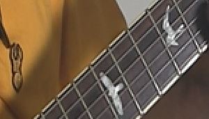

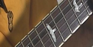

    Nice and better but I can still see the flicker there. However, what strange is that I checked the video frame by frame zoomed in, and on the frames no flicker error could be caught. What I am talking about as flicker is that the color of the strings change sequencially as the movement goes on, but it can also be seen at other places, like around the guitar. As if there would be a ghost image appearing and disappearing for a moment. But if you check the frames, they are perfect, no error, but as soon as you speed up jumping the frames, even just manually, by pressing the forward button fast, the flicker starts appearing. I noticed something that may be the source of it, not sure though. If you zoom in, and go frame by frame, very often you can observe that the sharpness of the stings for example, goes in and out of sharpness. Sharp dull sharp dull. I think the constant changing of this results in the perception of the flicker in my case. I took photos of 3 neighbouring frames. You can see this what I try to explain: the sharp and dull change. Could this be omitted somehow?
    Image Attached Images
  12. Your screen caps appear to be poorly deinterlaced. Try turning off the deinterlacer in your player (the video is encoded interlaced but the frames are progressive). Or changing the deinterlace method.
    But basically, you have vibrating strings on a moving guitar, a camera that's oversharpening the video, and encoding interlaced. Of course the strings flicker a little on playback!
  13. The "ghost image" or "in and out of sharpness" is mostly motion blur - it's a normal phenomenon. The slower your camera shutter the more blur . The faster the motion (object or camera) , the more blur.
    Shutter speed is usually indirectly affected by FPS on most cameras . Shooting at a higher FPS will usually have a faster shutter setting (you're recording at 25FPS, the normal shutter would be 1/50. Shooting 50FPS, the normal shutter speed would be 1/100) . So if you can , shoot a higher FPS, and have a manual setting adjust the shutter speed even faster, you will reduce that effect. A high speed camera would eliminate the blur completely
