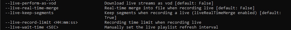

  4. theses options are for recording
    -Download live stream as VOD
    -Merge into FILE
    -Keep segment when Recording
    -Recording Time Limit
