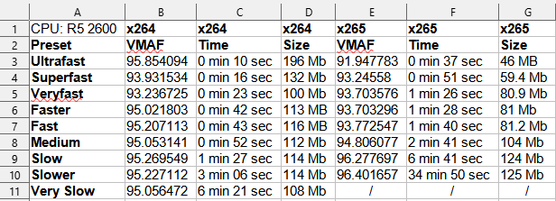

[Attachment 68056 - Click to enlarge]
From the screenshot the file size to quality (VMAF) between the two is roughly the same, especially the slower the preset goes, even though the encode times have increased. This is the opposite of what I expected. It seems there is a noticeable difference in the Superfast file size for seemingly the same quality (at least in this specific clip), but people usually recommend a lot slower presets. Obviously I have to be missing something here, I'm assuming the common notion that you get the same quality at a smaller file probably has something to do with custom arguments? Or maybe just one test file doesn't give representative results? I guess now that I'm looking at everything maybe I would get a smaller file size if I ran the encodes with a fixed bitrate? Any clarification would be appreciated.

I'm comparing encodes of the same clips, not between different films. While I've posted one example of the second comparison, I actually tried multiple encodes and could never ever get the bitrate to go down as low as the group release (again, encoding the same film), even in the most non-intensive scenes, including in direct scene comparisons. So I know that more intensive scenes take more bitrate. The question I'm asking is why have same settings for the same film/clips given vastly different end result in terms of bitrate/size?
Any way to equalize the CRF's between the two then? Or for a direct comparison you just have to use average bitrate encodes? Also doesn't the comparison that shows the same relative VMAF quality mean that the CRF's also work roughly the same in terms of output?
I still don't get if my notion of same relative quality but smaller file size is just wrong, or I should be doing something else in the encoder if I want to achieve this. If you get roughly the same results as x264, why even bother with x265's higher encode times? -

I'm assuming this also applies for Handbrake/StaxRip?
Also why does the VMAF stay the same for the same CRF value then? Wouldn't a CRF28 x265 give way lower VMAF compared to CRF23 x264? -
I did another quick comparison, encodes of the same clip:
x264 10-bit, Preset: Medium, CRF 23, VMAF = 89.6720
x265 10-bit, Preset: Medium, CRF 28, VMAF = 84.7396
So it doesn't seem that the quality remains the same. It's even obvious just looking at the clips, for example the x265 encode has completely removed the noise, while it is still kept in the x264 one. -
