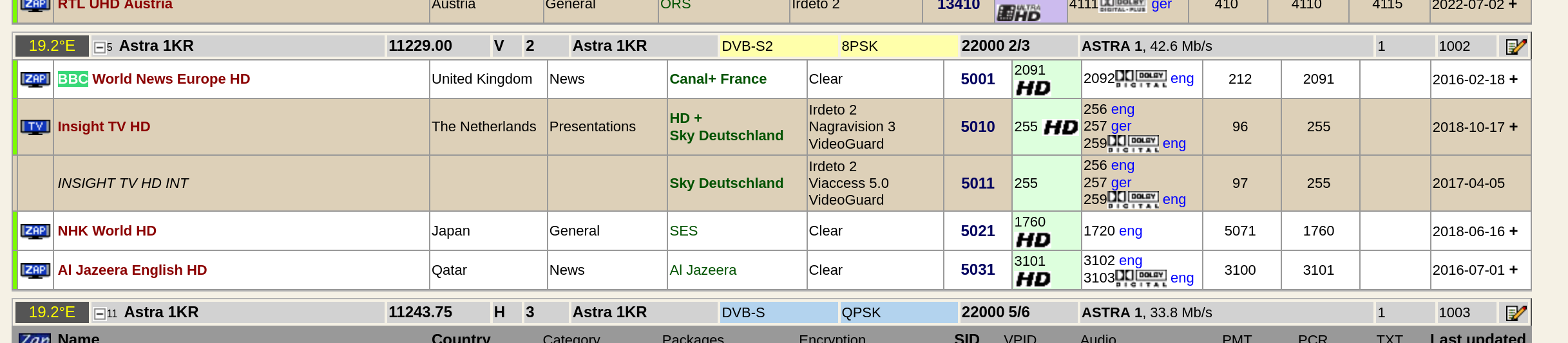

If you have Sky, you might be able to adapt your satellite dish to receive another satellite from European satellites broadcasting on 19.2E. That's 9 degrees of separation from Sky channels on 28.2E, enough to fit another LNB (low noise block) at the focus of the satellite dish. The dish would need re-aligning. I see you are in Brussels, and that is well inside the footprint of 19.2E and your existing dish may well work. I am on the UK's South coast, slightly outside the footprint, and have a dual LNB on a 90cm dish. I installed it myself; simple enough to do. You would need another satellite box -Sky won't tune - but a cheap one from AliExpress can be had for under £100 when I last looked. I have an unused one since I went to a 4k receiver and am happy to give it away. PM if wanted. Then you can receive all the free to air European programmes see https://en.kingofsat.net/pos-19.2E.php and the image below
[Attachment 68042 - Click to enlarge]Last edited by A_n_g_e_l_a; 7th Dec 2022 at 09:06.

I've happily used this supplier for kit https://www.hm-sat-shop.de/ and a they and others like them will have all you need for another small dish pointed at Astra 19.2E. All the programmes on a white background on the kingofsat site are free to air. All you need is a dish, an LNB, 75 Ohm satellite cable, F-connectors and a tuner. Pick up all that off eBay I wouldn't be surprised. But your local aerial guy will do with his eyes closed. Or take a feed from a neighbour? A dual LNB - one feed to them and one to you from the same dish. Depends on the kind of house/apartment you live in. All you would need then, apart from a fiendly neighbour, is the tuner and to pay for a dual LNB.
