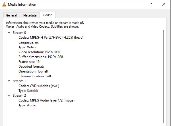

    I tried playing it in VLC and it does play the video, but without audio.

    I am attaching a screnshot of the codec information from VLC.
    I don't really know how to go ahead and convert them.

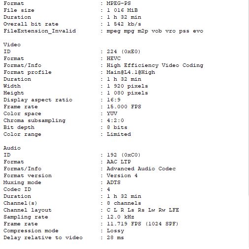

    MediaInfo
    [Attachment 68023 - Click to enlarge]

    re: the audio, There are very few players that can handle 8channel AAC, so no surprise there. Unless you have a specific need for surround, it makes more sense to change their settings in the DVR to stereo (2ch) or mono (1ch). Security/surveillance footage rarely would need more than that.
    The spec is odd, in that most of the time when encountering HEVC/h265 codec, it is usually in an MP4 container file format, while this is in an MPG one (even if it isn't labelled that).

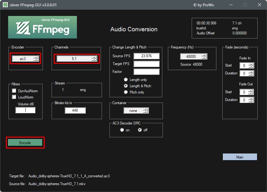

  5. You can try clever Ffmpeg-GUI.
    Load your file, click main, click encode audio stream, click go to the encoder, set encoder and channels like in the picture, leave all other settings as they are, click encode.

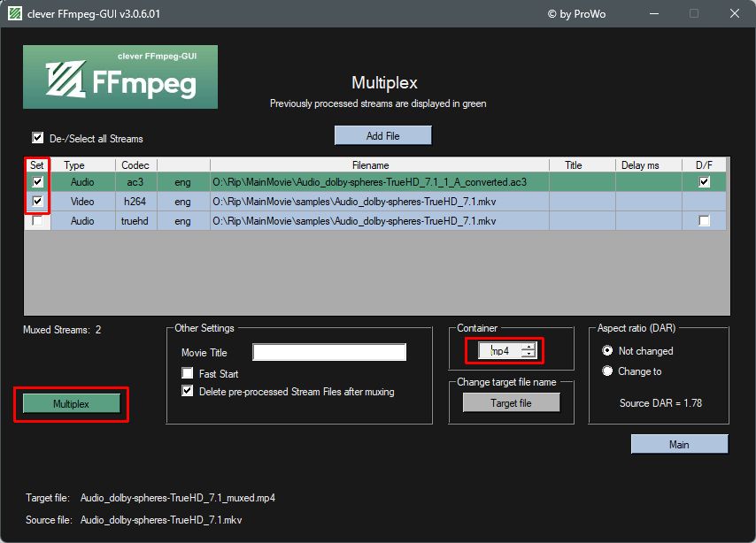

    [Attachment 68151 - Click to enlarge]
    Then click multiplex, the new created audiostream is shown in green, check it and the videostream, uncheck the original audiostream shown in blue.
    Select mp4 as container and click multiplex.
    [Attachment 68152 - Click to enlarge]
    Done.
    Try to play the new created mp4 file (in the target folder) with VLC.
    Done.
