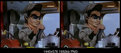

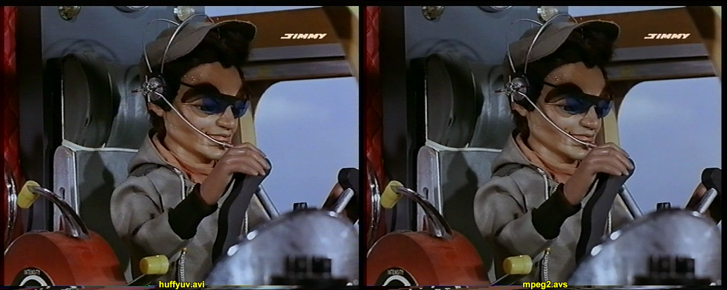

    Although not recommended (and I never use it), if your tapes are in good condition and you have a high end S-VHS VCR with lineTBC and Y/C output, a MPEG-2 live capture with the Hauppauge USB-Live 2 is not bad.
    Here a small video with a comparison between two segments of the same tape captured with lossless HuffYUV and with Hauppauge Capture Software using MPEG-2 at 10Mbps, which is slightly out of specification for DVD, but it can be reduced a little bit in the settings of the capture software. The format is transport stream (TS) but it can be translated easily to MPEG-2 PS (program stream) for DVD creation.
    compare_huffyuv_mpeg2.avi
