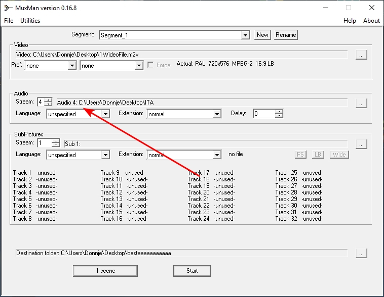

    I enable audio 4 by loading the ITA language file

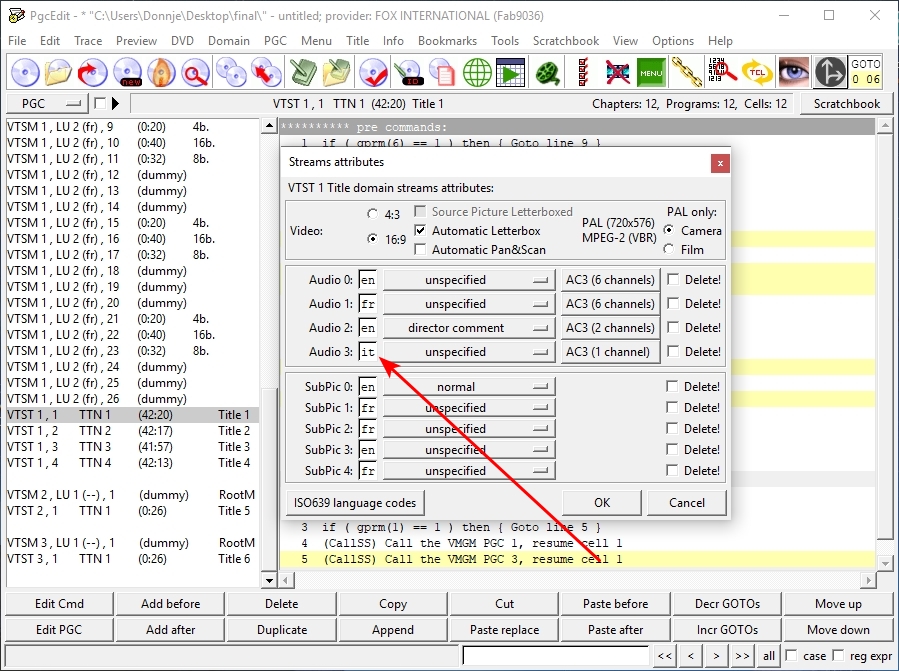

    then I insert the suffix it
    [Attachment 67978 - Click to enlarge]

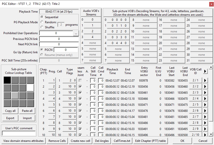

    If add directors comment as number 2 and ITA as number 3 the 3 becomes silent and the 2 starts in ITA, it's getting messy
    [Attachment 68020 - Click to enlarge]
    if I disable the direct in 2 and put the ita there, you can't hear it
    [Attachment 68021 - Click to enlarge]

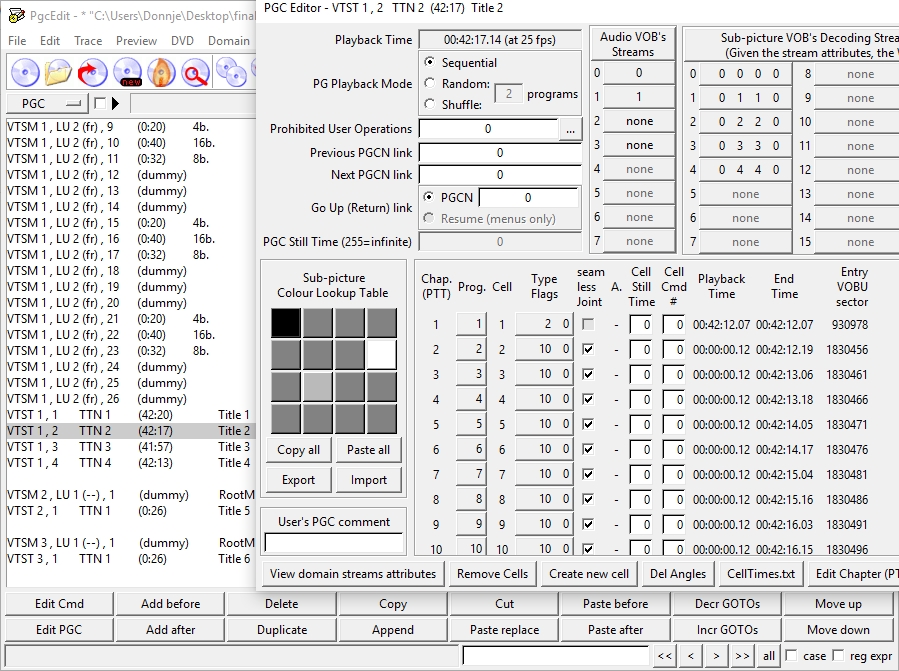

    for episode 1 i have:
    audo 0 = en
    audio 1 = fr
    audio 2 = en direct
    audio 3 = ita

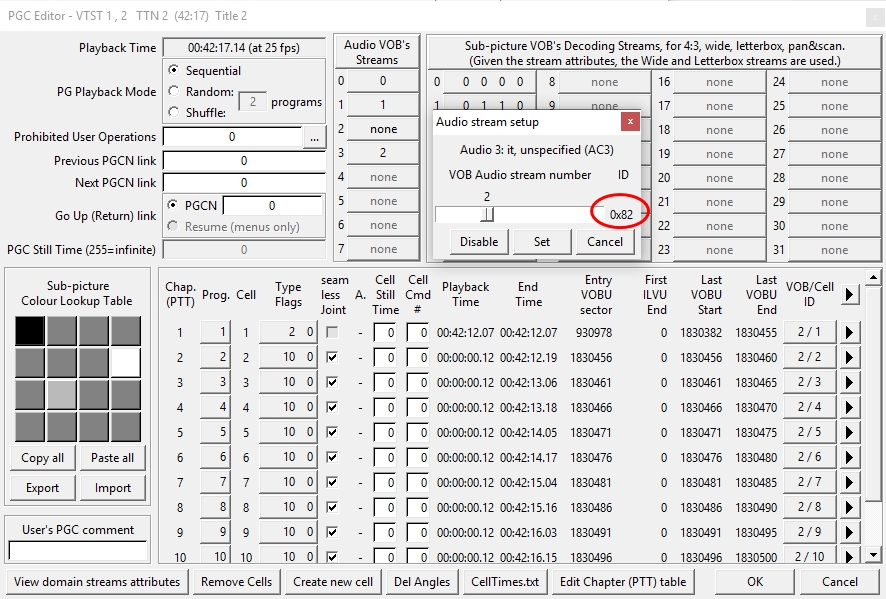

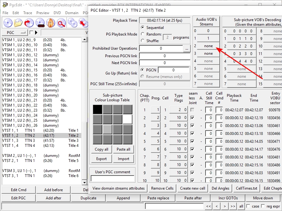

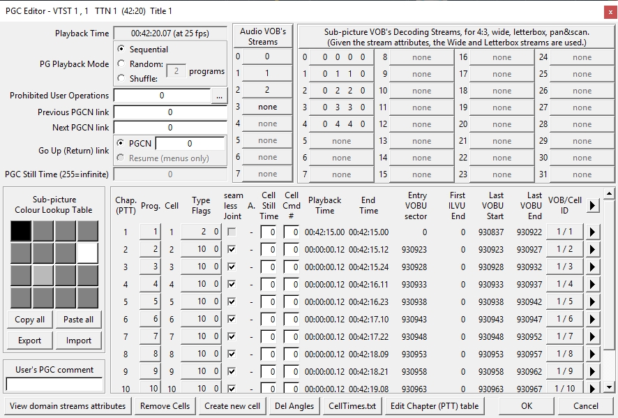

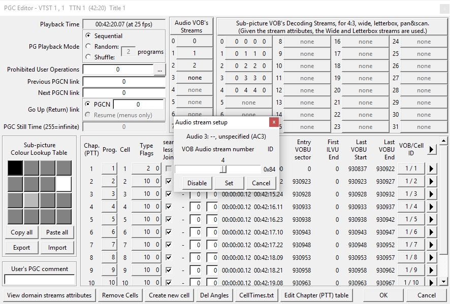

    [Attachment 68006 - Click to enlarge]
    on PgcEdit he only sees the first 3 (0 - 1 -2 )
    [Attachment 68007 - Click to enlarge]
    I have to put the ITA so I think I have to insert on channel 3 the number 4
    [Attachment 68008 - Click to enlarge]
    as in MuxMan
    [Attachment 68009 - Click to enlarge]
    instead I realize that it works only if I insert the number 3, why?

  8. Member Skiller's Avatar
    Oct 2013
    Germany
    OK I understand.
    Since the number of audio tracks differs between episodes, I advice you to create one MuxMan "DVD" for each set and then combine them accordingly in VobBlanker. So if episode 1 uses 4 audio tracks you make a MuxMan DVD with just that first episode, and then make another MuxMan DVD with episode 2 which uses only 2 audio tracks.
    Edit:
    Numbering of tracks in PgcEdit starts at zero, so this is normal.
    You just need to change "none" into (for example) 3.
  9. First of all guys @Skiller @ProWo for your patience
    finally I understood the logic I had to consider in the attribution of the audio channel not the number set on MuxMan but that for example 0x82 stood for AudioFile_82.ac3
    Thanks a lot
    [Attachment 68032 - Click to enlarge]
  10. Don't forget to also verify the track attributes. Right-click on the PGC in the left pane of the main window, and select "Domain track attributes". All audio streams for that domain must be defined here as well, and have the correct attributes.
