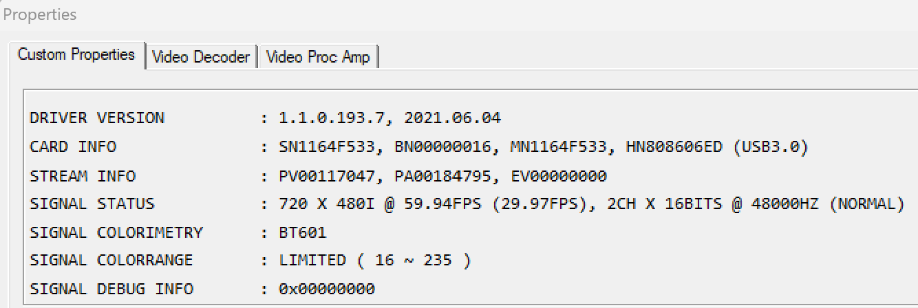

My issue is that while the capture driver is telling me the signal color range is "limited 16-235" the VirtualDub histogram indicates there are values above and below acceptable values.

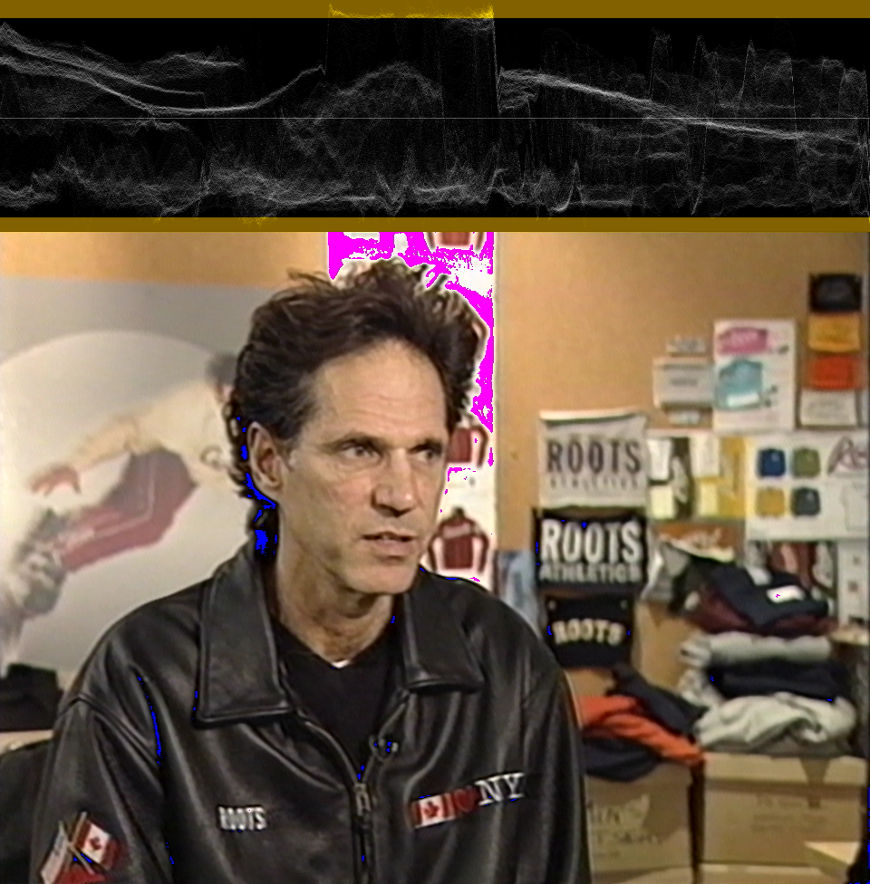

If I run the capture through AVIsynth using the following script, I get output with highlighted areas that are outside the limited values.
Code:video="D:\VHS Captures\StarTech Test 3.avi" SetFilterMTMode("QTGMC",2) FFmpegSource2(video, atrack=1) AssumeTFF() QTGMC(preset="Faster", EdiThreads=5) TemporalDegrain2(degrainTR=1) # in YUY2 Spline64Resize(960,720,6,2,-6,-6) Prefetch(18) TurnRight().Histogram().TurnLeft() Overlay(last, BlankClip(last, color=$0000ff), mask=mt_binarize(15).Invert()) # highlight Y<16 with blue Overlay(last, BlankClip(last, color=$ff00ff), mask=mt_binarize(235)) # highlight Y>235 with magenta
[Attachment 67965 - Click to enlarge]
The histogram shows actual data below 16 and above 235 so it doesn't look like those values have simply blown over and disappeared. Is there a way to convert using AviSynth to get the data back into the proper range? Or does it even matter.. is my capture fine? End goal is to play back on a computer or upload to YouTube, and my understanding I don't really want limited colour values for that.. or do I? Please help me understand the whole YUY2 vs RGB and limited color space thing, and am I capturing the correct signal or should I be doing something different?
