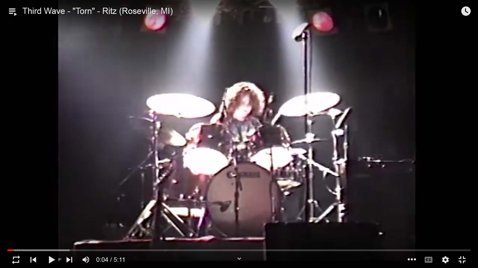

    Alwyn and DB83,ing
    Thank you both for your very informative input. I've attached two screenshots from a YouTube video containing a bass drum. The source material is VHS, recorded to a standalone DVD recorder. The 720x480, 4:3, NTSC (0.9) project was exported to a 1280x720, 16:9, NTSC, square pixels (1.0), H.264 file. I did add a mask to the bottom to obscure head switching, and also to the sides.
    The bass drum still looks perfectly round in 16:9. What are the previously mentioned distortions I should be on the lookout?

  8. The active picture in both of those images is 4:3. If one of them was encoded as 16:9 black pillarbox bars were added to convert the 4:3 frame to a 16:9 frame.

    Arh Ha. You've/Premiere has exported your video with black pillarbox bars on the side to fill out the 16:9 screen. These days, that's not recommended because all players I have used recently will correctly display a 4;3 video. In other words, they will fill the screen top/bottom and automatically display black side bars. You do not have to hard-code them in.
    As far as YT is concerned, it will display the video exactly as it is with no filler borders; YT doesn't care if it's 4:3, 27:2, or 1:1.
    In the YT the band, the black side bars are hard-coded into the video, and that is why YT is showing it.
    My recommendation is to export as 4:3. Whatever player you're using (or YT) will add borders as necessary to fill in the sides. Avoid using "stretch" (or similar) display mode.

    DB83, I was mistaken. The resolution I mentioned should have been 720x534, and not 720x537.
    I exported this music video specifically for YouTube as 1280x720 HD in order to get the higher audio bitrate than it would have gotten with a SD upload. I think that may be moot now, since YouTube has since removed the 'HD' designation from 720p content. The pillarboxes are baked in, as I knew that YouTube would add them anyway if I had uploaded the video as 4:3, and played it in fullscreen mode.
    In a nutshell, I was primarily concerned with the active window, which appears to be correct. The pillarboxes would be there no matter if 4:3 or 16:9 when viewed fullscreen. Since my current project is going to someone else and needs to be compatible across multiple devices, I will export it as 720x540, 4:3.
