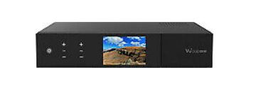

    Here is the VuPlus Duo 4k PVR
    That's one of mine, wonderful machine. It is a shame that Vu+ has discontinued all cooperation and support to the BlackHole Team, and they stopped the non OpenBH releases. Things may change in the future, we hope.
