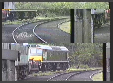

    Hoping someone can give me some advice on how to make my old 8mm imports better and answer a few questions.
    I am using an old 8mm camcorder (Canon) and a Video-2-pc import device.
    I am importing using VirtualDub using the following recommended settings
    Settings.
    Device → select EM28284 USB video device (DirectShow).
    Video → Video Source → Video Composite.
    Audio → RAW Capture Format → PCM 48000Hz Stereo 16 bit → OK.
    Audio → select Line (EM28284 USB Audio).
    Video → Capture Filter → Video Decoder → Video Standard → PAL_I → tick VCR input.
    Video → Set Custom Format → Frame Size 352x288 (slow PC) or 720x576 → Data Format YUY2 → OK.
    Video → Compression → YUY2 (uncompressed or slow PC) or X264VFW (dual core 2.8GHz+ box for live capture).
    Video → Capture Pin → Frame Rate 25.000 → Apply → OK. (if you're in the UK, capturing PAL video).
    (make sure Audio → Enable Audio Playback isn't enabled, otherwise you'll drop frames)
    I keep getting a horrible flicker on it - See the screen grab (I managed to put the clip in Vegas and when playing it pause it just at the right moment and clip the image). .
    IS there anyway to not have it during import?
    Or edit/remove it.

    Where does one start ? (and the 'fuzzy' line at the bottom of the screen is the least of your problems or have you not heard of head-switching noise ?)
    Sorry to appear uncharitable but this is a shambles.
    1. your original source would (or should) have been 720*576. How on earth have you ended up with 720p video ?
    2. Your original source would have been interlaced. Now you have low bitrate progressive.
    Methinks if you did nothing after the capture to produce this then go back and try the following.
    1. You need a lossless codec such as lagarith or hufyuv. (virtualdub2 supports the ffmpeg port of hufyuv out of the box)
    2. Capture as 720*576 with no editing after.
    3. Upload a short sample of that as an attachment
    Someone else will probably comment on the actual capture device which, itself, might have contributed to your issues.

    The mp4 clip I uploaded was done using Fix.video Re-Encoder due to the Avi the Virtual Dub created being too big.
    I've never heard of head switching noise and I never had the issue when I transferred to old Videos (VHS) from the 8MM tapes.
    I've now downloaded the VirtualDub2, I'm guessing the same settings I previously used in the previous VirtualDub?
