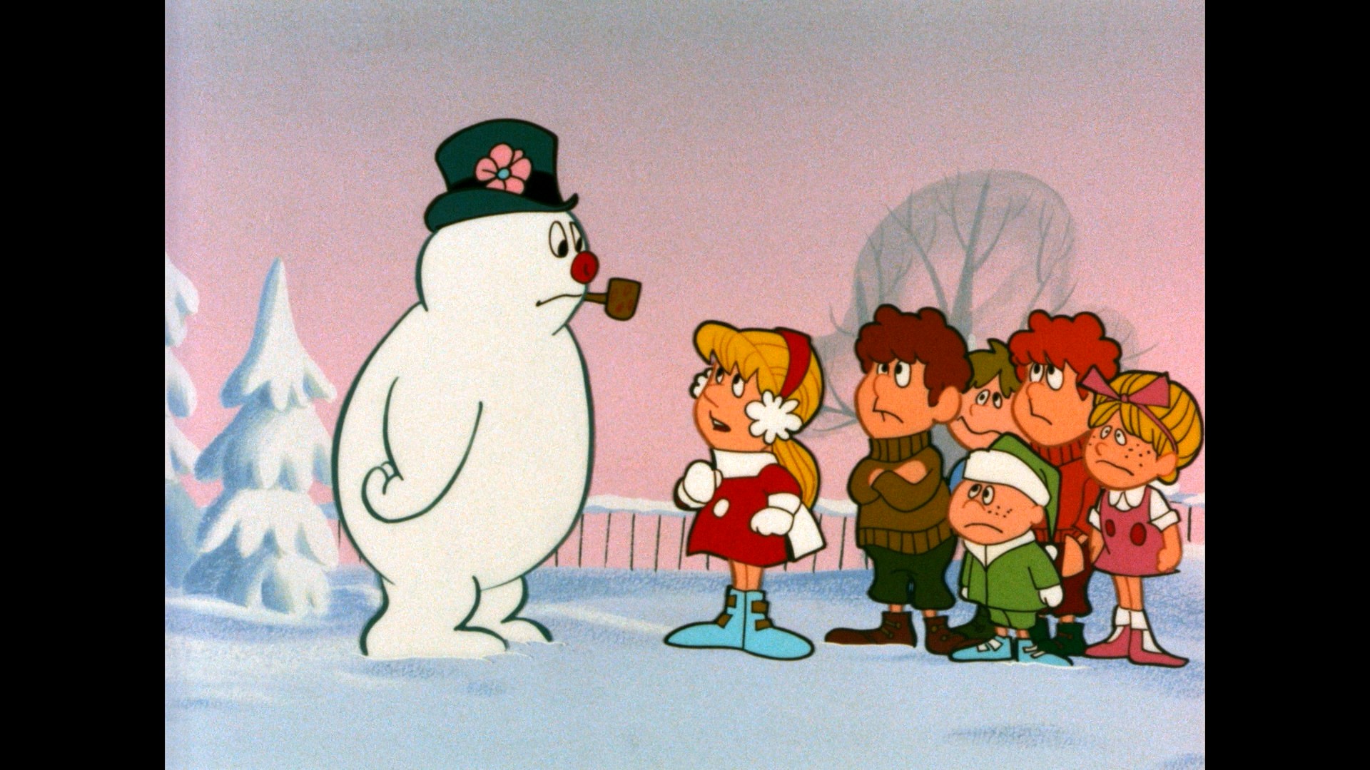

  1. I bought the new 4K release of this movie. It's certainly better detailed than the old Blu-Ray, but the old blu-ray looks so much more lively, or less dull. It's whites actually look white, instead of a duller greyish color.
    The old one is certainly oversaturated and overblown, but is there any way to make the duller looking 4K restoration a bit brighter, and more colored looking like the older Blu-Ray release?

  5. To get the warmer and bright whites, and darker blacks, in the second pair of images:
    RGBAdjust(r=248.0/202.0, g=241.0/204.0, b=230.0/206.0)
    Since your images imported as RGB I could use RGBAdjust directly. You'll have to convert your YV12 source to RGB, RGBAdjust, then convert back to YV12.
    [Attachment 67905 - Click to enlarge]
    Getting the other colors to match will be very hard in AviSynth.

  7. Do you happen to have any idea why RGBAdjust seems to be eating away or thinning black lines? Most noticeable on reds and oranges. The ColorYUV and YLevelsS dont seem to affect them.
    I realize its going through conversions, but can I stop that or lessen the extent of it?
    https://slow.pics/c/rRXj1cyQ
    https://slow.pics/c/U6PlrAuE
  8. Raising the gamma (rg=1.20, gg=1.20, bg=1.20) makes the dark edges around the black lines lighter. That makes the lines look thinner.
    [Attachment 67908 - Click to enlarge]
    Oops, I noticed that I left out a line in my earlier RGBAdjust() suggestion. It should have read:
    RGBAdjust(rb=-24, gb=-24, bb=-24)
    You'll probably like that better.

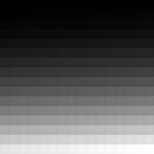

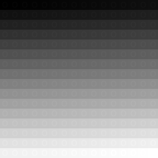

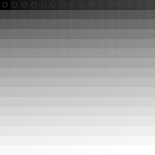

  14. Yes, raising gamma increases the contrast in the dark areas and decreases contrast in the bright areas. In other words, it brings out dark detail at the cost of less bright detail. Decreasing gamma does the opposite.
    In this image the letter O appears in each 32x32 block. At the top left the background of the box is at RGB=0, the latter at RGB=4. As you move to the right the letter and the background increase by one unit (background 1 letter 5, background 2 letter 6, etc.) Each successive row increases everything by 16, up to a background of 255. You should be able to see all the letters except the few brightest ones (where the letter is clamped to 255 rather than being 4 units higher than the background).
    source:
    [Attachment 67953 - Click to enlarge]
    RGBAdjust(rg=2.0, gg=2.0, bg=2.0):
    [Attachment 67951 - Click to enlarge]
    RGBAdjust(rg=0.5, gg=0.5, bg=0.5):
    [Attachment 67952 - Click to enlarge]
    In the gamma 2.0 image you can see the letter more easily against the background in the dark areas (ie, more contrast in the darks) but the bright letters are less visible (ie, less contrast in the brights). In the gamma 0.5 image it's the opposite. In both cases blacks stay at 0, whites stay at 255.

    Update: After tinkering with the settings one by one, and learning how boxfill works, I see why I was seeing the darker area or straight line I did, and made changes to it that made it much less obvious to non existant. That's pretty cool what that filter can do.
    This may be quite handy in the future with certain much older material. I am glad to know about this one existing.
    The edgemask method looks like it matches it better and gets all the white better, but you can see a very clear and obvious difference in brightness between the edgemask line and the original where they meet. It looks like a darker straight bar now instead and the line between the two can clearly be seen.
    https://slow.pics/c/d84IdRKO
    Maybe you can suggest a way to blend or blur that edgemask in the overlay so, its not as obvious of difference like that where they meet?
