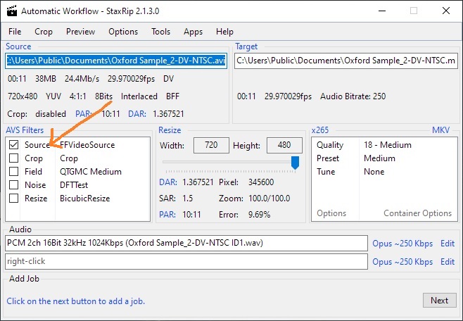

    DV avi can be opened if you set the source to FFVideosource

  12. Or, since you have CedoCida installed, use AVISource.
    That as it! I added AVI and DirectShow and it loads the files fine. I appreciate the advice!
