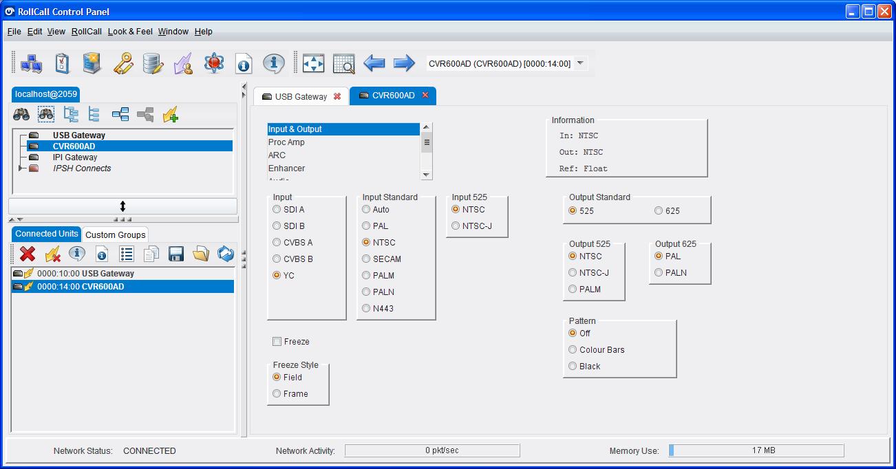

    Just figured out how to get the old RollTop and RollCall software for the Snell & Wilcox Timebase Frame Synchronizers to work.
    If anyone has a copy of the RollCall 3.x version I'd love to play with that too.
    But what I got working was RollTop1.6e.4 and RollCall Lite 4.12.
    The Converters 400D and 600AD are standalone, the 400 is video only, the 600 is audio and video, it has an audio delay module and an SDI audio embedder.. if you prefer to take the SDI output instead of using it as a pass-thru to another capture device.
    Both are the last to have the 4 Pin DIN connectors for S-Video Input and Output.
    So they are kind of unique, in that they were totally digital and used ADV chips for decoders and encoders.
    While I have been using them from the front control panel only, they have a series of momentary buttons to select and choose options and a single dial to manipulate digital settings in NVRAM.. that left a whole lot to be desired.
    The RollCall Control Panel software basically connects to the RollTop service monitoring and servicing the USB port connected to the CVR400 or CVR600
    From there you can then "pull" a list of controls and settings from the device into the Control Panel application and it autobuilds a more familiar windows dialog based control panel. Choosing menus and pressing buttons with a mouse makes changes in the device pretty much instantaneously.
    The idea is like a lot of high end hardware codecs or mixer/switchers.. once you set things up.. you can power it down and power it up on location and it remembers how it was setup and your good to go.. that is not what most people in a studio or home capture environment is used too.
    I don't think a detailed tutorial is all that necessary, this is rare gear and few people use it. But perhaps its helpful to know that it is possible and does work with a gui software.
    The RollCall 3.x software I think was licensed, so even if I had a copy to install I think I would need the license key to really play with that.
    The RollCall 4.x software had a "Lite" version which was freely available for download and did not require a License.. and thats what I found online.

    The TBS800 does not have USB, it uses an ethernet port which it should work based on your screenshot where it shows IP Gateway.

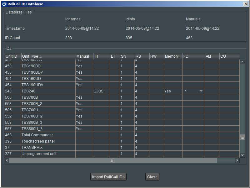

    I installed to Windows 7 x64 and then checked the ID database that comes along with the install, it looks like your model number is in there;

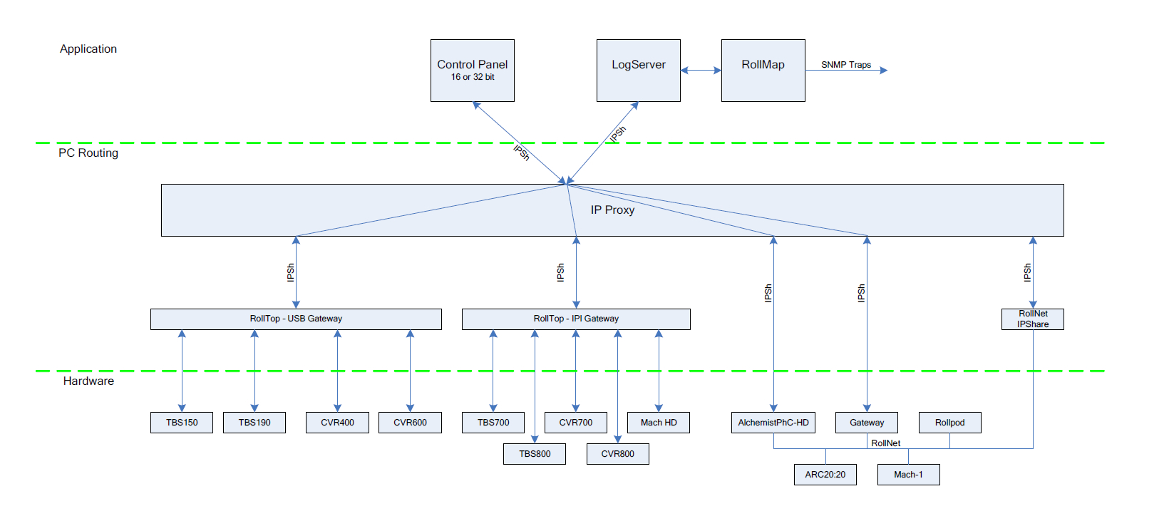

    Noticed a diagram in the "Kudos USP_IP Gateway Apps NoteV3.pdf"
    It seems to indicate the same "RollTop" service application must be installed and used to connect to the TBS800 using the Ethernet TCP/IP connection
    So its very very similar to the process that I went through with the USB, except with USB I simply configuired "Options.txt" and started the RollTop.exe service application, then started the RollCall and that connected to the RollTop service and discovered the available devices on that bus type.
    The bottom row of this diagram lists in "tiny" font, the actual model numbers of the TBC and Frame Sync devices, they get extended "funky" names only if they offer something beyond simple TBC and Frame Sync functions. For example ARC - Indicates "Aspect Ratio Correction" which basically means it can cross convert from 4:3 to 16:9 or Pillar or Letterbox, or some other odd Conversion function.
    I have only "understood" this jargon for a very short time, but its starting to fall into place and make sense.. it reminds me of 1999 CORBA programming, overdesigned a bit and therefore overly complex to understand.

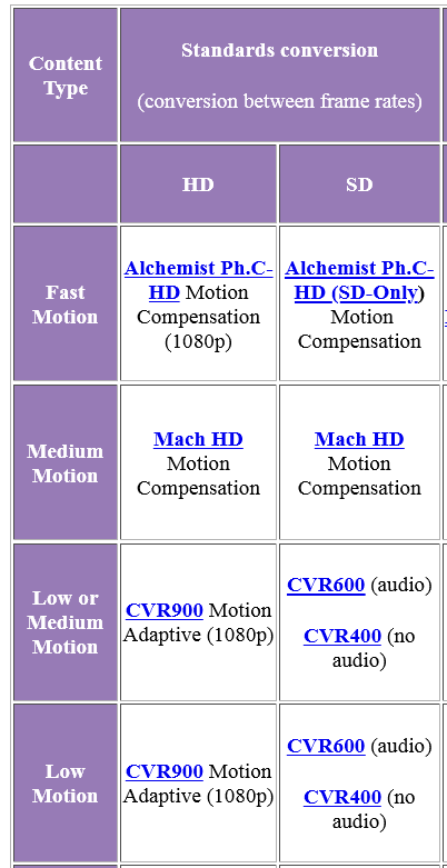

    These devices came at the time of transitioning from analog to digital in certain countries and HD and 16:9 programing are being made so all those functions did have a purpose, For just capturing analog tapes HD, ARC and format conversion must be kept off.
    Do you think the CVR600 have line TBC? I noticed that the TBS800 (CVR800 Grass Valley equivalent after the acquisition) has a very powerful line TBC based on my own tests on problematic tapes that the JVC VCR line TBC failed to fix, But there is no option to turn it off without turning off frame TBC function, though it doesn't seem to be invasive or degrade the quality further like changing chroma and luma levels.
    The Later BNC "only" versions specialized in HD/SD, the Earlier S-Video DIN versions targeted SD "only" VHS and Broadcast only, but from what technical documentation I read they honed in on VHS (they didn't say commercial VHS specifically, but they intimated "very bad" VHS signals) specifically. They weren't trying to be the "best" at everything but capture "widely varying, terrible signals" the later versions sharpened up their target market towards Broadcast signals only. I'm not knocking your TBS800 or CVR800 (I wish I had them to play with) but they are definitely designed to work with a better quality of signal.. and probably produce a better signal than the 400/600 by sacrificing what they will work with on the inputs.. certainly the BNC only inputs mean a lot more noise rejection.
    So its a double edge sword.
    It may fix widely varying time base problems and frame sync problems, no other device would even touch.. but the output signal will be merely "usable". In some cases stability is all you can hope for. My experience in the last year has been.. yeah they always "work" I can capture with some capture devices I couldn't touch with many other workflows.. but the picture still depends a lot on what was in the signal to begin with.. if it was grainy and I couldn't capture before.. I can capture now.. but the signal still has grain. (yes I do turn all the filters off to start)
    The controls over proc-amp are nice, but the extra features like audio and video delay controls are extremely rare, the choice of freerun or float also very rare, and the ability to chose what it does when frame corruption or input signal is lost; I have only seen on high end AJA frame syncs and expensive Grass Valley gear.
    The documentation just sucks terribly.. I mean its awful,, even reading tea leaves is easier.
    That they separate out the Chroma or DNR or Luma filters for individual on off or levels of strength are just not explained well. They are easily as complex as the pro-amp controls.. I think there were like Eleven different controls before you go to the ARC controls and those were massive as well.
    If you hate Analog Devices chips.. there ain't nothing I can do to convince you otherwise, a bias is a bias.. but to me these magic boxes are a frustrating source of puzzling fun.

    I did not mention they have extensive COMB Filter flows built in as well.. ridiculous depth of control.. which is what I think they use to classify "Motion" quality.
    I can't think of another reason to qualify their appropriateness for Motion speed.
    If your using S-Video or YPrPb (some models had YPrPb) then Motion Estimation is "of course" meaningless.. these are not compression codecs
