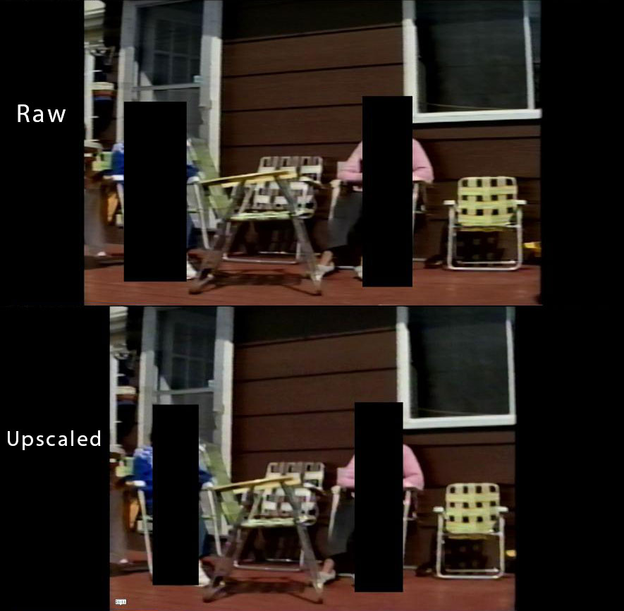

    This is the raw vs upscaled result (sorry for low res):
    [Attachment 67833 - Click to enlarge]
    The resized version looks squished horizontally compared to the original.
    When playing both videos side by side I think the de-interlaced and upscaled version looks amazing - it's just the wrong shape.
    I've been reading that it could do with pixel size differences and such but as much as that explanation makes sense I don't know what to "do" about it.
    Is there any way I can get the upscaled result to maintain the same aspect ratio as the original capture so it doesn't look squished?
  2. You're upscaled image shows the near correct 4:3 frame size. The raw video is showing the video at 3:2 -- the 720x480 (3:2) frame wasn't adjusted for the aspect ratio.
    The upscaled image is near-correct because analog caps should be cropped to 704x480 before upscaling to 1440x1080 (or any other 4:3 frame size).

    The original looks stretched because of incorrectly applied pixel aspect ratio of 1. Right click on a source video preview panel in VirtualDub and select pixel aspect ratio 10:11, and it will look just right.
    The resulting video may be just a little squished if you did not crop the original video from 720x480 to 704x480 before resizing.

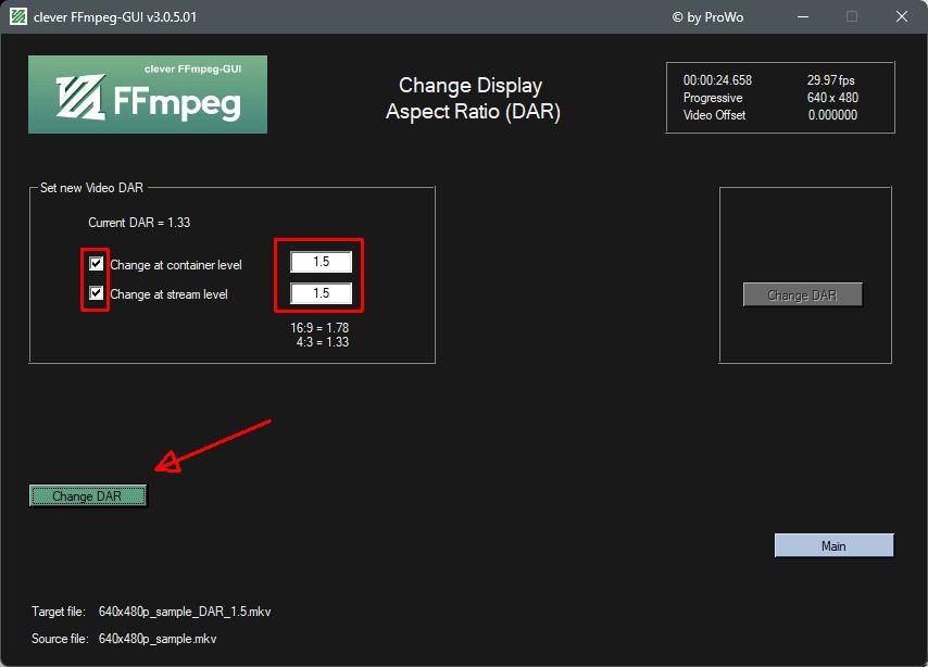

    If you still want to change it, then download clever-FFmpeg-GUI here: https://files.videohelp.com/u/292773/clever_ffmpeg_gui_newest_beta.zip
    Load your 1920x1440 video, click main, click Change DAR and enter the desired value in both fields (e.g. 1.5, same as your capture), check both options and click Convert DAR.
    [Attachment 67834 - Click to enlarge]
    Then look at your new video and see if you like it better.

    Easy way to check: use a ruler or tape measure on the processed image on your screen. It's 1.34 (close enough to 1.33333333 or 4:3, which is what it should be).
    Given my extensive knowledge of foldup chairs () the raw capture chair on the right does look a bit wide to me; the processed capture chair looks more natural.
