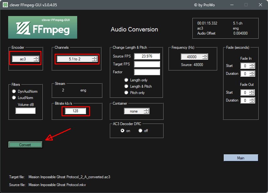

Use clever FFmpeg-GUI.
Load your ENG_FILM.mp4, click main, click convert Audiostream, select the AAC 5.1 Stream, click go to the encoder, then set all like in the picture below, signed in red. Leave all other settings as they are.
Click Convert. Done. In your target folder you'll find the new created AC3 file.
[Attachment 67796 - Click to enlarge]Last edited by ProWo; 24th Nov 2022 at 11:51.
