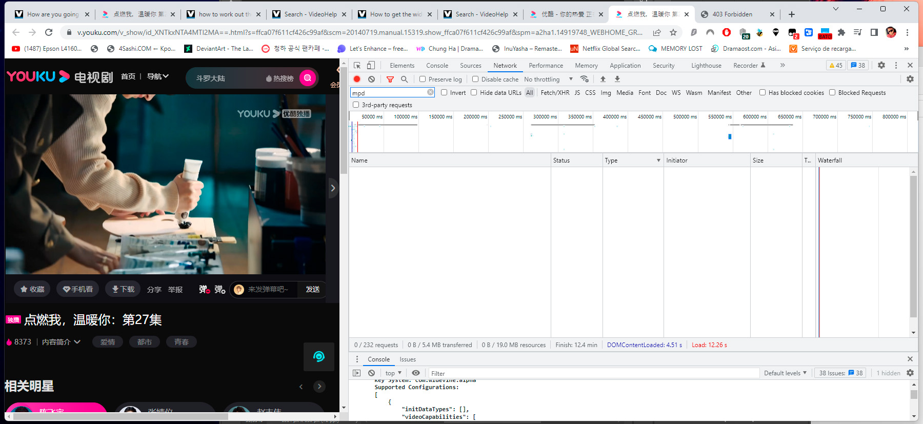

    Hello,
    I'm not able to find PSSH and m3u8 for the youku site.
    Link: https://v.youku.com/v_show/id_XNTkxNTA4MTI2MA==.html?spm=a2hbt.13141534.1_3.27&s=ffca0...f611cf426c99af
    I've already used EME Logger and I still didn't find it.
    Obs: I have the VIP

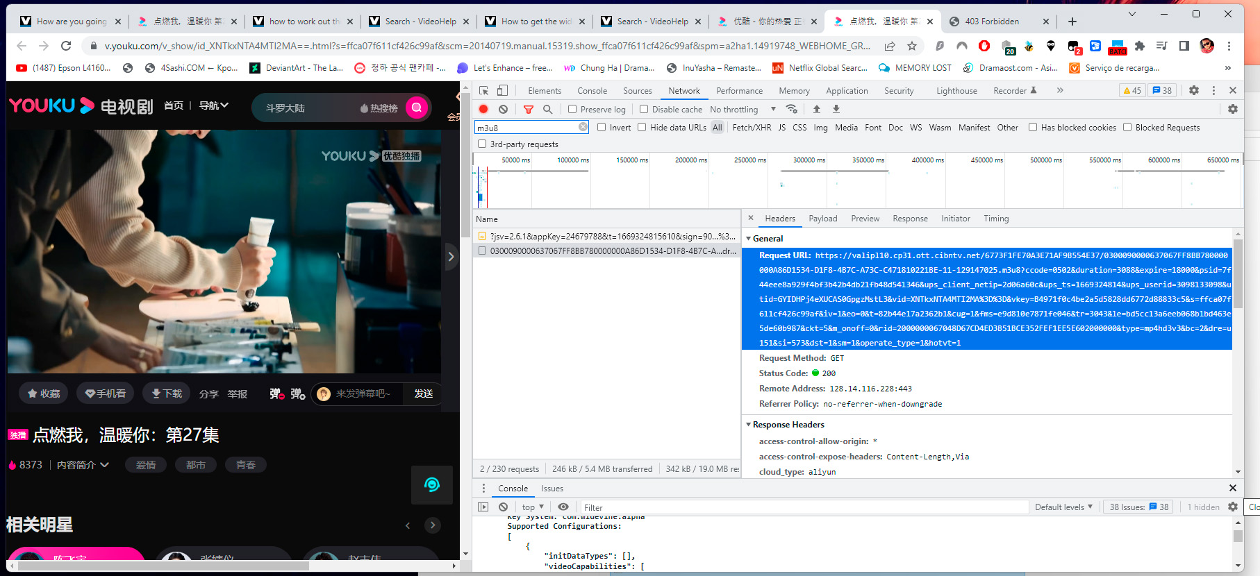

    Did not find anything in EME Logger:
    [Attachment 67797 - Click to enlarge]
    end it didn't find the .mpd file either
    [Attachment 67798 - Click to enlarge]
    This is m3u8 file
    [Attachment 67799 - Click to enlarge]
    The m3u8 I found already have the video file encrypted. Now I need to find the PSSH and the License Server, because I can't find it.
    Thanks to anyone who can help.

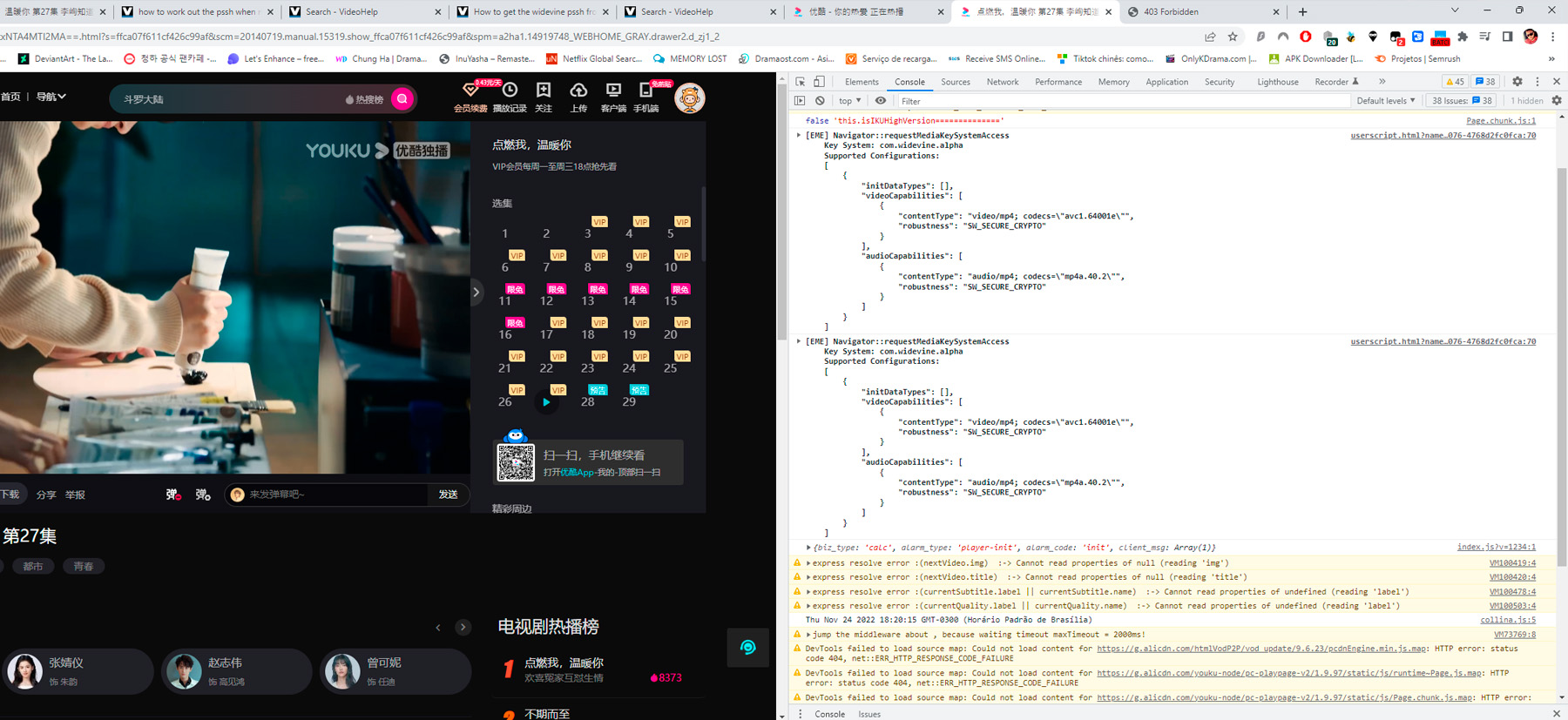

  7. you find pssh only with widevine drm (or micrsft play ready)
    your video not have wdv but another encryption
  8. nxhda
    Sep 2022
    youku self-developed
    Nov 2022
    Brazil
    Do you have any idea what it could be?
    Nov 2022
    Brazil
    Do you have any tips or ideas of what I need to try to break the encryption?
  11. Originally Posted by andertjf View Post
    dm me
  12. https://v.youku.tv/v_show/id_XNTk1ODg3ODQ5Ng==.html?spm=a2hja.14919748_WEBHOME_JINGXUA...b0dcd547f99f6a
    --key cea7835e4e70474799a4d8dee59e1763:8d6c2bb15a1a88b535dcc68737df00fb
    discord=notaghost9997
