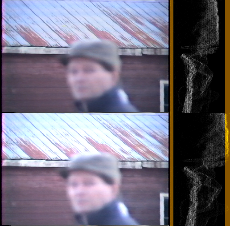

  3. After a head cleaning the new "noise" I saw has mostly disappeared so I'm curious to hear if the difference in colors between the two fields has improved:
    Clip 1 After Head Cleaning
    Clip 2 After Head Cleaning
    The AG1980P actually does a much better job on the areas of the tape where "sparkly noise" appears on the JVC capture - so I can definitely see why having multiple VCRs really helps for getting the best capture possible for all areas of a tape. Especially a tape like this one, where it switches back and forth from SP and EP recordings.

  5. I noticed that the levels of clip2 "After_Headcleaning" are different from before headcleaning. Some scenes are brighter, some are darker. This changes between the first half of the clip and the second half of the clip.
    Is there some fluctuating AGC or some autolevel feature in action? Was the VCR setting really the same before and after cleaning?
    (I didn't check clip1).
    Script to test:
    after=AVISource("Clip2_VDub_Huffyuv_HRS7500U_After_HeadCleaning.avi").histogram()
    before=AVISource("Clip2_VDub_Huffyuv_HRS7500U.avi").histogram().trim(2,0) #align the frames
    stackvertical(before,after)
    Example:
    Top picture=before headcleaning
    Bottom picture=after headcleaning
    [Attachment 67884 - Click to enlarge]
    Yes, the VCR setting was exactly the same as before - the only change performed was the head cleaning.
