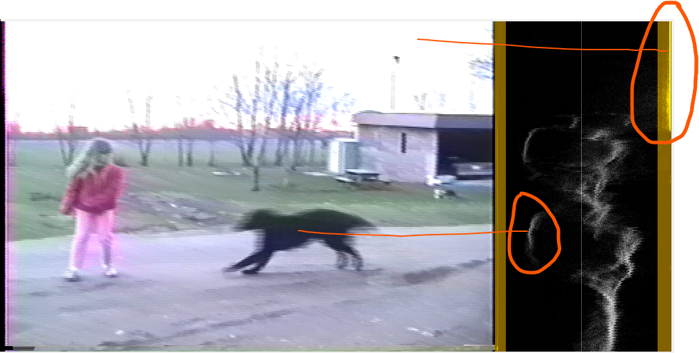

  12. The new avi capture from post#9 has blown out/clipped whites (masking details, like from trees in the bright sky) and elevated blacks (greyish). The luma should be in the 16....235 range.
    There are still ghosts and poor colors. Disable any filters from the chain when you re-capture, and keep an eye on the levels.
    [Attachment 67780 - Click to enlarge]
