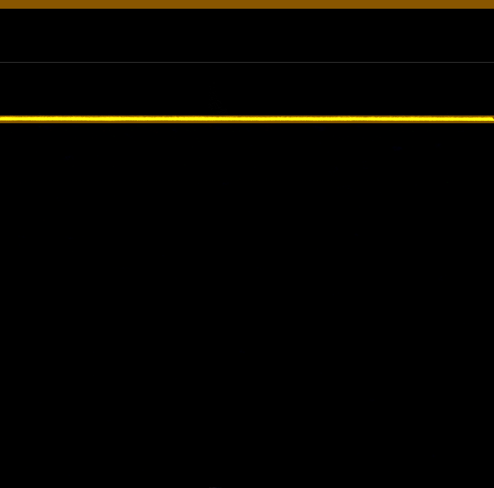

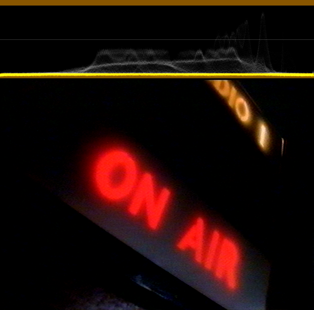

After levels adjustment

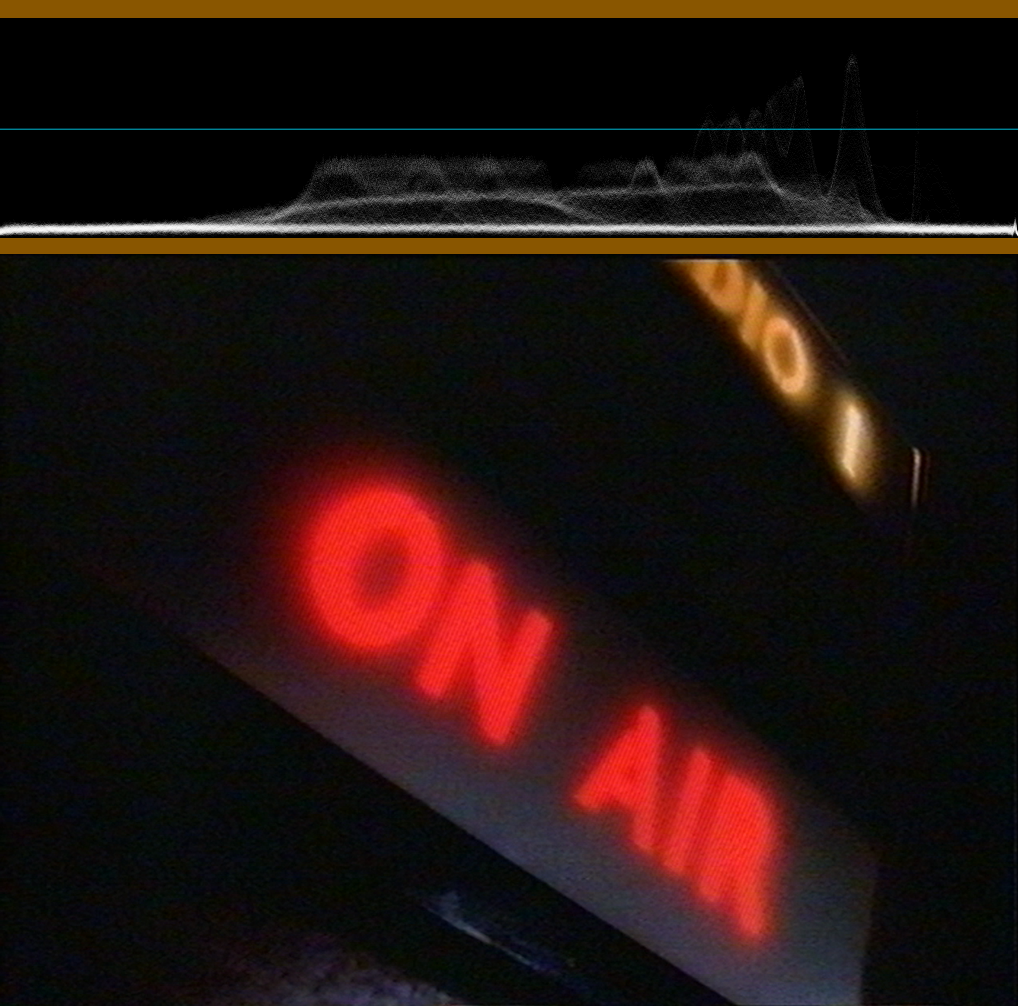

Before levels adjustment

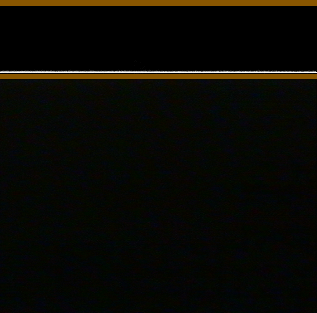

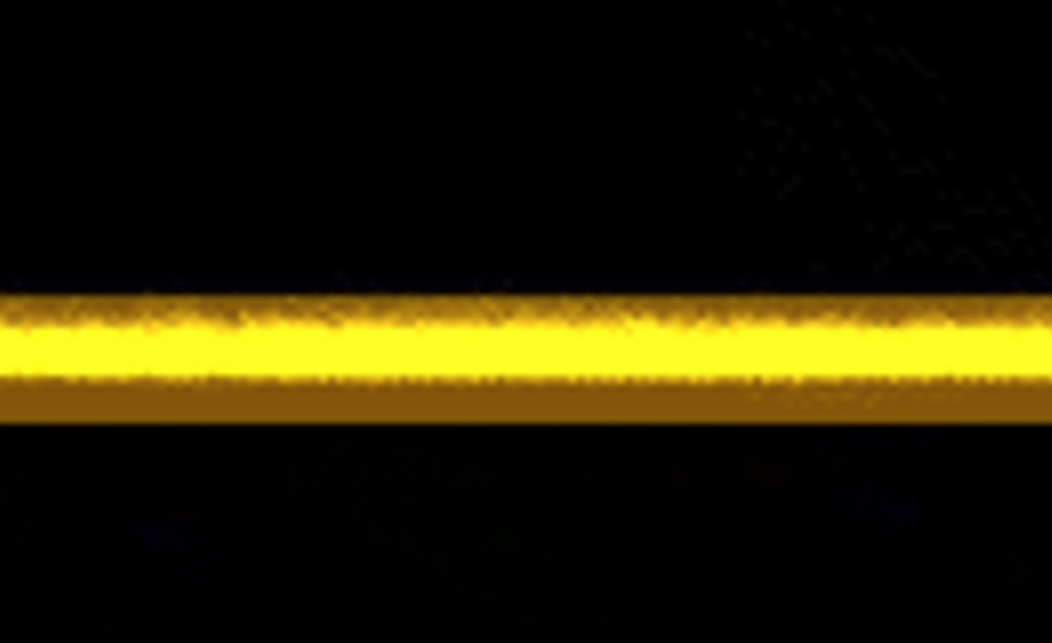

I notice the line hasn't gone flat, and there is jagged edges, does this mean no detail has been crushed?

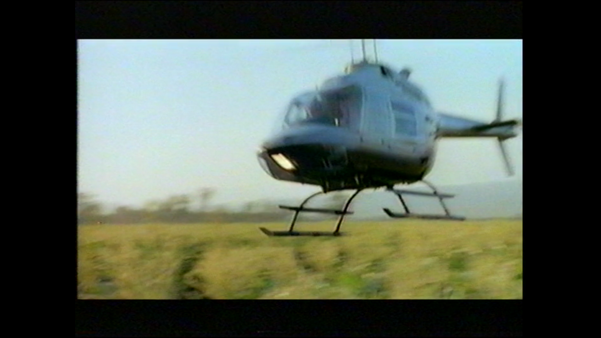

Thanks. Though i do want the blacks to be black, rather than slightly washed out.

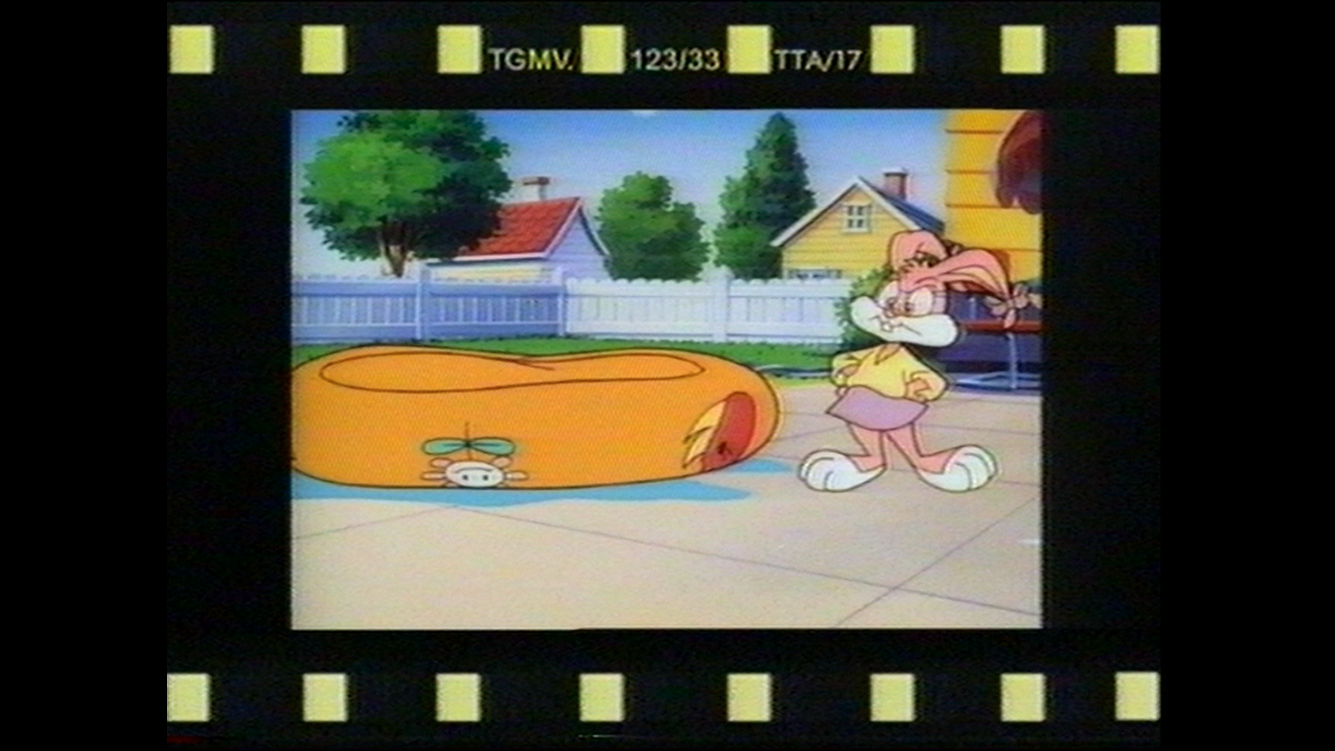

For example, this is a video playing in the media player.. is there anyway to get these black bars as dark as the pillarbox in the player? So getting it to black without removing the noise (detail) moreso for other darks in the video?
[Attachment 67766 - Click to enlarge]
[Attachment 67763 - Click to enlarge] -
In real analog video pure black does not exist because of the fluctuations caused by the noise. So if you don't want to loose any details by clipping you will have to find a compromise how to set the "black" level of the dark scenes or dark parts of the picture, and/or you can try to denoise as far as reasonable.
For the second example you know that the bars should be pure black without any details. Hence you can simply substitute the captured bars by synthesized bars, like
For the first example you could try to build a mask which leaves the yellow squares on the top an bottom alone and set the rest of the borders to black.Code:AVISource("Original File.avi") crop(6,68,-6,-68) addborders(6,68,6,68)Last edited by Sharc; 23rd Nov 2022 at 02:20.
