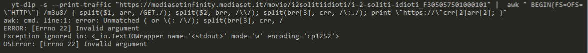

  7. thanks jack but i have an error:
    [Attachment 67648 - Click to enlarge]
    however i don't understand how yt-dlp find m3u8 link .... i can't find it in dev tool anywhere ...
  8. replace split(brr[3], crr, /:./) with split(brr[3], crr, /\:./)

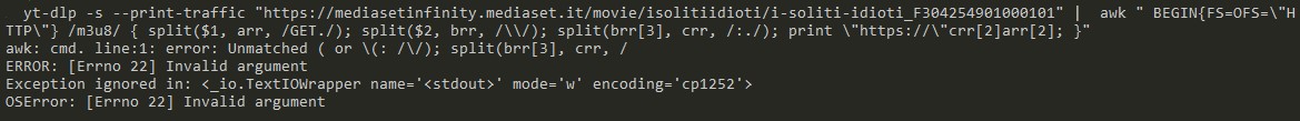

  9. jack my final code is that:
    yt-dlp -s --print-traffic "https://mediasetinfinity.mediaset.it/movie/i2solitiidioti/i-2-soliti-idioti_F305057501000101" |  awk " BEGIN{FS=OFS=\"HTTP\"} /m3u8/ { split($1, arr, /GET./); split($2, brr, /\\/); split(brr[3], crr, /\:./); print \"https://\"crr[2]arr[2]; }"
    but have the same previous error:
    [Attachment 67655 - Click to enlarge]
  10. I copied and pasted your code at my end and it worked fine.
    Suggest you break the code into small pieces and debug.
  11. wired
    for me work fine yt-dlp -s --print-traffic "url"
    but your code give me an error (and it work for you ...!??)
    how to solve this? your code help me also for other situation

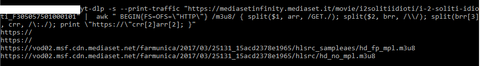

  12. jacks code worked for me with awk version 3.1.6 but it doesnt work with awk version 5.0.0.
    try this
    yt-dlp -s --print-traffic "https://mediasetinfinity.mediaset.it/movie/i2solitiidioti/i-2-soliti-idioti_F305057501000101" | awk " BEGIN{FS=OFS=\"HTTP\"} /\.m3u8/ { split($1, arr, /GET./); split($2, brr, /\\\\/); split(brr[3], crr, /:./); print \"https://\"crr[2]arr[2]; }"
    https://vod02.msf.cdn.mediaset.net/farmunica/2017/03/25131_15acd2378e1965/hlsrc_sampleaes/hd_fp_mpl.m3u8
    https://vod02.msf.cdn.mediaset.net/farmunica/2017/03/25131_15acd2378e1965/hlsrc/hd_no_mpl.m3u8

  13. wow ElCap, your last code work great!
    thank you so much for your post
    and thank you also to jack_666 for the original code
