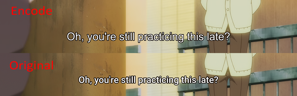

This is the syntax i use:
However, in the result the subtitle font and size change:Code:-c:v libx265 -crf:v 24 -tune:v animation -x265-params "aq-mode=3:aq-strength=0.65:bframes=4:keyint=240:min-keyint=24"
It's the same scene but the subs on the encoded video are a different font that is more slender and the size is bigger.
How can i change the syntax so i keep the exact same subtitle style, font and size when encoding files to x265?
Actually, FFMPEG rarely keeps my subs style when encoding a video, how can i tell FFMPEG to keep the EXACT same style in the result?

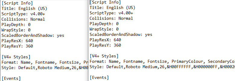

This has nothing to do with the encoder.
Your subtitle seems to be an ass subtitle.
If you open it with a text editor, you will find the resolution at the top (e.g. 1280x720).
Check if this is the same as the resolution of your movie. -
It is the same:

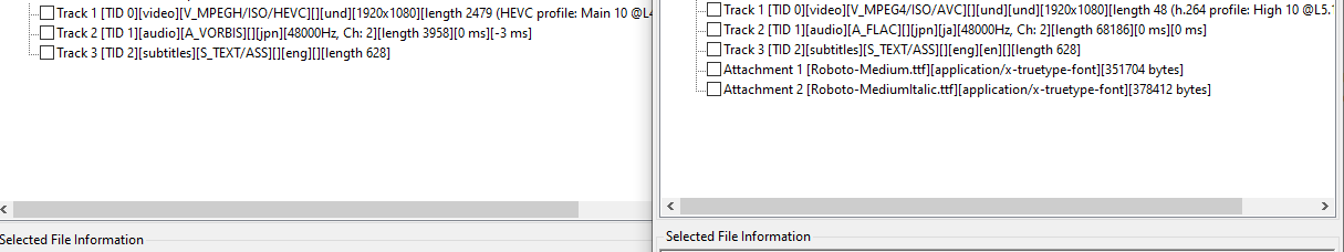

I noticed when used mkvextract that the NOT-encoded video had attachments related to the subtitles, while the encoded video had none, i think that FFMPEG just ignores/removes the attachments causing a different result in the subs style:
The Roboto-Medium TFF Font isn't installed on your computer.
So it must be added to the videofile or installed on your Windows System. -
Remux your source video with the new created hevc videostream, deselecting the old one, with MkvToolNix.
If you need mp4, you could try to remux the created mkv to mp4 with clever FFmpeg-GUI.
