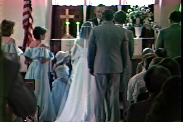

  1. I am currently in the process of trying to cleanup my parents wedding tape for my mom. I have had several cracks at tidying this up. Originally I transferred it using a JVC HR-S 9911U, but it always had tracking issues. Since the purchase of a Panasonic 1980p I finally have a mostly clean transfer. The VHS while only being 50 minutes long is in EP format for God knows what reason. I really enjoy playing around with different plugins in avisynth but I am not an expert at video restoration by any means and could use some advice. I have almost no knowledge of how to fix color issues, I believe the problems I'm seeing could be tape decay? It is noticeable in the lighting such as a flame being green instead of white. Also, my biggest issue is even after using QTGMC to deinterlace the video there are faint horizontal black lines every other line all the way down the image. Wherever these lines are when they get to the edge of whatever they passthrough they seems to give an aliased look to the edge of the object. I can dehalo these out of the picture but it destroys the image it just becomes a blurry mess. I have never found a way to get rid of them and keep any clarity. I use Topaz Video Enhance AI as a resolution bump not crazy but 720x480 to 1280x720. I've had it work really well but it locks onto the horizontal lines and makes way worse the algorithms they are using don't handle it well at all. I've attached a completely untouched clip and one after QTGMC Slow preset. Any help with color and those lines or even just what exactly I'm seeing terminology wise would be great. That's why some stuff is hard I don't know how to properly name what I'm seeing to even search for a plugin to help.
  2. This, before QTGMC, will get rid of the horizontal lines:
    SeparateFields().vInverse().Weave()
    Colors are tougher...

  5. A simple RGB white balance, luma gain/offset, saturation. Followed by deinterlace and noise reduction:
    LWLibavVideoSource("Untouched.avi")
    AssumeTFF()
    ConvertToRGB(interlaced=true, matrix="rec601")
    RGBAdjust(r=144.0/95.0, b=144.0/134.0)
    ConvertToYV12(interlaced=true, matrix="rec601")
    ColorYUV(gain_y=100, off_y=-8, cont_u=100, cont_v=100)
    QTGMC(preset="slow")
    SMDegrain (tr=3, thSAD=1000, refinemotion=true, contrasharp=false, PreFilter=4, mode=0, truemotion=true, plane=4, chroma=false)
    [Attachment 67510 - Click to enlarge]
    Not great but not too bad.
  6. Thanks so much for the advice it's helped a ton. The picture is great and color much improved. I can't thank you all enough for taking the time.
