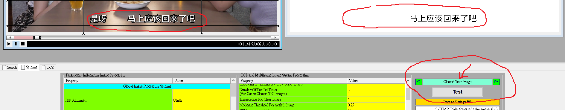

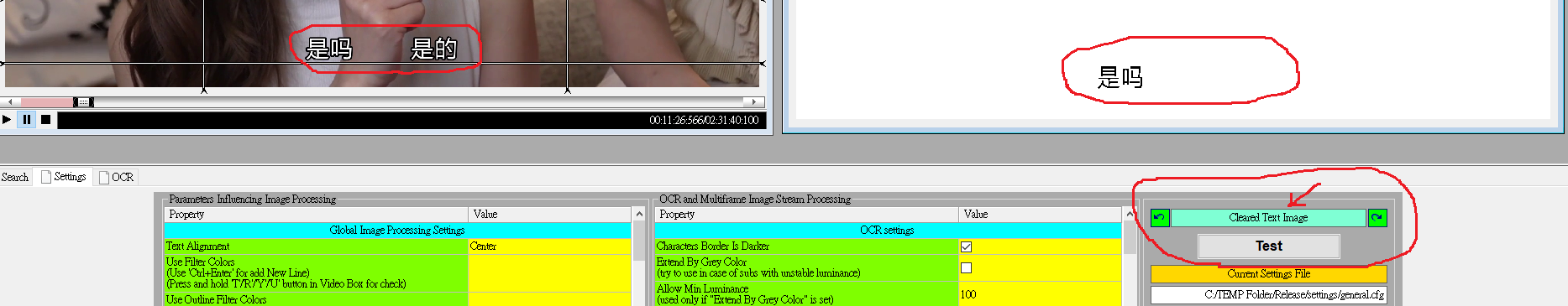

I use VideoSubFinder and have the problem when I try to create a Cleared TXTImage. The second sentence in subtitle will be missed if the space/blank between the first and the second sentences is too big. Please see these two pictures!
Could you please tell me how to adjust the setting in order to sove this problem! Thank you so much!
[Attachment 67448 - Click to enlarge]
[Attachment 67449 - Click to enlarge]

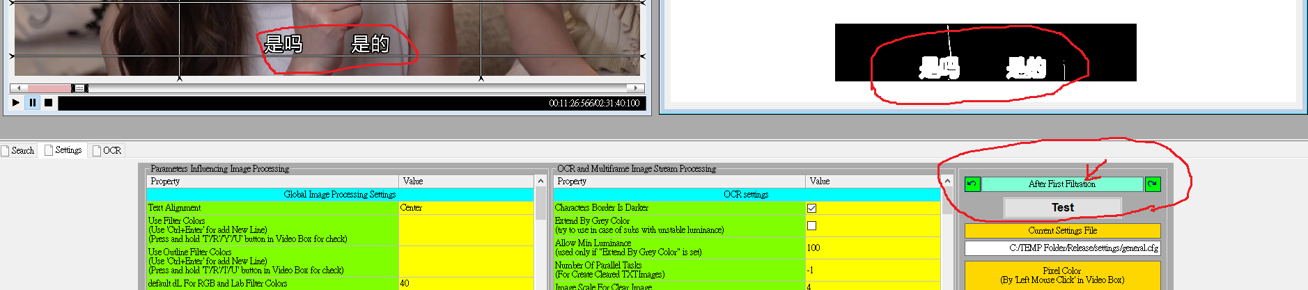

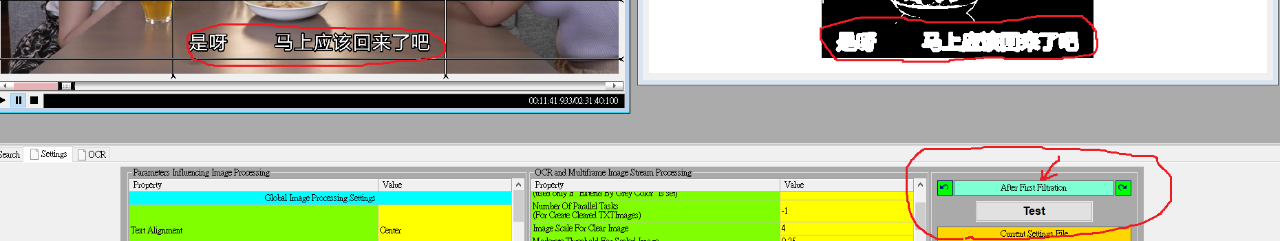

	Thank you for your suggestions. Unfortunately, it did not solve my problem. I would like to further specify my problem. This subtitle omission issue only happened when the blank/space between two phrases was too large. More specifically, this issue happened when the sub-title was transferred from RGB image to TXT image. When this issue happened, the software would automatically select the first phrase as the sub-title if both phrases were in the same length. Furthermore, the software will select the longer phrase as the subtitle if these two phrases had different lengths.
 Please let me know if you have any suggestions to fix this issue.
 [Attachment 67470 - Click to enlarge]
 [Attachment 67471 - Click to enlarge]
 [Attachment 67472 - Click to enlarge]
 [Attachment 67473 - Click to enlarge]

	Set Max Between Text Distance to 0.2.
