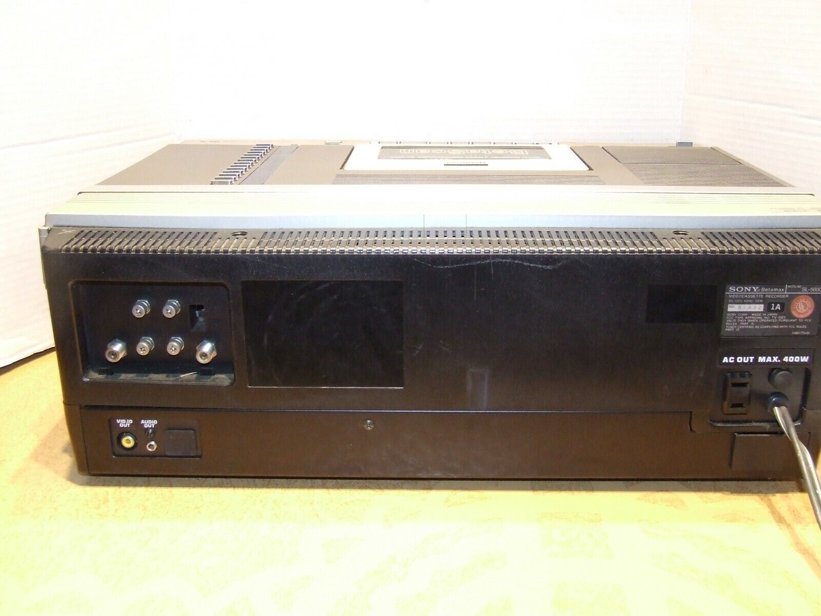

    The pic above is the back of the SL-5600. It's composite RCA and 1/8" / 3.5mm mono.

  12. The picture I took is not very good; my machine is the same one as in the picture above.

    On post#2 johnsO stated you'd need a 1/8" to RCA converter plug for the audio, and was correct.
    Then on post #3 lingyi reiterated the 1/8" audio to RCA is what would be needed and even posted a photo of the back of your model machine.
