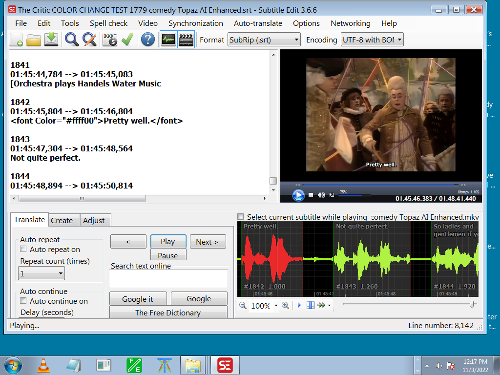

  7. I did a test of the code in SE plain text window accessed with F2. I ran the line, then made a screen shot.
    I expected the player in SE to pick up the code. The relevant line is 182. I did not get a color change.
    The only thing I can think of to get the color going would be to Save-As ASS or whatever and attempt to run it
    again.

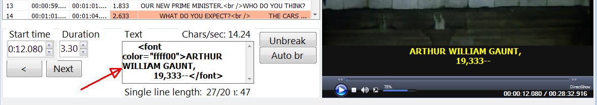

    I typed the HTML in here and it came up yellow as soon as I typed in </font>
    No problems here.

          <font color="ffff00">ARTHUR WILLIAM GAUNT,
                19,333--</font>

    My only thought is you're changing the .srt file but the window on the right is displaying embedded subtitles in the video.
    Easy to check. Change line 182 "Pretty well" dialogue to "Pretty unwell" and see what you get in the video.

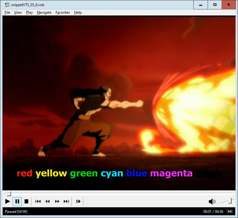

  11. Beware that not all players will respond to HTML color tags in SRT files.
    0
    00:00:00,500 --> 00:00:05,000
    <font color="#ff0000">red</font> <font color="#ffff00">yellow</font> <font color="#00ff00">green</font> <font color="#00ffff">cyan</font> <font color="#0000ff">blue</font> <font color="#ff00ff">magenta</font> <font color="#010101">black</font>
    [Attachment 67455 - Click to enlarge]

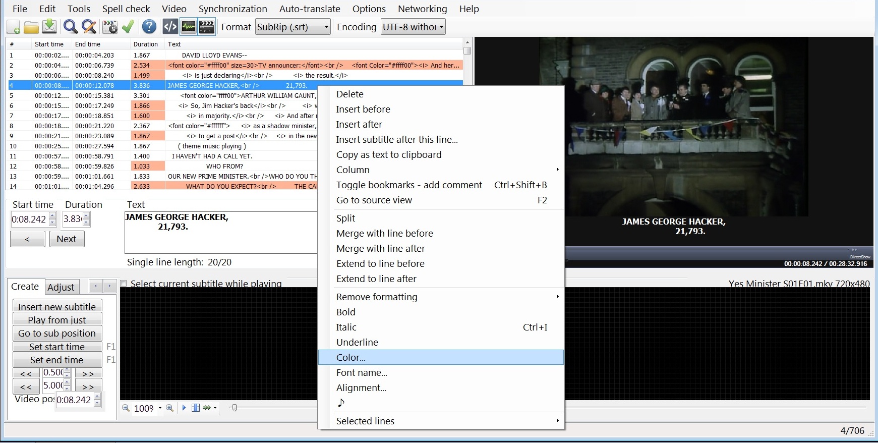

    The option is there to right click on a line / select Color and then click on 'Yellow', one of the SE default colors.

  16. Success. I got the color change. So many program elements, I missed it.
    Thanks to all who helped.
