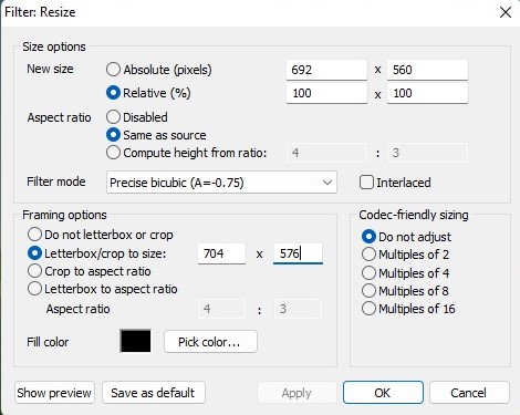

    I would just (no resize, "original" post-processed pixels)
    - crop unwanted borders, addborders to build 704x576 frame, encode with DAR = 4:3
    or
    - crop unwanted borders, addborders to build 704x576 frame, "quality" upscale to 1440x1080, encode with DAR = 4:3
    But that's me

    [Attachment 69333 - Click to enlarge]
    [Attachment 69334 - Click to enlarge]
    And then encode to mp4.
